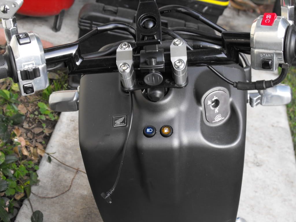

and here it is now right after finishing my handlebarsImagei havent cut the rabbit ears off yet, maybe tomorrow.Image

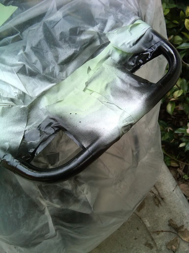

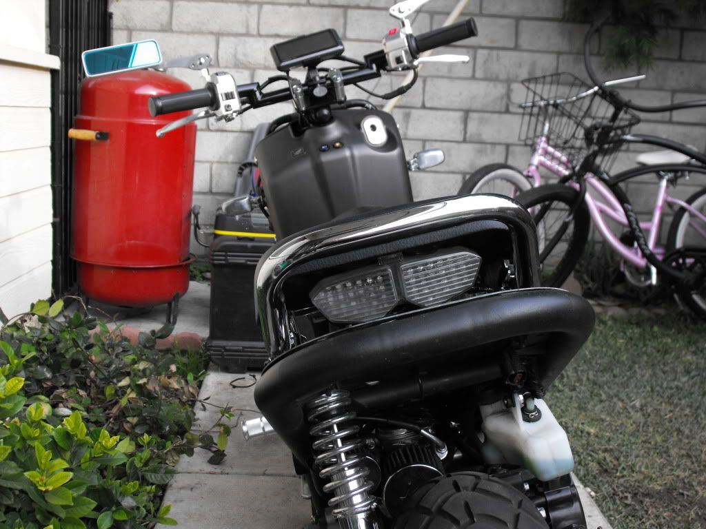

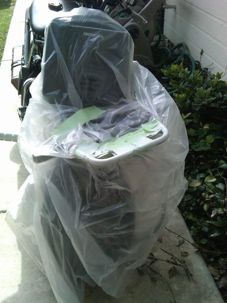

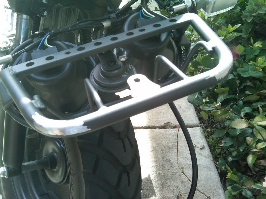

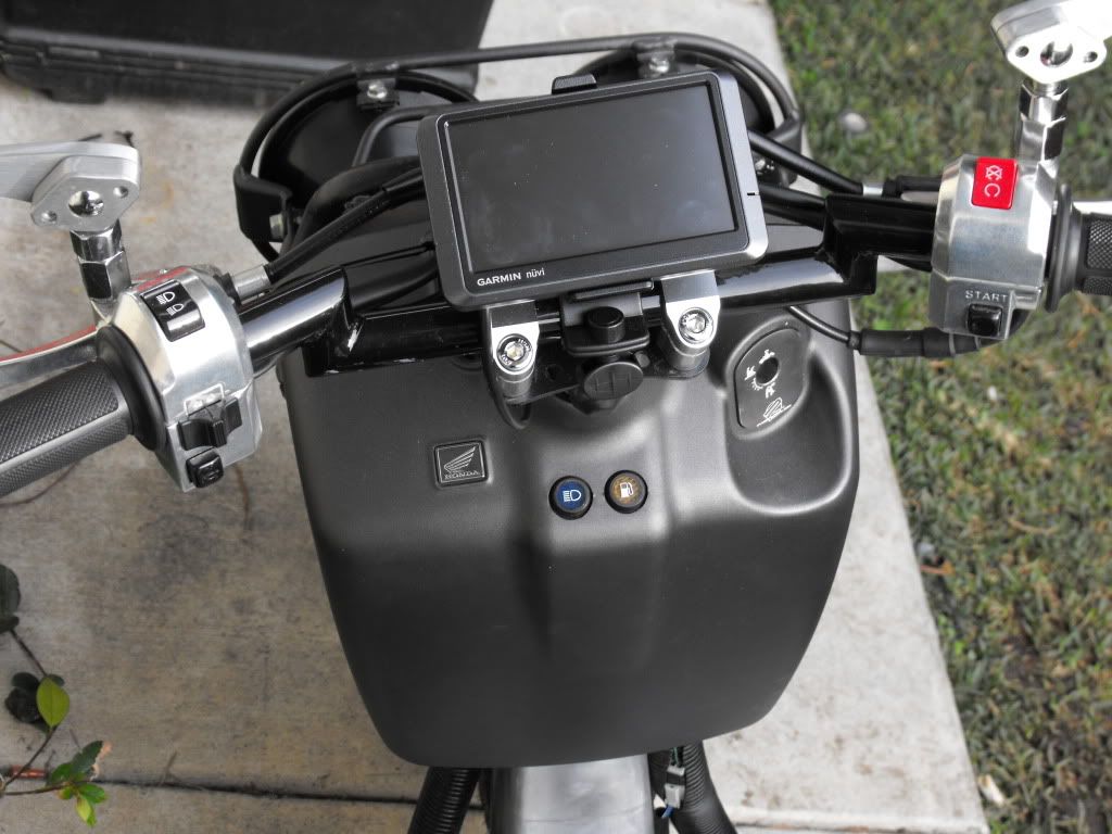

sanded off rabbit earsImagelittle primerImagelittle paint (wrong color of course)Imagenot great but only temporaryImagehard wired a female cig lighter to the accessory light from the stock speedo, plugged in the car charger for the garmin, works great. turn off the key, garmin powers offImagefinally got my garmin mount from hong kong mounted to my mini z bars from ruckstersImageheres the taillight i got from Ratchett, love it. So whats next is my motor swap from Rucksters with a 12'' fatty mounted with the atr mount. I cant wait!

where did you get that gps mount????
i want one
i want one
They're all over ebay just don't buy from a company called ebest. Mine took about three weeks to come. :pissed:

dude, you shaved off the rabbit ears but left the horn location stock? put that mother in the BB, there is an unused bracket that will allow you to put horn inside, then shave that bracket too. i have same color trim and have found that rustoleum 7250 black night metallic is as close as you can get to factory color.
keep up the good work!
