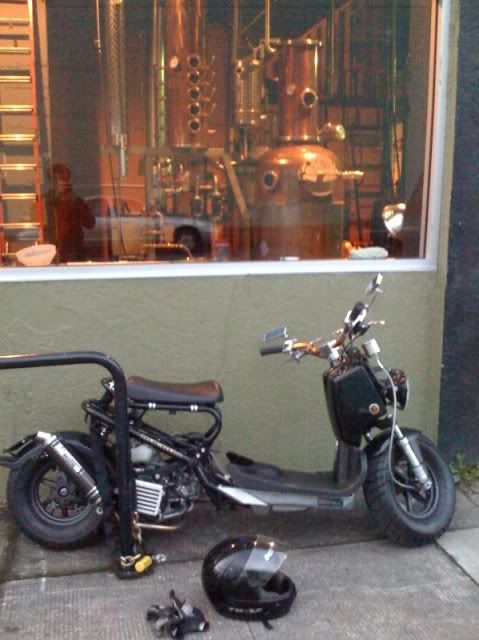

ENGINE
Motor mods: 58.1cc
Lightened Flyhweel: yes
HO Cam: no
PC/JC20 Carb (yes/no): yes
Brand of (carb keihin / sheng wey): SW
main jet: 82
slow jet: 35
needle setting: lowest
Which filter on carb: K&N Covered
Exhaust: JDM Yoshimura CF
Transmission
Variator: Polini
Roller weights and brand: 6.0gm OEM Honda Metropolitan
Clutch springs (blue or pink): blue
Gear Kit: stock
Other
cdi: Posh unlimited
hitting rev limit (yes / no): N/A
Wheel
Rear Wheel size: 10" Gunmetal DIO
Rear Tire size: 130
PSI: 32 psi
Tire Brand: Pirelli SL26
Environment Factor
Elevation: 0-500ft
Temperature at time of test: Cold
Weight: 175 lbs
Top Speed Flats (no wind): unknown (generally hit 65 km/hr easily)
Top Speed downhill (no wind): unknown (68 km/hr)

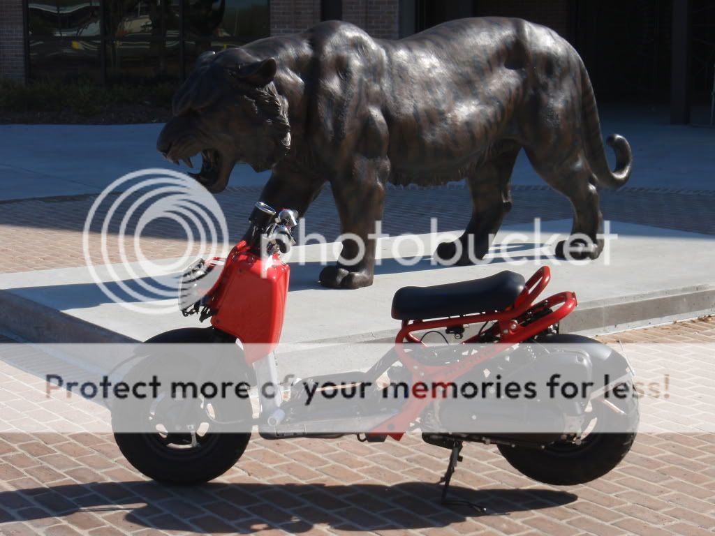

ENGINE
Motor mods: 58.1cc
Lightened Flyhweel: yes, jc
HO Cam: yes, jc
PC/JC20 Carb (yes/no): yes, jc
Brand of (carb keihin / sheng wey): dunno
main jet: 85
slow jet: 38
needle setting: richest
Which filter on carb: one that comes with jc20
Exhaust: stock
Transmission
Variator: polini
Roller weights and brand: 3 6g weights, 3 stock
Clutch springs (blue or pink): none
Gear Kit: yes, met final gear
Other
cdi: kitaco cdi? I think that's what it's called.... plug and play, totally worth it
hitting rev limit (yes / no): don't think so (hard to tell with stock exhaust)
Wheel
Rear Wheel size: stock
Rear Tire size: stock
PSI: dunno
Tire Brand: stock
Environment Factor
Elevation: sea level
Temperature at time of test: 71 F
Weight: 172lbs
Top Speed Flats (no wind): ~50mph (no exact gps verification, although the one time I used my gps I got it to 48, and I've tunned it since and it feels much faster now)
Top Speed downhill (no wind): no hills (louisiana)
Will be changing the variator setup soon (got some weights coming in the mail soon), so I'll update as soon as I've tested out different weight combo's :banger:
