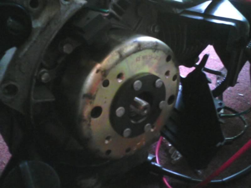

Pics! Here is my flywheel, center nut removed.

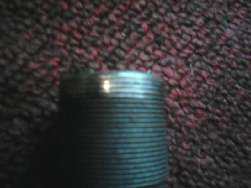

Here is the flywheel puller tool. Put the larger piece in as far as I could, then tightened the center stud. The center stud pushes on the piece behind the flywheel, pushing the larger piece of the tool and flywheel off the backing. Like I said, I threaded it til it wouldn't go any farther (with tools, not hand) and when I tightened the stud, the whole piece ripped out damaging threads. Tried this a few times......

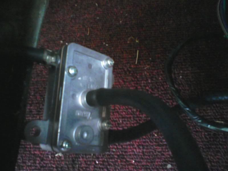

Here's my vacuum pump. Fuel in and out in the right places, vacuum in the middle is run to the intake manifold (also tried crankcase as one person suggested on another thread)

That's weird how it stripped the flywheel puller tool if it was threaded that much already. You were doing it right but I don't know what stopping your flywheel to come off and stripping your flywheel tool. It should come off easily once you turn the inner stud of the tool. Maybe try to borrow another tool with new threads.

By chance is the motor from a Roketta? If so break out the torch and heat up the flywheel as best you can and pray it doesn't ruin the crank.

Yeah, it's a Roketa. I don't have a torch. Is that my only option for getting it off? I wailed on it for a few minutes with a mallet and not much happened.

I dont know about the flywheel, but it sounds like to me your carb isnt getting enough fuel. One potential problem could be if the vacuum line may be too large. You want the smallest one you can cram on there. The other could be your float valve sticking. Try sucking on the vacuum line with the bowl removed and see if the float valve is allowing fuel to pass.

So maybe it's the kink in the hose I attached, but no more fuel spurting out, and I took the bike haphazardly up and down my neighborhood street! Time to double check bolts, route wires and hoses, and reassemble! Not hard to get to the flywheel, so I can swap that when my buddy brings his torch.
