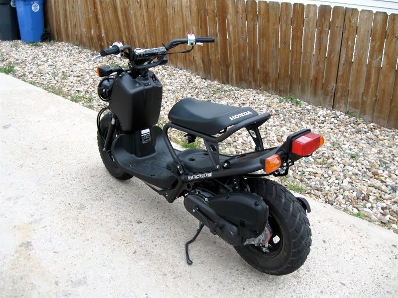

Sept 2008 i bought my '09 Ruckus. The first "new" vehicle I have ever purchased. I was saving money in a jar for a while and paid in cash. I literally just brought my stash of cash to pay for the scooter. It was like a 10min process of me counting all the money($2500 is 20s, 10s, and even some 5s lol) and then the sales manager recounting all the bills. haha
I removed the mirrors and reflectors before it even came out of the back of the pickup. As soon as it hit the ground the front and rear fenders came off. The next morning I cut off the little plate bracket in the back.

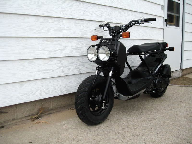

Here is how it looked:
I threw a bar pad and a few stickers on:

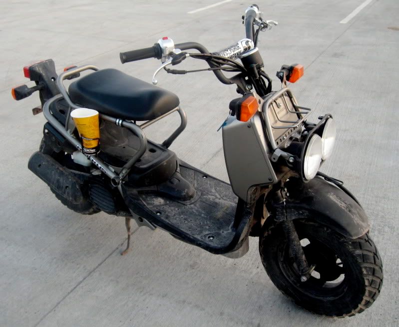

A few weeks later, I bought a used Grey '08 ruckus with 1500 miles on it:

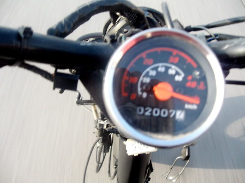

I also moved the speedo to the battery box:

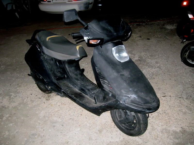

A few months after I bought the '86 I picked up this gem:
An '87 that runs like a top, but has a bent front fork and wheel. I rode it around a little bit, but it mostly just sits for now. :(

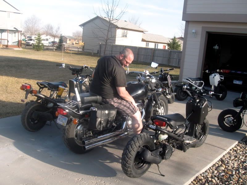

A pic of my growing scooter family:
by this time the spree was completely dead. you can barely see it off to the right. How sad. :cry:

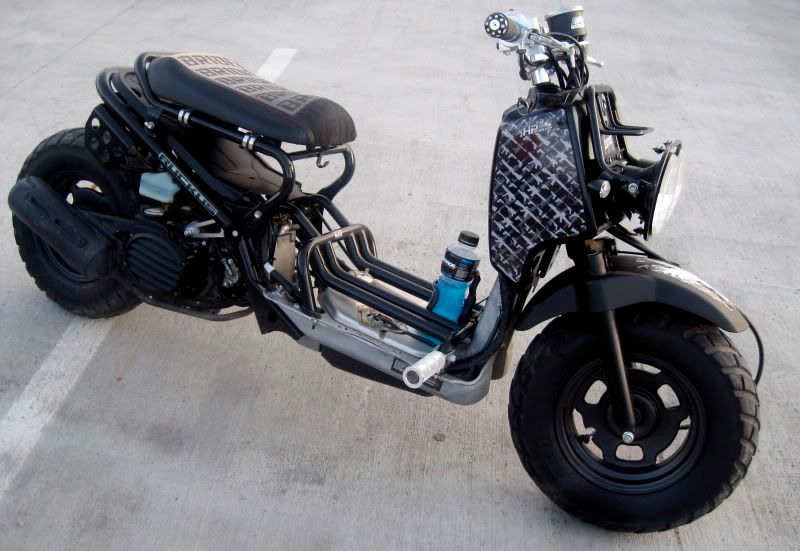

Coming soon:
DIY 10" extension
DIY drag bar aka chin bone
DIY $48 Fatty
DIY slammed front forks
DIY exhaust

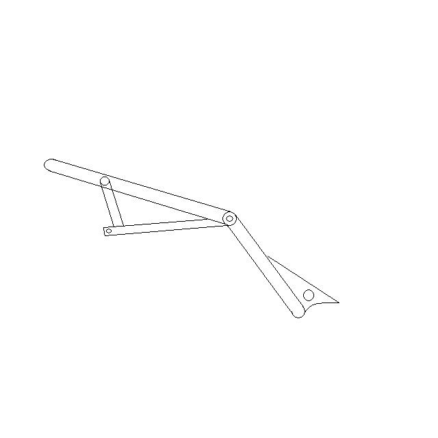

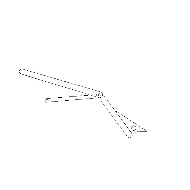

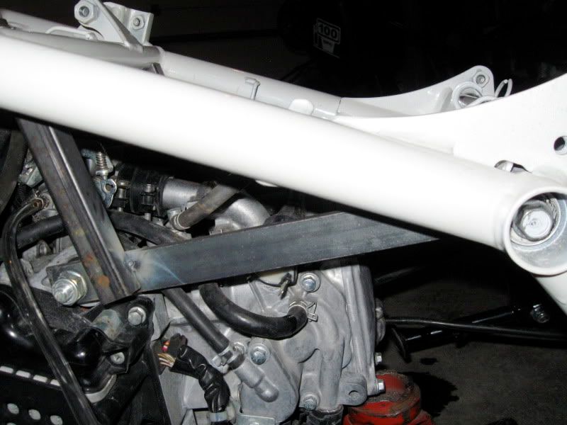

DIY EXTENSION:
We have done this slightly different both times we did it.
I used angled steel for my extension, while we just used strap for Kris', but the process is pretty much the same.
I only took a few pics while doing these, so I made a few drawings. haha

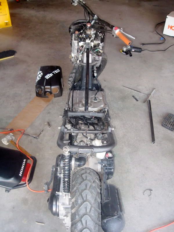

First rip your scoot apart:
^LOL
Here is my drawing of the rear frame:
lol

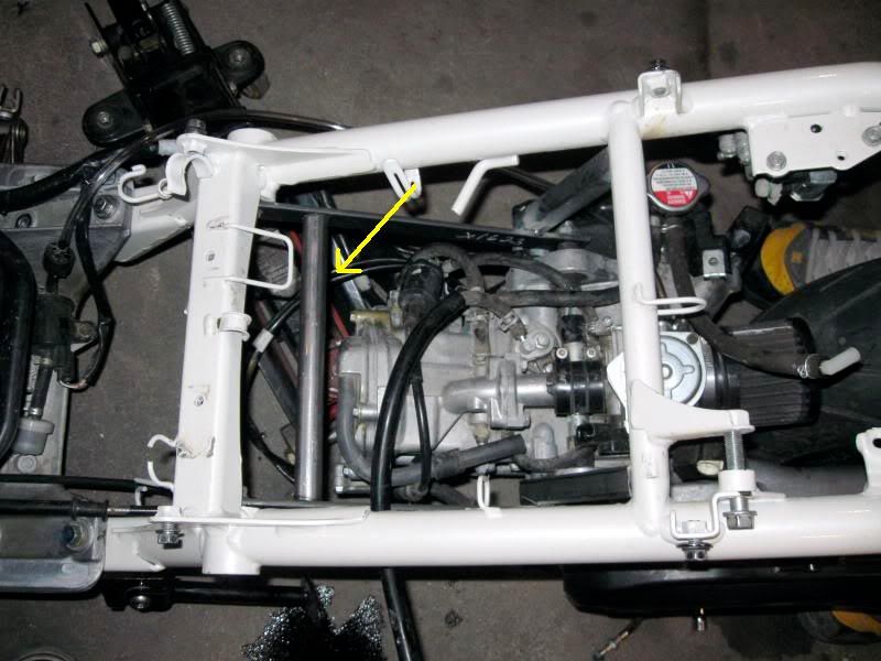

Determine how long you want your extension to be, cut two pieces of angled or strap steel, and drill a hole in both ends.
Then you bolt one end of each to your scooters stock engine mounting location:
bolt the other end to your engine, determine what height you want, and then measure the distance from the top of your extension to horizontal bar that your coolant tank hangs from.(you will have to grind the coolant mount tab off and relocate your tank).
Then simply cut two pieces of square tubing to the correct lengths, fish mouth the ends, and weld them in place. Make sure to do some measuring before you weld. Make sure your rear tire is centered!
Here is an illustration of what it should look like. I drew in the horizontal bar, so you could visualize it. :)
So it should look something like this:
Also, its a good idea to put a cross brace in here:
This is a VERY simple process if you have access to a welder, you can literally stretch it as far as you want, and it is dirt cheap to do. :banger:

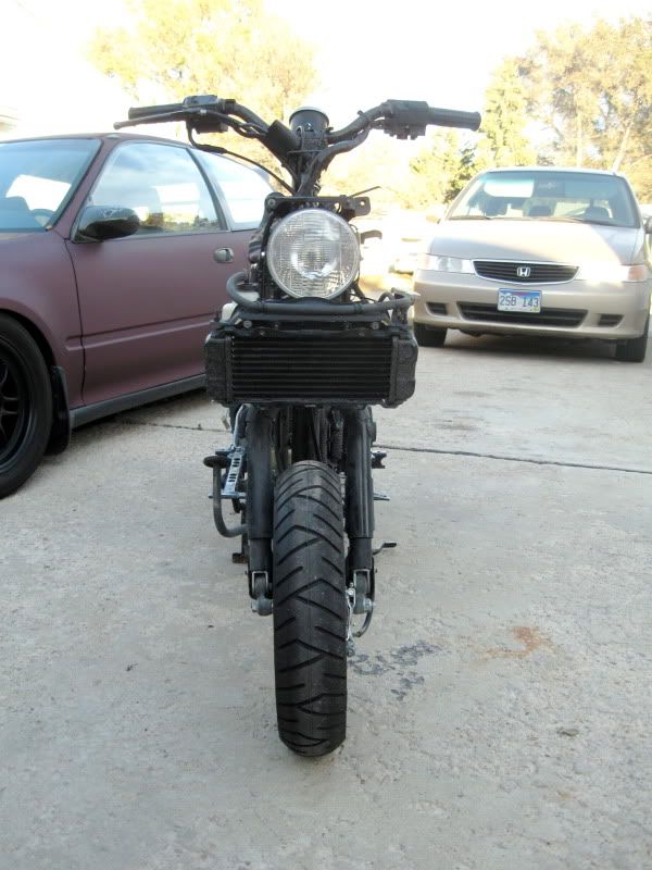

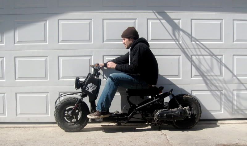

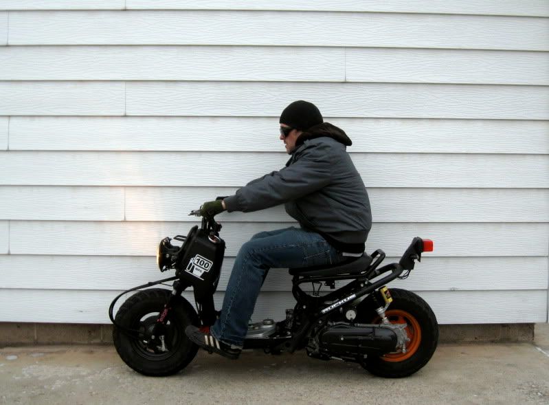

I put a 10" extension on my scooter. Since my handlebars are lowered, I did not need longer brake or throttle cable. The only thing I bought was a longer fuel line.
Here are some before and after pics of my ruck with my ass on it:
Before-
After-
Also if you notice, my front cables are all F'd up.
I had my Ruck parked in the mud room. The front cables, front fender, and all 4 blinkers went into this guys tummy:
Thanks alot Turk! :pissed:
haha

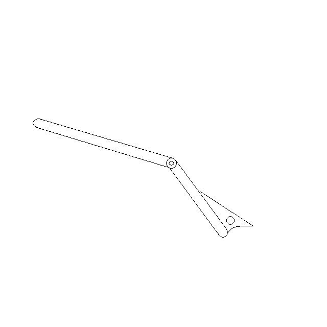

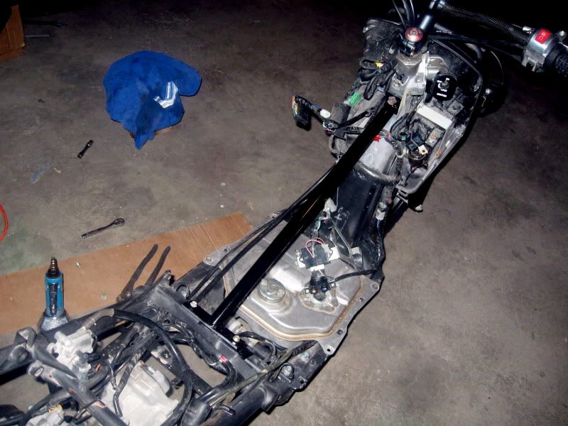

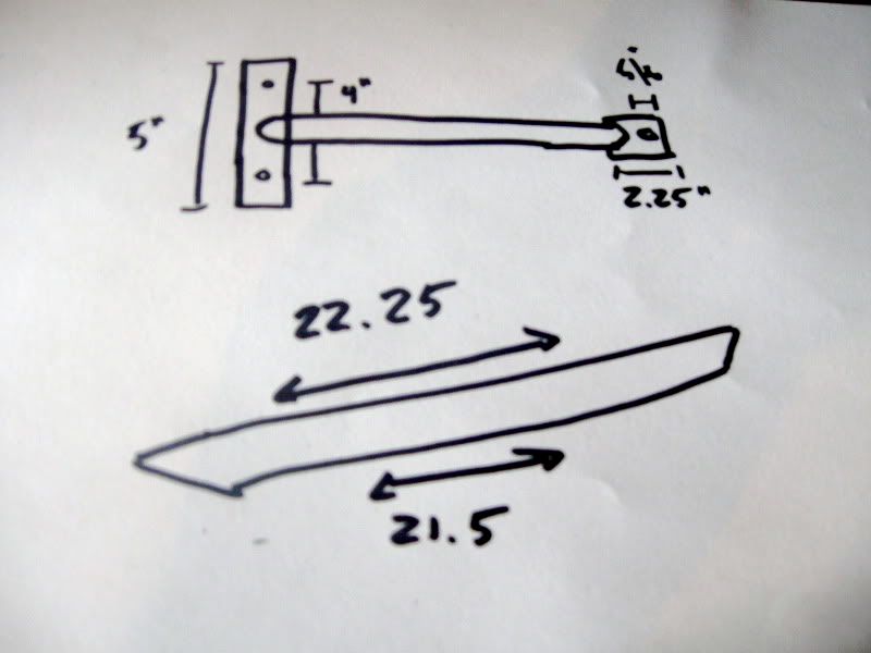

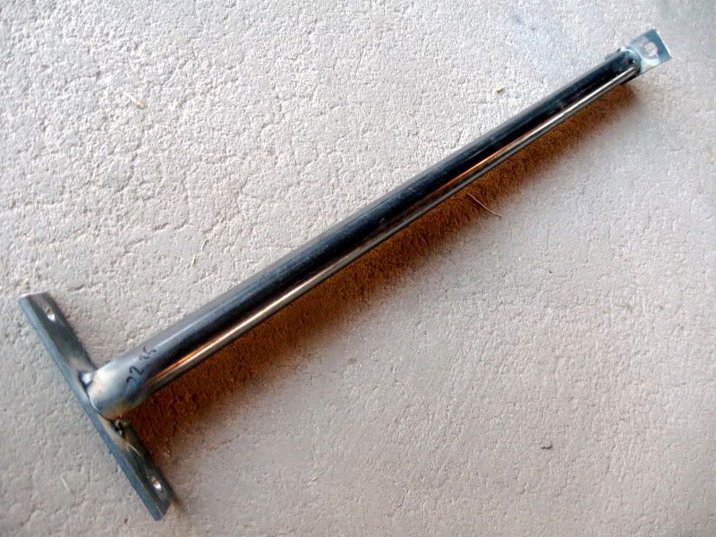

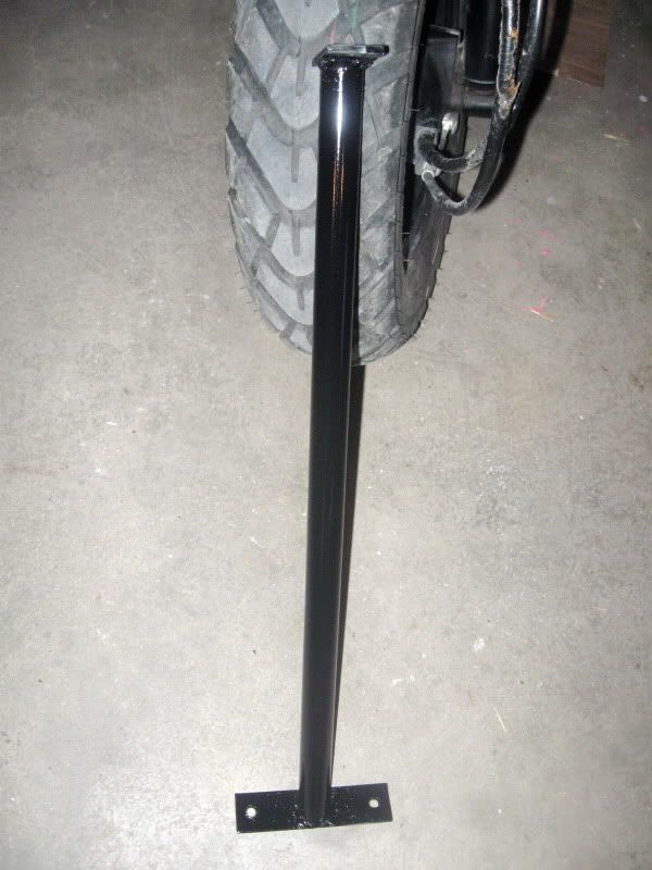

This is pretty easy. Anyone with a chop saw, welder, and a tape measure can knock this out pretty quick.
Here are some measurements.
^^haha. I know, it looks like a 5yr old did my drawing for me. lol
The whole thing is just made of some steel tubing and strap, measured out and welded together.
After measuring twice and cutting once :wink: , I had it all tacked together:
Testing it on the scoot, its a perfect fit:
Pulled it back off and primed:
And painted:
And thrown back on:

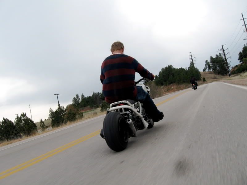

Here I am, enjoying my newly stretched, newly drag braced ruckus:

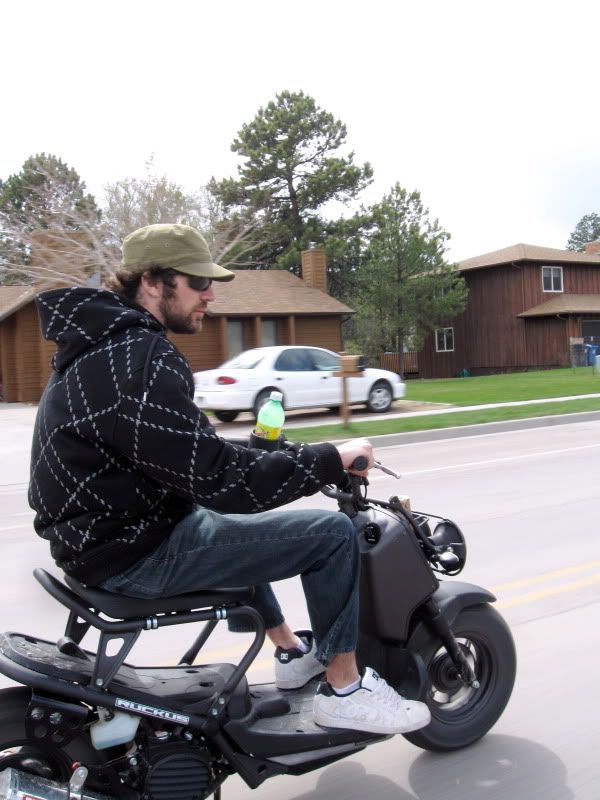

Here is Andy(our guest rider for the day) smoking a cigg, riding my stock ruck:
very classy Andy. lol

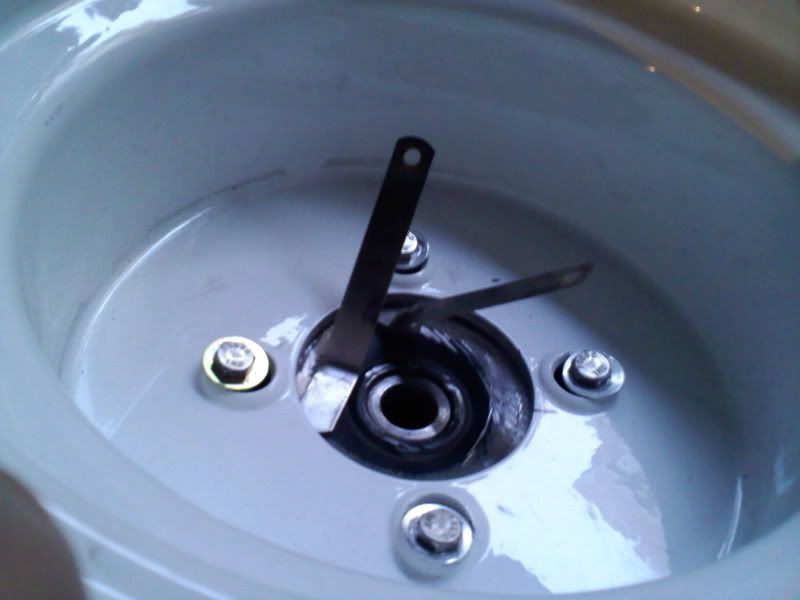

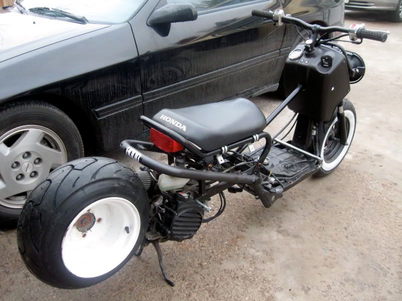

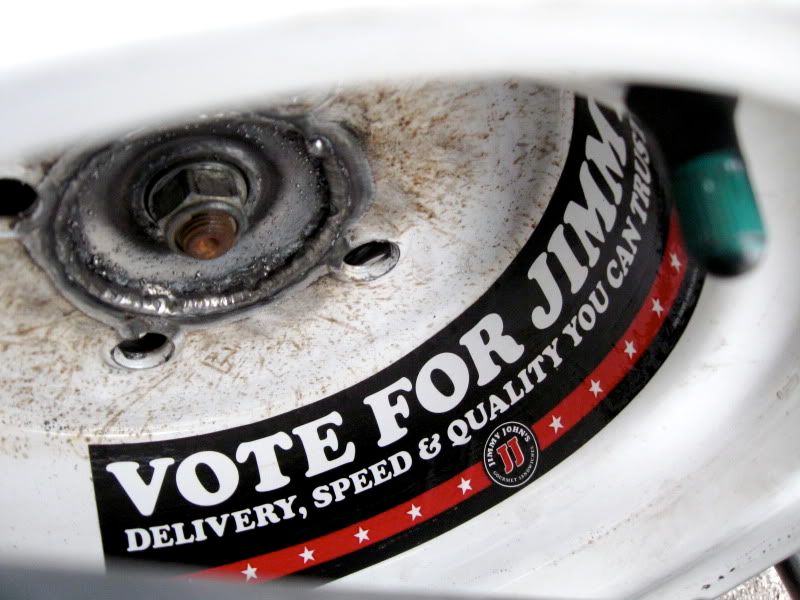

DIY $48 FATTY

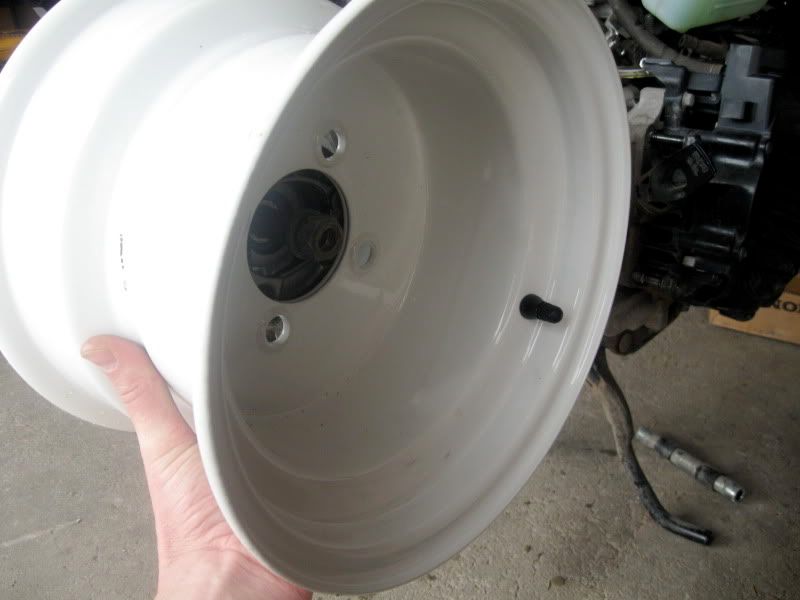

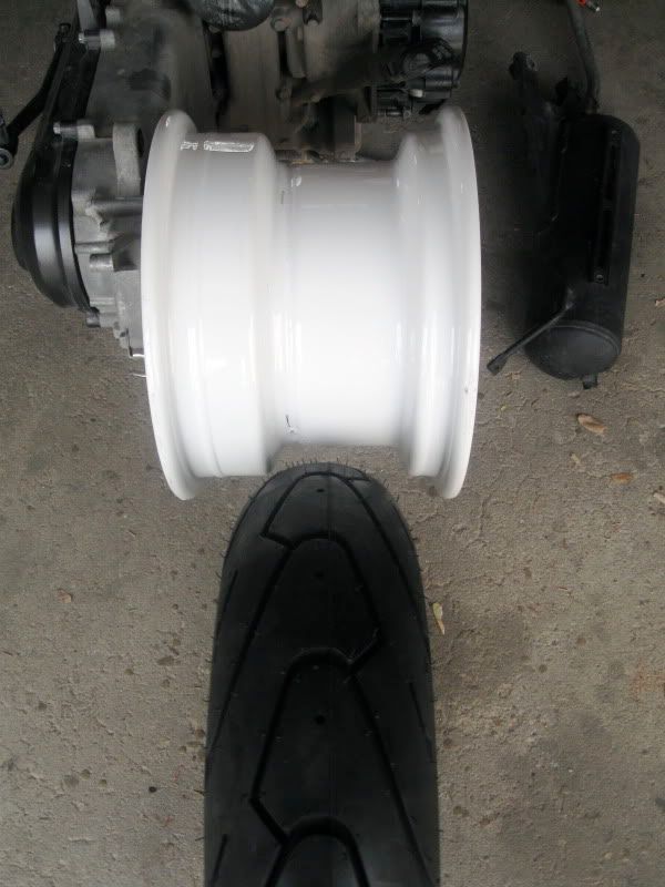

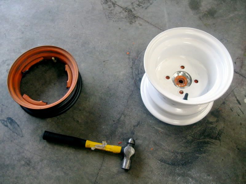

We used a 10x7 steel golf car wheel. Offset was 3:4. Which basically means a 3" lip on one side and a 4" lip on the other. Basically. ha
Here is the exact wheel we purchased on Ebay:
http://cgi.ebay.com/WHITE-GOLF-CART-whe ... 2364wt_941
We call it the $48 fatty, but in reality, it only costs you $47.49 :wink:
lol
I received the wheel, spaced the motor over, and kind of test fit it to see who close to center it would be:
Here its just set on the scooter. Just trying to visualize it:

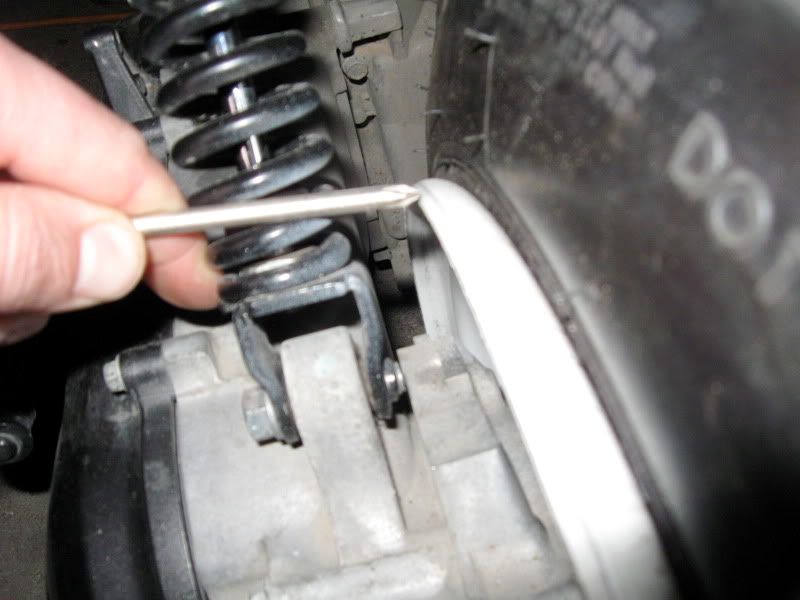

This is also the time I realized that putting a stock 130 tire on the rim, might not be the easiest thing. lol
So here is basically how it is done.
Take a grinder or cutting wheel and butcher the center out of your stock wheel. So now the center of your stock ruckus wheel becomes your hub. Center the ruckus hub as best you can inside of the golf cart wheel. make sure before you start drilling or welding, that you have the 3" side facing the swing arm.
Now grind off the paint on the face of the hub and the back side of the wheel.
After measuring a few times, we drilled holes in the ruckus hub and used small bolts to attach the hub to the wheel. Now the bolts will eventually be removed. They are only there to make the balancing process much easier. Make sure that your bolts are quite a bit smaller than holes, to allow for maximum adjustment. :)
After you have the bolts snugged down, stick the fatty on your scoot, turn it on and get the wheel spinning.
At this time you will notice that your new wheel assembly wobbles and looks like complete sh*t. haha

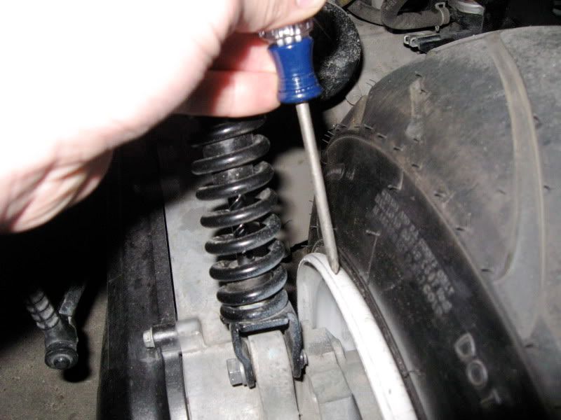

So first things first, grab a philips head screw driver, brace it the shock and touch the edge of the wheel, like this:
*note, I originally did this with no tire on. These pics were taken after the fact, just for visual purposes.
Then with your hand spin the wheel. Using the edge of the screw driver as a reference, you can see exactly how much the wheel is wobbling left to right. If I remember right, this is called lateral runout.
So what I did was stop the wheel when it was in its farthest left position, (i consider this to be a low spot)then loosen the bolts holding the hub to the wheel and stick a feeler gauge between the hub and the wheel, tighten it back down and spin it again. Find the low spot again and repeat.
Of the two we have built, it didnt take more than 3 feeler gauges to get the lateral runout to an acceptable point.
Here is what it should be looking like:
By now your wheel shouldnt be wobbling left and right much, but may be moving up and down(its called radial runout), because the hub may not be perfectly centered still.
Now take the same screw driver, steadying your hand against the shock again, and point it vertically against the lip of the wheel:
*note- my hand is firmly anchored on the shock, so as the wheel spins, my screw driver does not move at all.
Now spin the wheel by hand, stop it at its highest position, just slightly loosen the bolts holding the hub to the wheel(not too much!! you dont want your feeler gauges falling out!) and give the wheel a tap with a rubber mallet, in the appropriate direction. Retighten, spin again, and repeat until your satisfied with the results.
Once you think you have it spot on, start the scooter and get the wheel spinning. You will never get the wobble out completely, but if you ever notice, a stock ruckus wheel is not perfectly true either.
The first time I did it, i readjusted time and time again, trying to get it perfect without success. So I pulled it all apart, took the wheel into work and spun it on the balancer. Guess what...... the damn $48 wheel isnt even straight. As a matter of fact, it had more wobble than it did when I had it bolted and adjusted on my ruckus hub.
Feeling better about myself, I went back home, redid the whole process and got back to where I had left off: An acceptably straight hub and wheel bolted together.
Ok, time to bust out the welder! :D
I laid a few tacks down, as close as I felt comfortable to my feeler gauges. I wanted any spacing my gauges were doing to stay the same. After the tacks, I removed my feeler gauges, threw the wheel back on and spun it to make sure everything was still looking good. It was. :)
Time to weld!
This is the outcome:
Didnt look too bad! I let it cool down, threw it on one more time just for my own piece of mind. It still looked great.

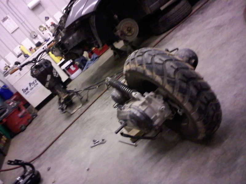

So I removed the bolts I had in the wheel and with the help of a couple ratchet straps, mounted the tire.
Here are a few pics:
*note-no shock on, that why the back wheel is so far up.

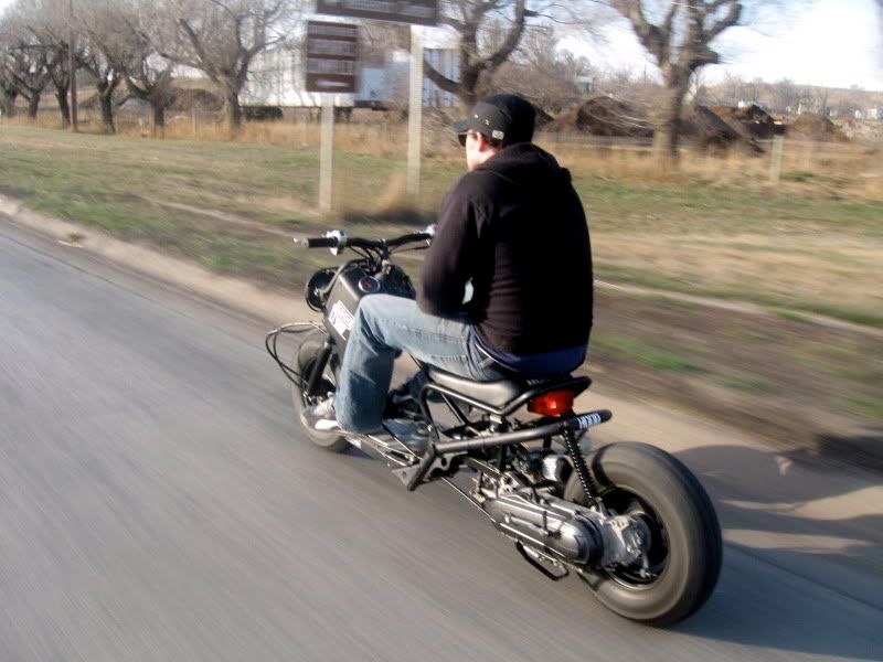

After buttoning it up, I took it for a spin. I cannot notice any wobble or vibration an any speed. A friend of mine just purchased a bolt-on hub and wheel combo and my $48 set-up appears to be truer than his.
Now, if your wondering how sturdy this set-up is, Kcud did the same process on his mini fatty he built and put probably 500miles on it(before we built him a $48 fatty) with no problems what so ever. We ride fairly hard too. Hop curbs, bomb parking lots and alleys. Lots of bangs and bumps. Not a single problem. If you have a welder and some patience, you can build your own fatty and save some money towards go-fast parts or hookers or drugs or whatever!

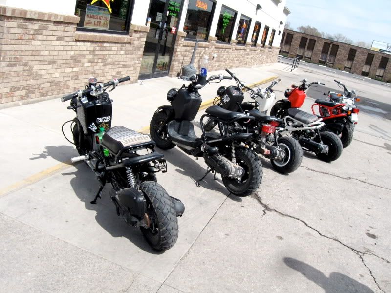

More pics from a recent ride:
Met up at subway:
My bud T-roy, enjoying his newly purchased Ruck:
Thirsty fella, I guess!
Pete's scoot(which two weeks later looks nothing like this. haha)
Stopped at a gas station:
Clint and T-roy decided to roll through the Taco Johns drive-thru. lol

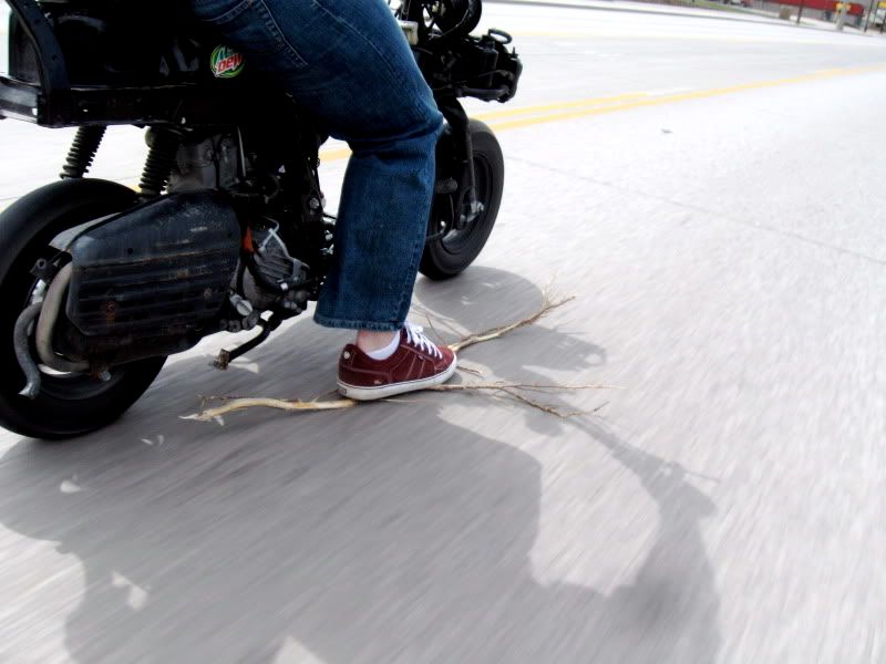

Clint, on Skeletor, decided to drag this stick around with him:
He literally drug it until, riding behind him, it smelled like a forest fire. Eventually the stick was ground down to a fine powder! haha

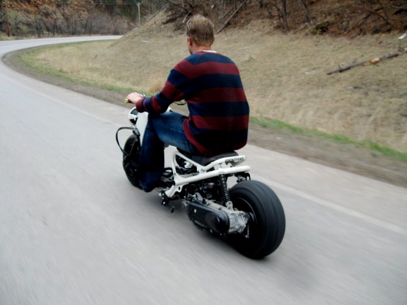

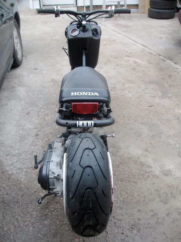

Me and my $48 fatty:
Kris(Kcud) and his $48 fatty:
Kris likes to paint things, so he made his perdy.
I am ghetto and like ugly things, so I left mine(at least for now), but I did slap it a Jimmy Johns sticker on it. HAHA
I love JJ!!! :banger:
