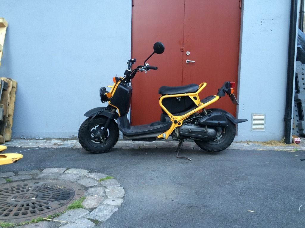

I was lucky to find one online for $750 a bit beat up and lots of miles on it. The speedo said 36 000km!.. YES! 22 369miles. The previous owner said the motor had been swapped some time before he bought it because the mounting points for the center stand had broken off on the previous motor. Totally meaningless if you ask me..
Anyway it started right up and runs perfect so I´m happy!
I have some experience modifying stuff. My first scooter a Yamaha neo´s back when I was 16-17 I modified a littlebit and gave it a full paint job. After that I had a 2009 Vw scirocco that I modified a bit, anyways I like making stuff and building stuff so this is a perfect small hobby now that I´m a student.
Here´s a pic of it. I got the seat reupholstered to a light brown/tan-ish color. I don´t have a pic of it though.

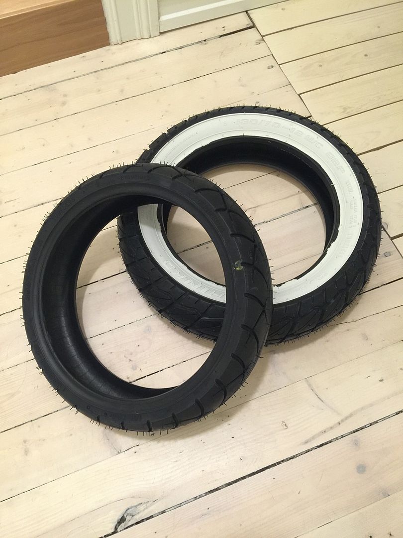

Shinko whitewall and low profile Kenda tire.

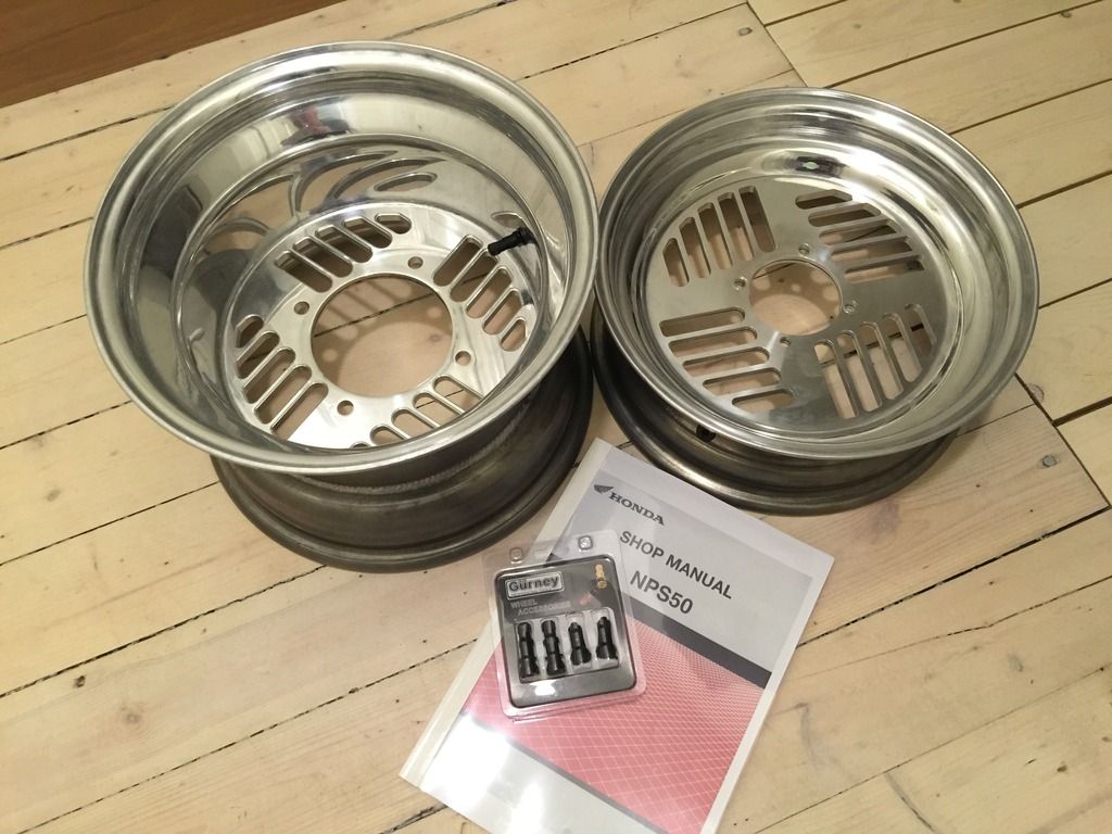

Wheels from machinedmachines. My own cad design based on the Centra type 7 wheels from the 80s. Some black metal valves and I printed the shop manual to have on hand.

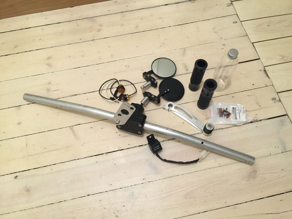

Handlebarclamp, some small led blinkers for the batterybox, handlebar mirrors, kick, led relay, grips, honda emblem and a small bottle I want to convert to the coolant reservoir. The handlebar itself I found in the metal trash at school and it was 22mm so I was quite lucky. Bent it a bit on each side. Its probably going to be black.
