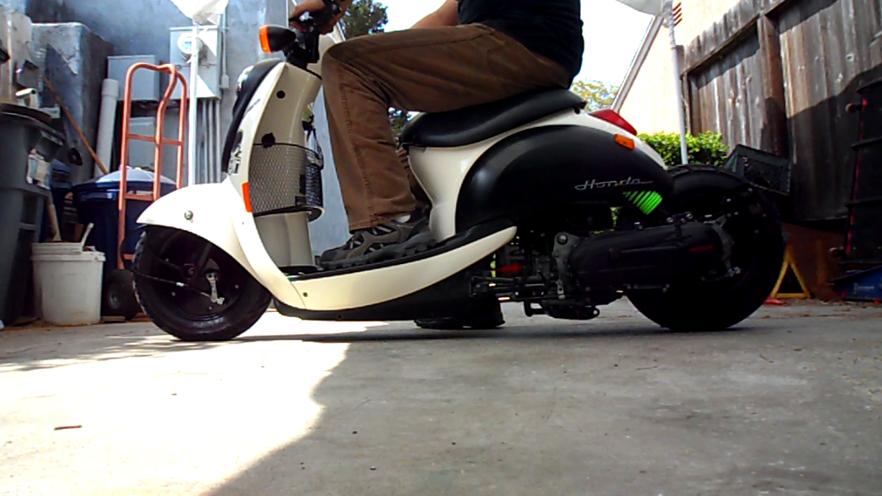

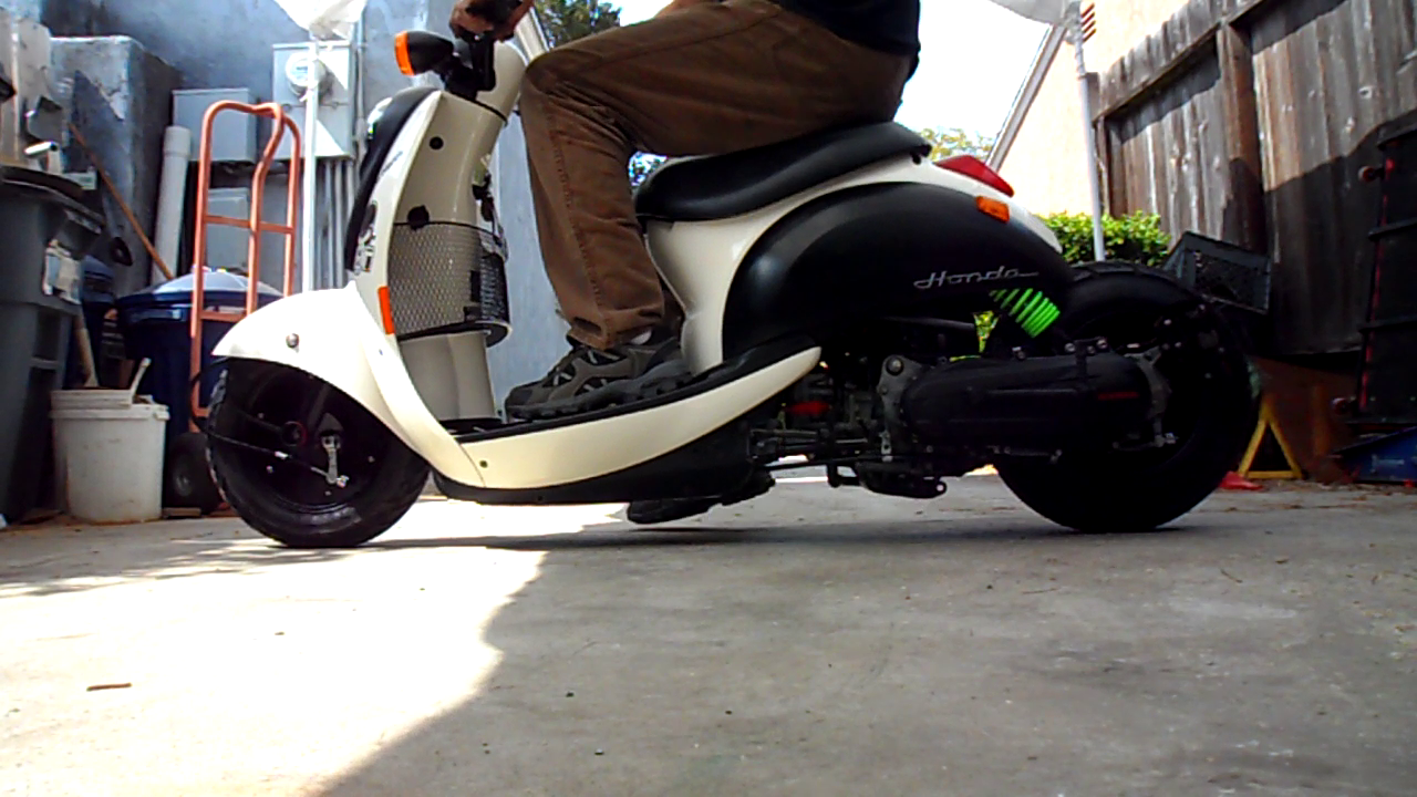

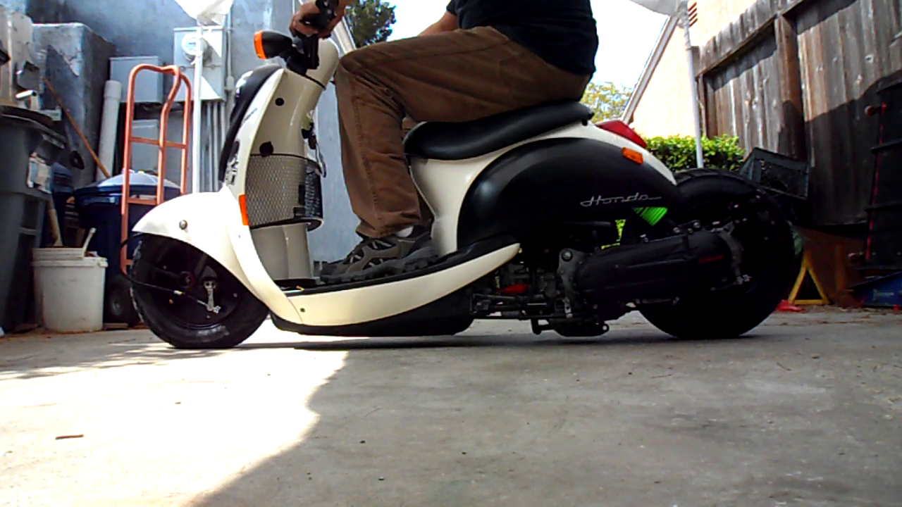

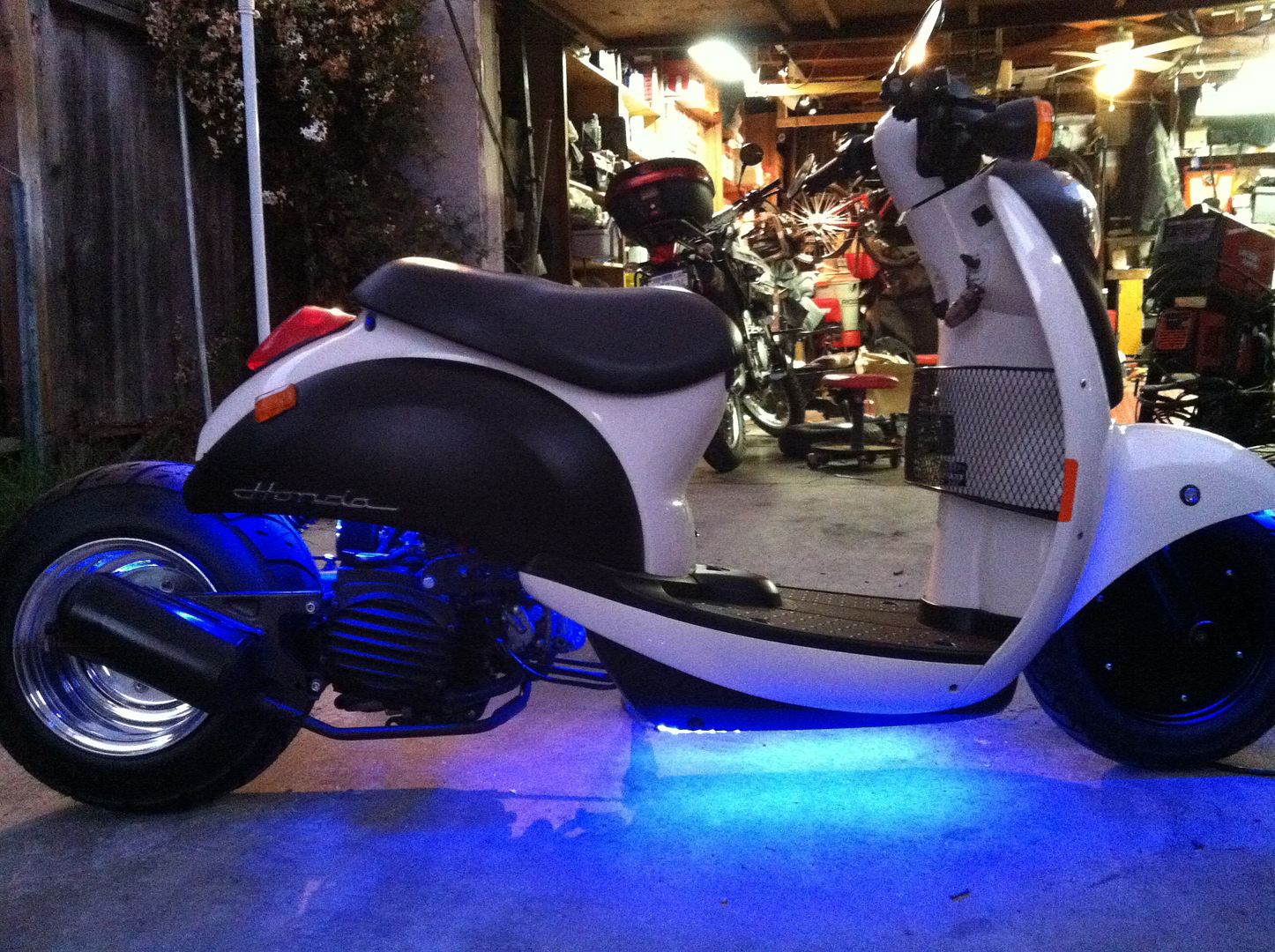

got the ground clearance ride height thing all worked out
ended up installing a longer rear bottom shock mount then what I had before with the stretch
im all about having a safe bike, and not breaking apart the engine because its too low
here are some before and after
and also using different shock stiffness settings
ride height
medium shock stiffness
super bounce
note header hits ground where I slipped a larger diameter pipe over it to extend it to clean the exhaust
I think if it was the stock skinny pipe then the skid plate would be hitting
stiffest shock setting
ride height
stiffest setting bounce test
longer rear shock mount
how its going to stay for now on
Max super bounce test
softest shock setting (longer rear shock mount)
note my foot in the air
I was coming off a hard bounce so it pushed my foot up
plenty of ground clearance
this is the rebound bonce
look how much travel the entire bike has
makes for a decent ride

took 2 different met exhausts I had laying around
one had larger header, and the other had larger outlet
Also made stainless heat shield not shown under plastic shield
So my fiberglass bond doesn't get too hot along with the glue holding the two halves together
also plasti dipped the rear wheel black
although I did like the shiny aluminum look it didnt match the front wheel covers
im debating weather or not to use my chrome powder coat and do the front wheel covers
then peel off the plasti dip
but for now I will see how it is all black

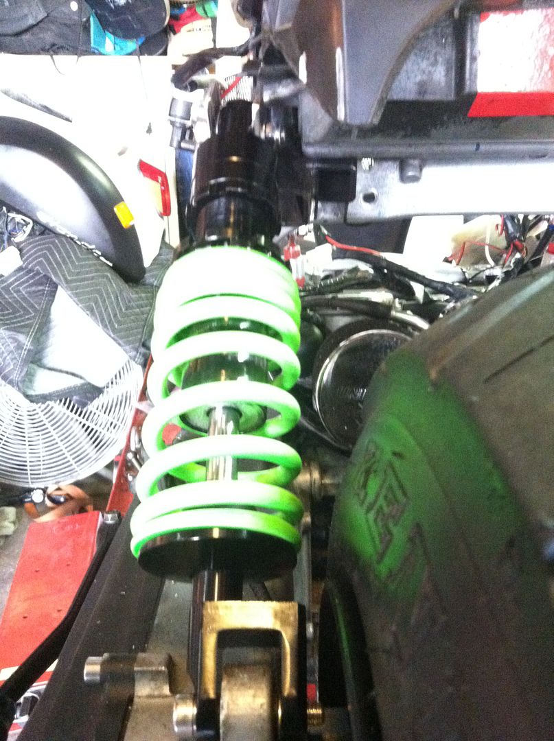

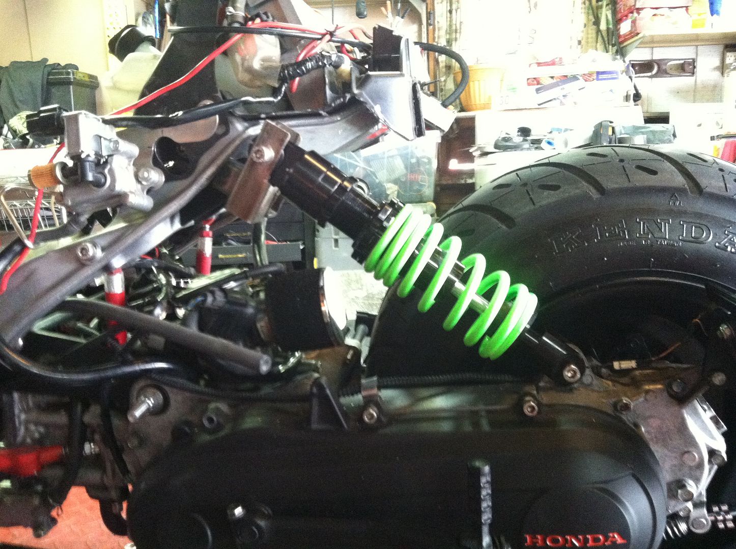

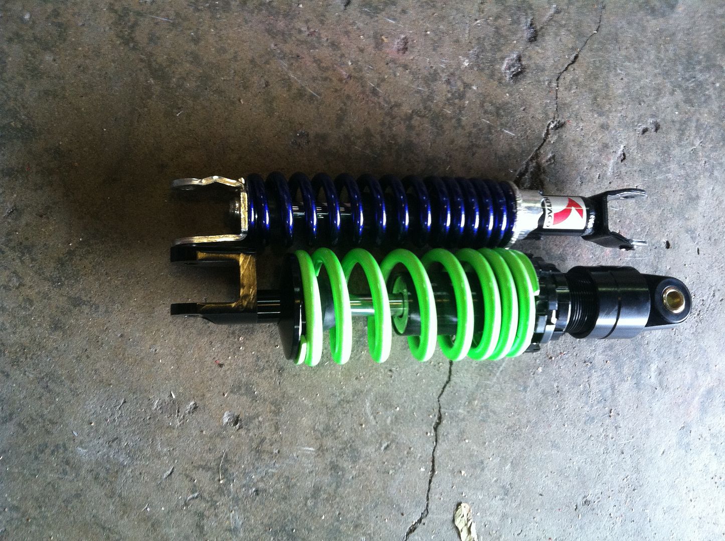

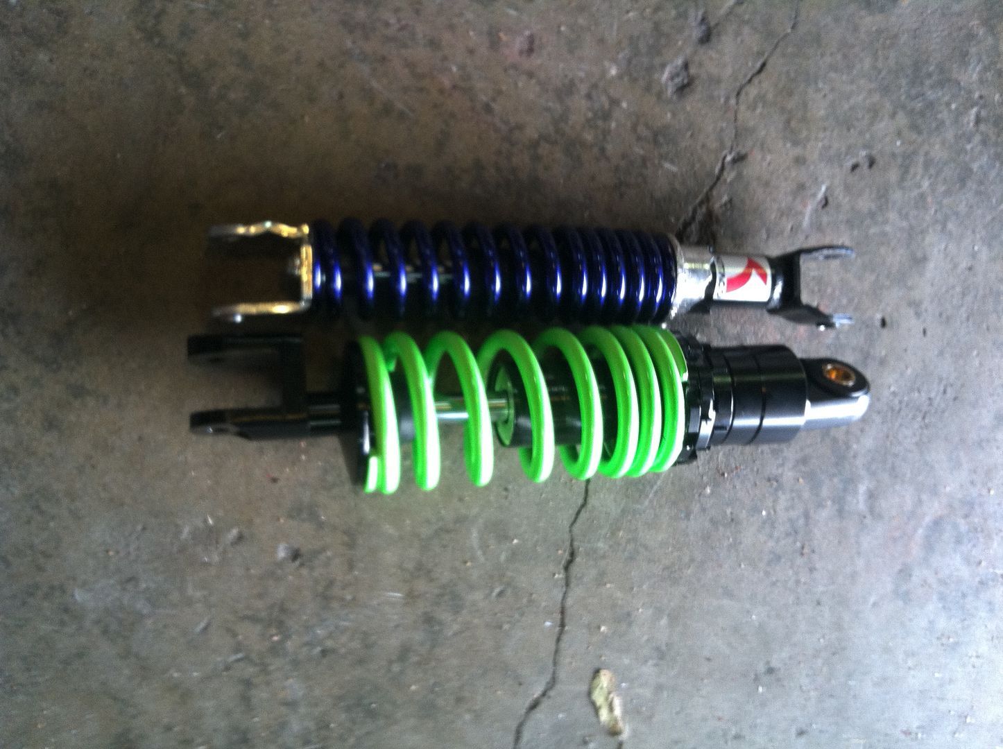

got a poon shock today
its much fatter, but has a ton of adjustments
it has height both top and bottom can be unscrewed to raise or lower it
and also the spring tension
first I had to come up with a new mount
since it was fatter this also meant I had to offset the mount over more at the top
compared to my kitaco only the top part expanded longer
I dont want to mess with the bottom
also the way its made I can easily take out the spring to repaint
but I like the neon green maybe will do other parts on my bike this color
here it is smallest
as you can see same length as the kitaco
I was hoping it would be smaller
still nice and straight
this is what I came up with
since it was as tall as the kitaco I decided to raise it up as high as I could
this also puts it at a better level
I may add a gusset or something not sure yet
its just welded on all 4 sides
this was the first test
right on the swingarm
problem was too low, and the shock spring being so fat pushed the body panel over causing the other side to rub on the tire
experimented with my lower adapters I have laying around
but because they are square tubing I had to grind the inside of the shock wider
which took forever but I got it
in the end I used the bottom mount I Have been using
note it places the shock further inside the body, now the plastic miss when compressing
so dont have to worry about the body tearing into the tire
Shock spring is at max tightness
and shock body is set to the shortest
right now bottom out is lower
I need to see if I expand the shock taller, if that helps
but I also dont want to loose how low the bike sits when parked too
thats the whole reason I got this shock, to look lower parked
bottom out
max height jumping
now the before and after ride height
before (yesterday)
after (today)
Im guessing 1/4 inch lower now? ride height
hard to tell from the pics
and max lowest looks like 3/8 lower????
now parked height
before Note the engine height not the body panels
it is lower but just by a little
after
I can get the shock a tiny more tighter I wanted to leave a few rows of threads left incase I did need to loosen it up
so I will probably tighten it all way
still has smooth travel being so tight so im not worried about it being super bouncy

here's the crazy ass mount
super ugly but my cnc machine is broken down right now :P
