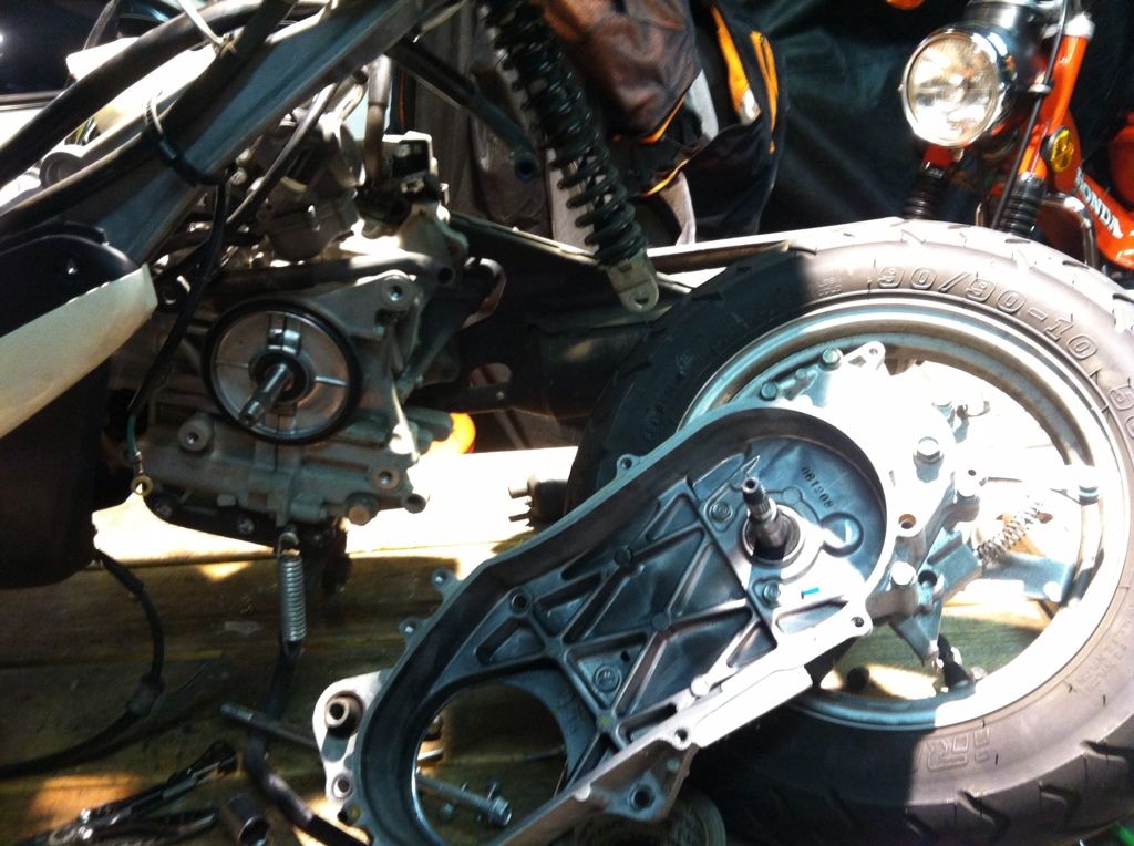

here is taking out the old swingarm to put on a ruckus swingarm
ruckus arm installed

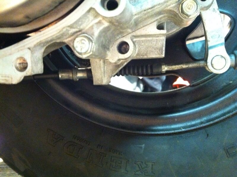

was able to relocate brake line to work
but then sitting on the bike brake arm would move, causing brake to activate
remove this clamp and run line differently
easy fix but little work to do it
take off that arm on the right, its on a spline
hard to tell but there are little marks where its supposed to line up
just move it over by 2 lines
I went clockwise 2 lines over
click it back 2 notches, of course thats a little difficult but the hammer helped out here
now it works perfectly using stock cables
only thing is when not sitting on bike lever barely works brake
but since I only use brake when sitting on the bike not a big deal
works prefectly riding the bike, so thats all that matters to me

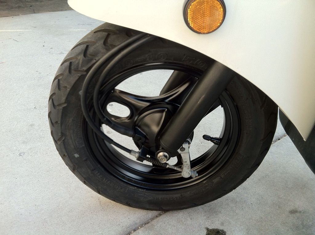

painted front wheel satin black, came out pretty good

my front wasnt adjusted too well because I just painted the front wheel yesterday, or that stupid 2 into 1 brake thing made me loose some front strength not really sure how that works
just something I have to be aware of, if adjusting the front doesnt prevent that later
