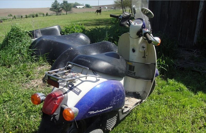

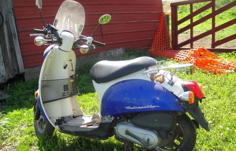

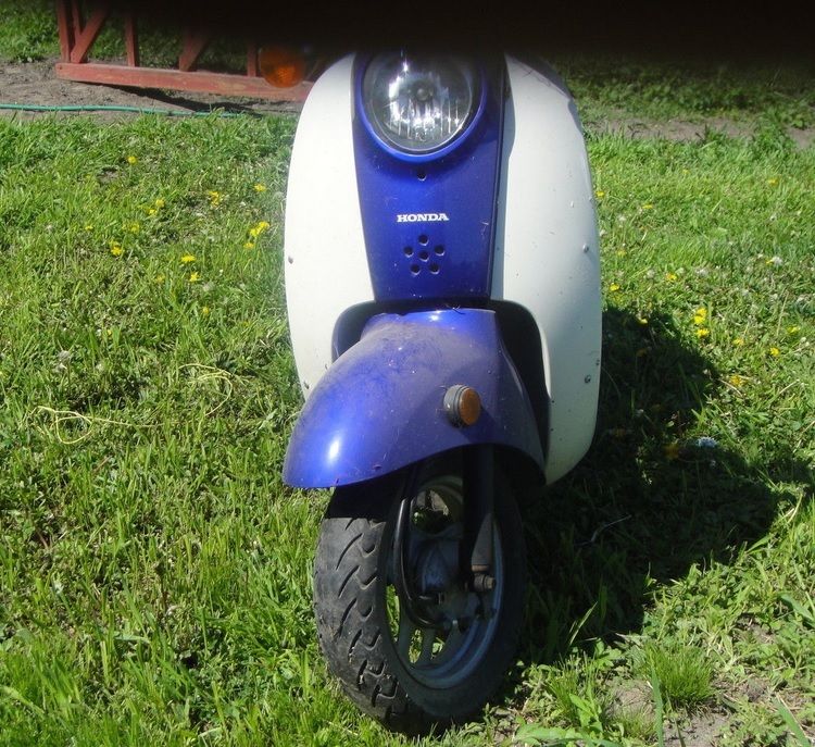

Alright picked it up Saturday May 23rd. 10hr round trip. Thanks to my friend Lee for tagging along.
Got it home and started tearing in to it to see what a barn find Met is like.......... And WOW!!!
After pulling the rusted to crap tank i found animal droppings and all sorts of bugs. So she got a bath!!!
I noticed when rolling it in the garage the levers had no tension and well they are rusted and broke. So figured better finish pulling plastic since its all getting painted anyways. And look what i found......
And Mickey mouse decided to try and hot wire it I guess.....
I tried to see if the motor would turn with the kick start lever. Well my 185lbs didnt budge the damn thing. Opened it up and look at that performance clutch :lol: :lol: :lol:
