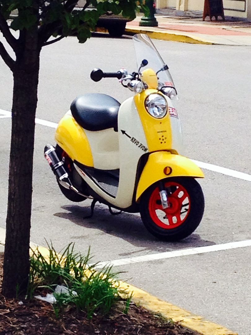

RGGS shocks added today. 1-1/2" spacer needed.Image

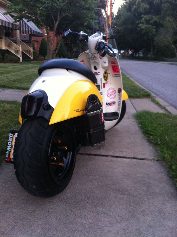

I cleaned up the head sufaces. Put on the rings. Ordered a new crank and a bunch of seals. Big bore moving along very slowly. Image
