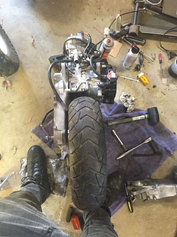

The short of it: 09 Ruck. Left outside for 2 years then 2 years in a storage unit. Locked up stock motor. Stock MET motor thrown in w/ purchase. I plan on painting the frame and swapping the motors. Then getting her running
The old girl as she sat when I wheeled her in. Looks better in the pics:

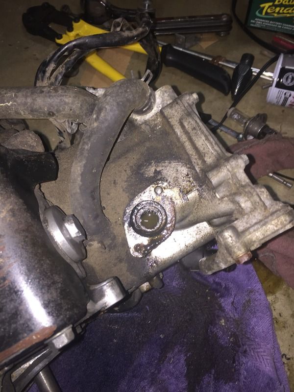

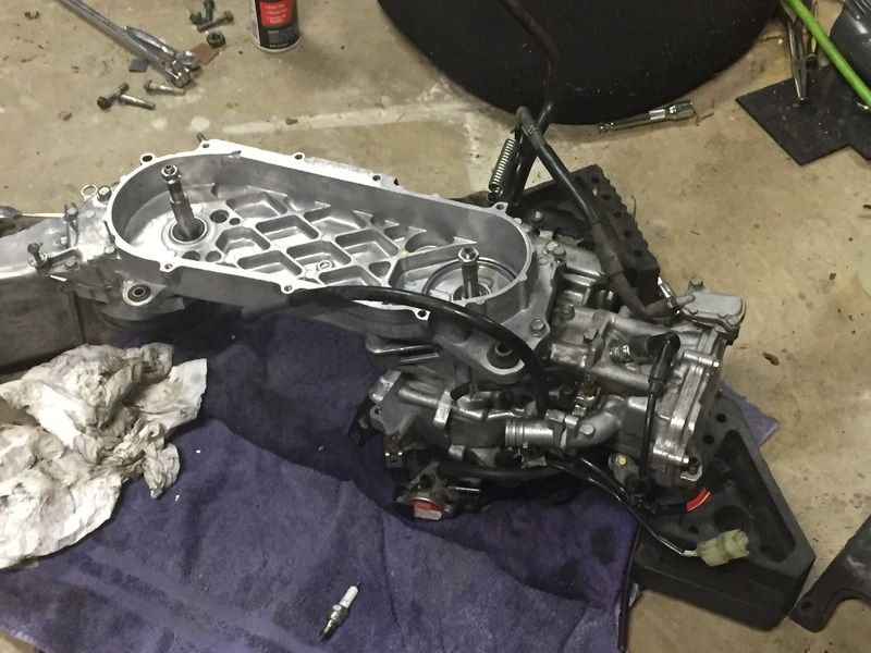

After a lot of great help on the Noob thread. I pulled the locked up motor today. Took the cvt/swing arm off and cleaned her up. Then swapped it onto the MET motor.
Few things I noticed:
- Rollers in the ruckus variator have flats spots. Ones in the MET do not.
- Brake assembly on which the rear wheel mounts (on the ruckus) looks exactly like the one on the MET swingarm but with a section hacked off for clearance. Is this a mod?
- Pulled the exhaust off of the locked motor and there was what looked to be a mix of water and junk in the motor. Exhaust sounds full of liquid when I shake it but only a few drops comes out at a time when I shake. Trying to drain it by standing it upside down.
The rest are just pics of the process:
Ruckus CVT/Swingarm on the MET motor

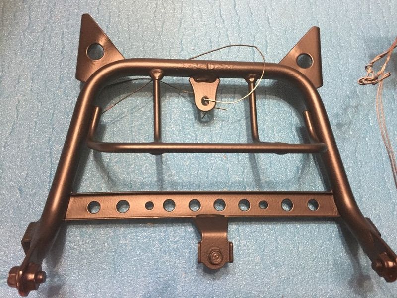

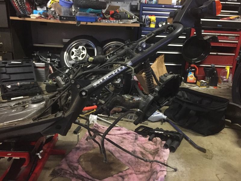

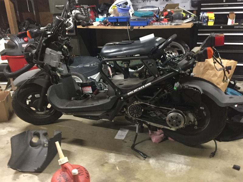

Getting back to the frame itself, I detached the headlight bracket and the rear frame and seat frames and are getting them sand blasted, in hopes of just priming and spraying them a satin type.
The hardware on the handlebars was so tight that I was about to strip the screws. So I was not able to remove them. My plan is to just scuff them up as much as possible and paint them.
While messing with them, I believe I detached the brake switch that's on the left of lever and I've been having a hard time getting it back in as it seems like it's spring loaded or something . It is different from a motorcycle brake switch, so I'm having a hard time with it. Any suggestion? I will update later with pictures
Also when removing the engine, I didn't pay too much attention to the lines that run from the engine to the airbox really. So I'll be asking for help on those in the future haha
Thanks again Gents

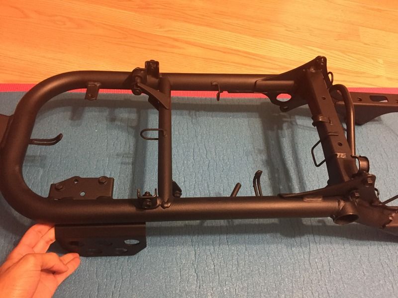

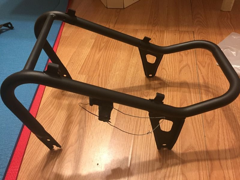

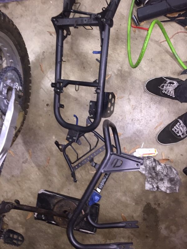

Sorry for the wait. This thread is not dead ha. I had my first experience dealing with "body & paint" guys over promising and under delivering. Took longer than expected but here are the parts, They sandblasted to metal, used a Zinc-Cromate primer, then 2 coats of flat. Not perfect but it was cheap...ish and wont rust:
Going to cut the bunny ears off and can spray
Shes looking alright, Got a used lower seat that's flaking gloss black. Going to scuff it down and flat it when I get a chance
The P.O. sprayed ALL the plastic with bedliner :pissed: , the shit just holds onto dirt like no other. I absolutely hate it, but blasting it off with the pressure washer is taking too long. Going to scrub/clean it good & touch it up with more bedliner
Wish I would have gotten it back soon, having a hard time remembering during reassembly but I'm getting there
Was doing fluids while it engine is out. Drained the rear gear oil, flipped it over and started filling. Calls for 100ml but I'm a dummy and thought I'd fill it to the top. That would probably take way too much so I'm going to drain it, measure 100ml, then flip it over and fill :headbashing: :pissed: ... :|
Should have the motor hanging out in the frame come tomorrow night. Ill be sure to take pics.

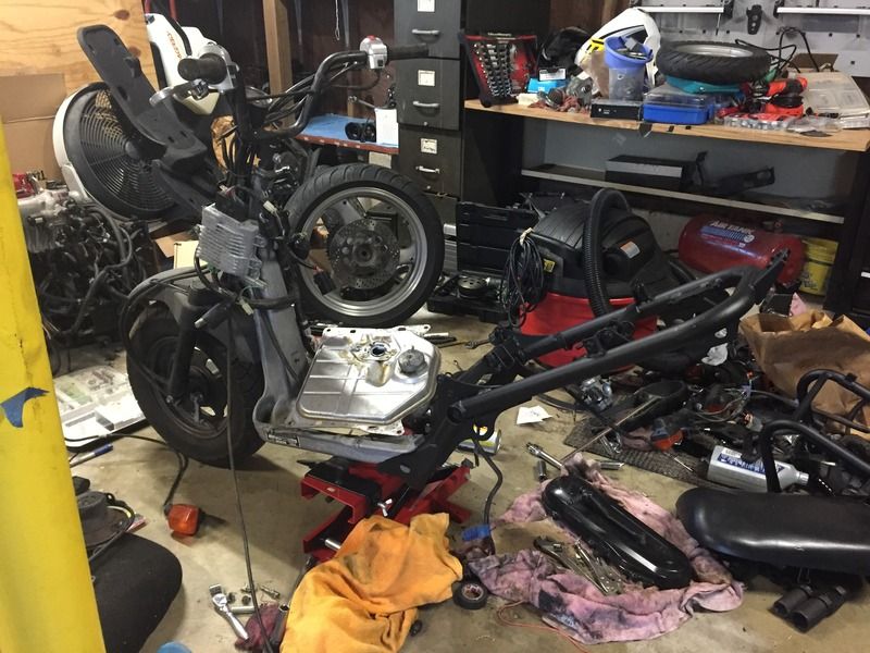

So I got the motor all bolted in and wired up. Had a bit of confusion but I used the post OldFart recommended and everything went decently fine.
Compared the MET and the Ruck variators and the MET had OEM weights, and an overall larger variator and cover
I decided to use the ruckus variator, weights and clutch. After examining them, I realized they're aftermarket weights, Green solid, Purple hollow. No weight markings though
Tied up all the loose ends and tried to start and this is what I got, the change in pitch is when hes trying to use the throttle:
https://youtu.be/Hd8CDV7K25c
Whole lot of NOTHING!!! :headbashing: :pissed: :headbashing:
Its getting fuel to the carb I know that because I pulled the line and the fuel pump it working. At least this motor seems like it is in good shape.
Any ideas or suggestions? Pilot jet?
Help appreciated :|
