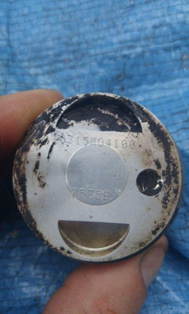

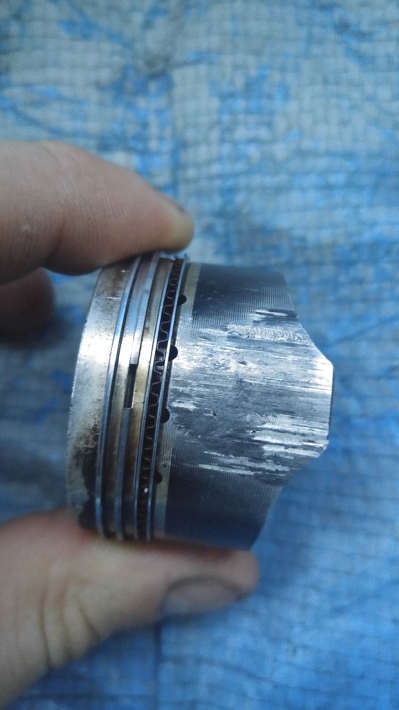

3/30/17 UPDATE: A few weeks ago I was in the process of retuning the Sheng Wey carb. I bought a rebuild kit and wanted to see if I could make it work. I began experiencing problems, totally lost compression and the began sounding and smoking somewhat like a diesel. I ended up getting a used engine from eBay, did the swap, the engine sounded good but was I was only getting about 38-40 mph where I was getting 45+ before with (what I thought) was the same set up and tires. After further inspection, I determined that the head on the original engine was actually ported and the piston was not stock. After some measuring, calling the 3 previous owners of the bike, it looks like the 58.1cc kit from MX Performance (could be wrong.)
Unfortunately, the previous 2 owners werent aware of the big bore modification, therefore, general maintenance was neglected. Even I changed the oil when I bought it and didnt check it again since October since I figured it couldnt have changed much in 4 months. The oil level was very low (the chanito piston burns oil from my research, right?) which would explain why it was low and why the piston failed. :headbashing:

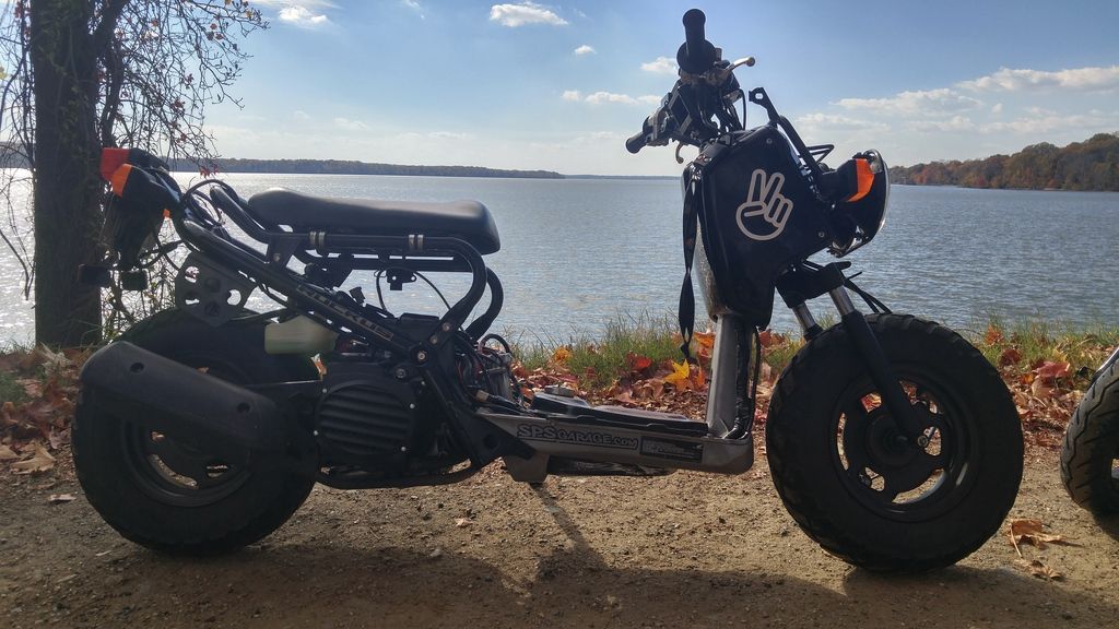

I recently purchased an 07 Ruckus and just joined the forum. I thought I would start a build thread to chronicle the journey with this thing. Im just going for reliability, I dont have plans for a GY6 or a Big Bore build. Im fine having a slow ruck :meh:
When I bought it the previous owner(s) had installed:
-NCY lowered seat frame
-NCY handlebar mount
-Sheng Wey PC20 carb and throttle cable
-Unknown air filter
-Unknown fuel tank cover painted with truck bed liner
-NCY Kickstand (BROKE!) :headbashing:
Since I bought it in August I have installed:
-Polini Hi-Speed variator with Dr. Pulley 6g slider weights
-Gates Powerlink belt
-NCY CDI
-BR Exhaust
-Met fuel sender
-Stage6 Fuel gauge
-DIY shortened turn signals
-UNI filter
-Stock Carb swap from PC20
-35 slow jet/82 main jet
-Aftermarket Grips
-KKmoon foot pegs
-Stock center stand
I also have a Yamaha Vino 2 stroke which is how I got started with scooters so I am new to the Ruckus and 4 strokes in general. I am looking forward to learning more about this bike and contributing in the future.
Thanks! :usa:
