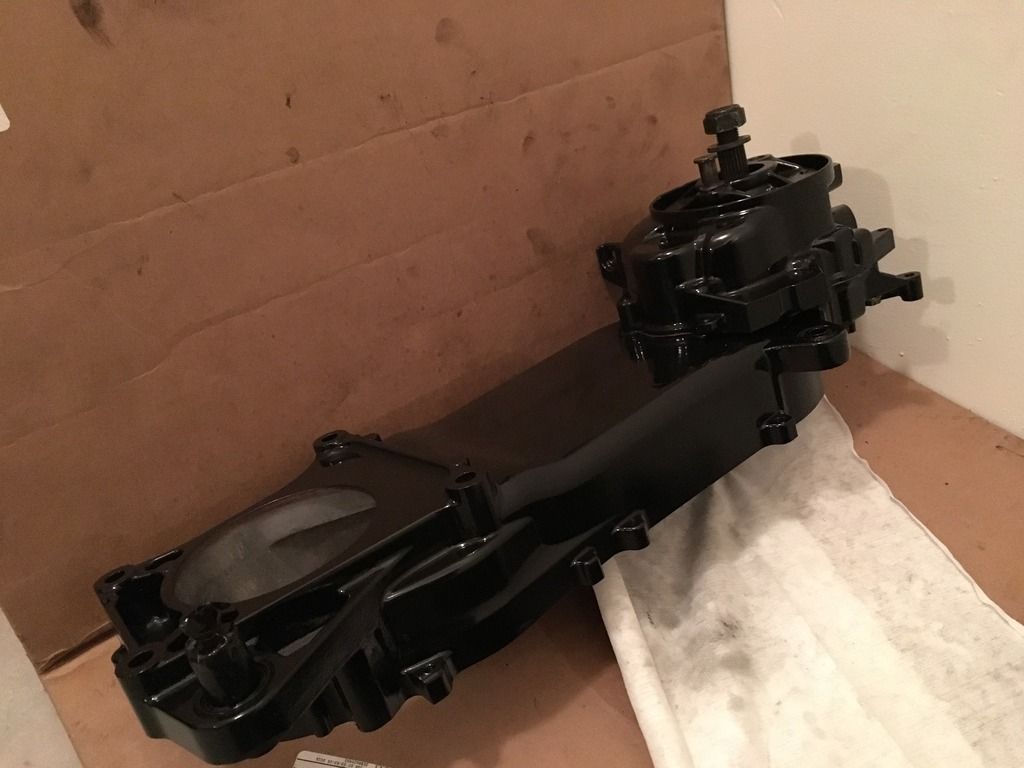

After the swing arm had fully dried, I brought it home to install the MET gears
Ruckus vs Metropolitan swing arm
Ruckus vs Metropolitan gear casing

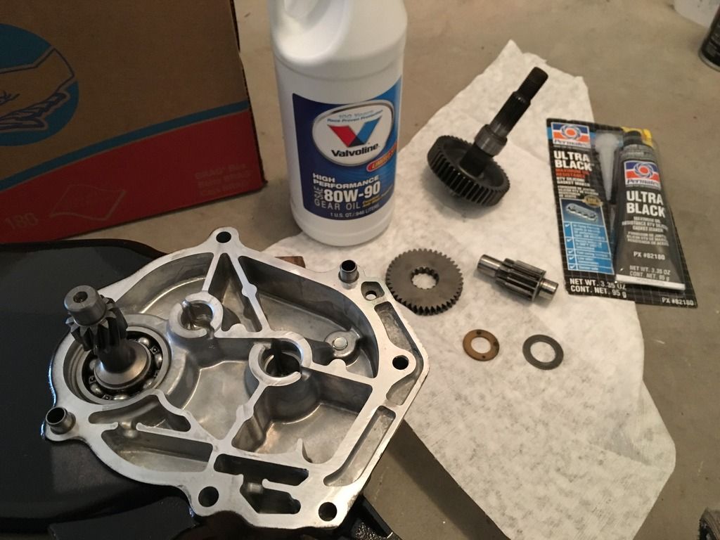

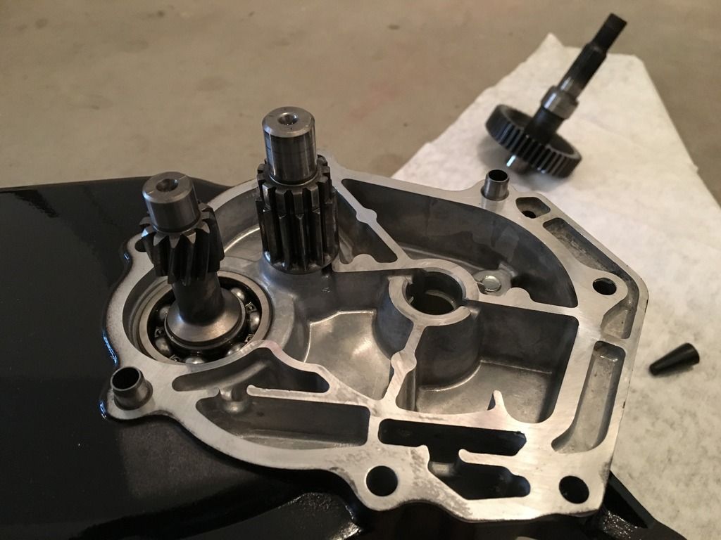

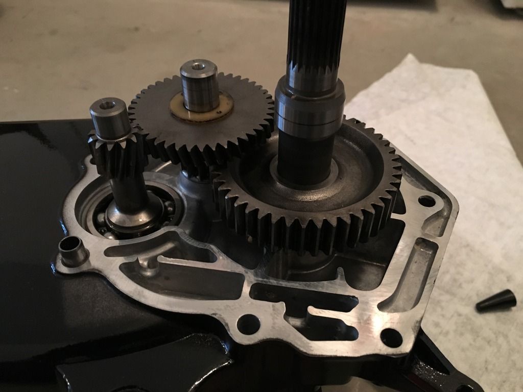

METROPOLITAN GEAR INSTALL
Gears:
4. countershaft (13T)
5. counter gear (42T)
6. final gear (45T)
7. plastic side washer (14mm)
8. thrust washer (17mm)
Hypoid Gear oil:
Valvoline High Performance SAE 80W-90
Gasket Sealant:
Permatex Ultra Black
First gear is 13T
Next is thrust washer, gear 45T, gear 42T then plastic side washer
Rotate the final gear and make sure all gears are aligned and work properly
Lastly add your sealant then wait 24 hours before adding any gear oil
If your confused at all or need more detailed information, click the links I provided in one of my previous posts on page 2
