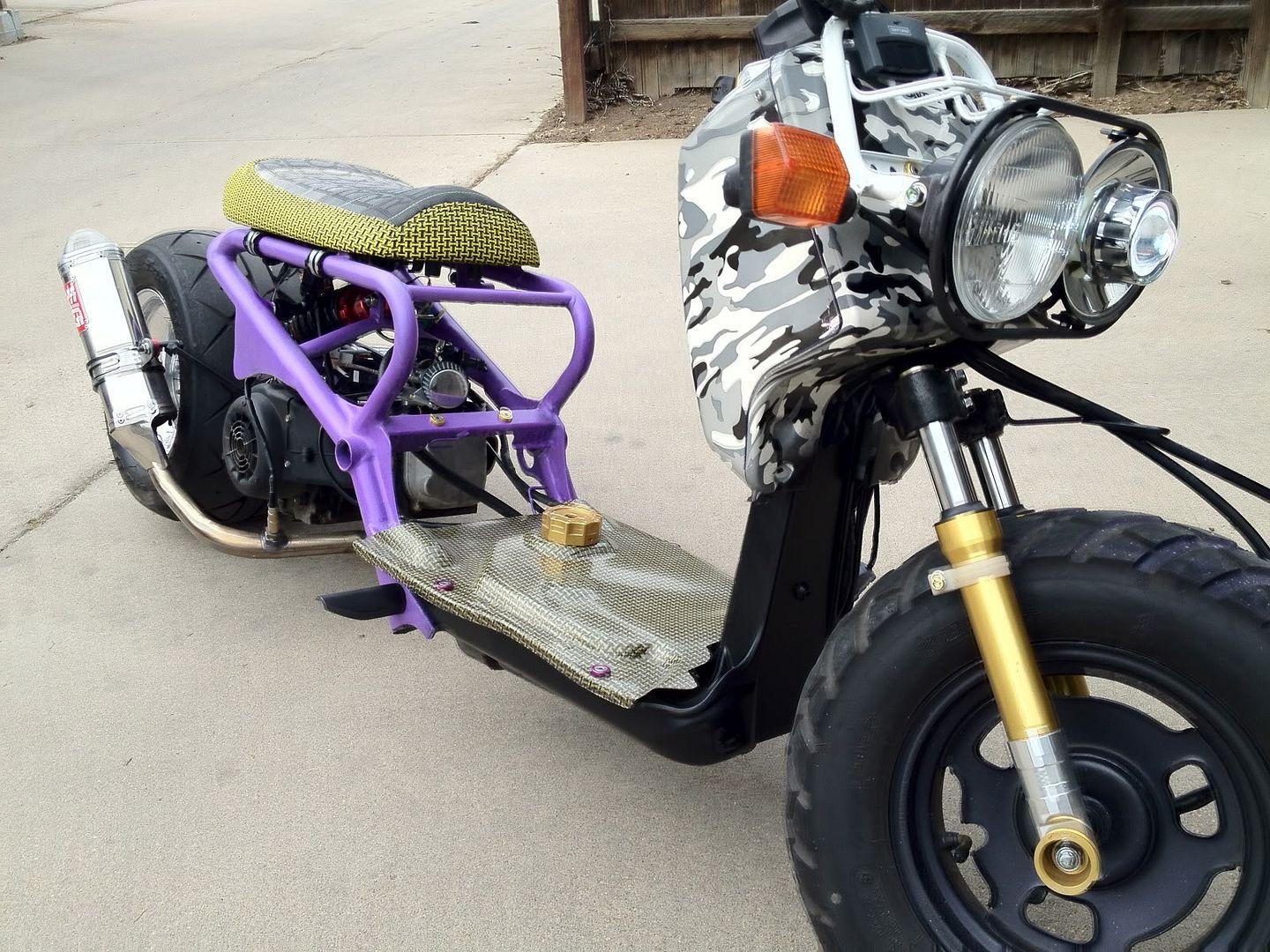

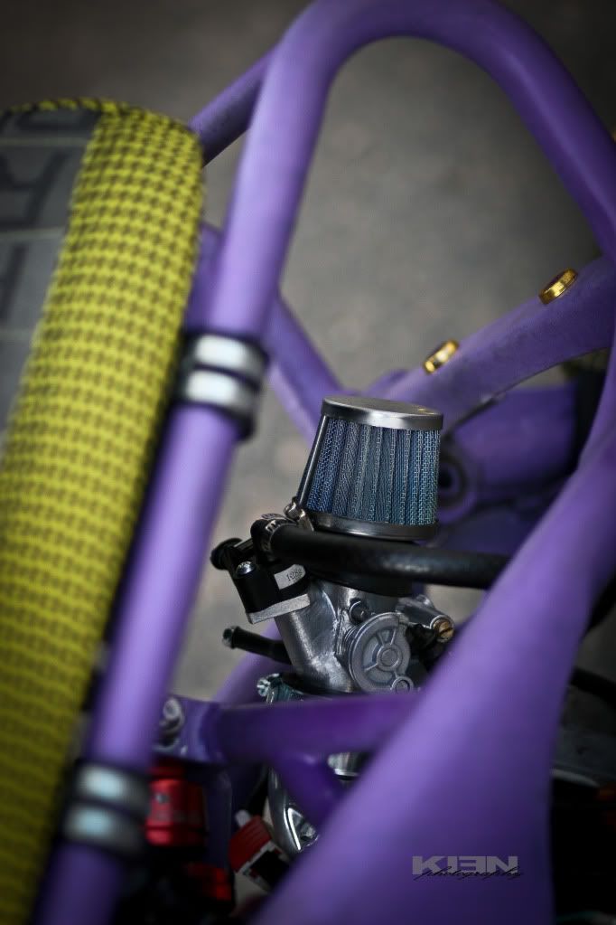

 Post subject: illspeed's Project- "Purple People Eater" PICS UPDATE PG. 1
PostPosted: Tue Oct 18, 2011 11:15 pm
260mm NCY gold rotor
Frando Chrome caliper
Purple upside down shocks
Coil on Plug NCY direct ignition kit (out of stock waiting to arrive)
Hide yo Shit underseat box
Koso speedo/gas gauge
Metropolitan fuel sending unit
new front tire- Continental
OEM honda nissin brake master cylinder with gold bling on it
Purple handlebar

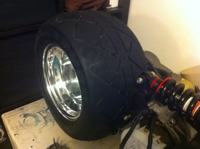

10x8 DWT wheel with Duro Top Fighter Tire, Tire has been shaved to clear dipstick as well as create a more "chopper" type rounded tire
Bi-Xenon HID headlight
Gold Rapid ratio throttle
Extended brake cable
Sequential brake light

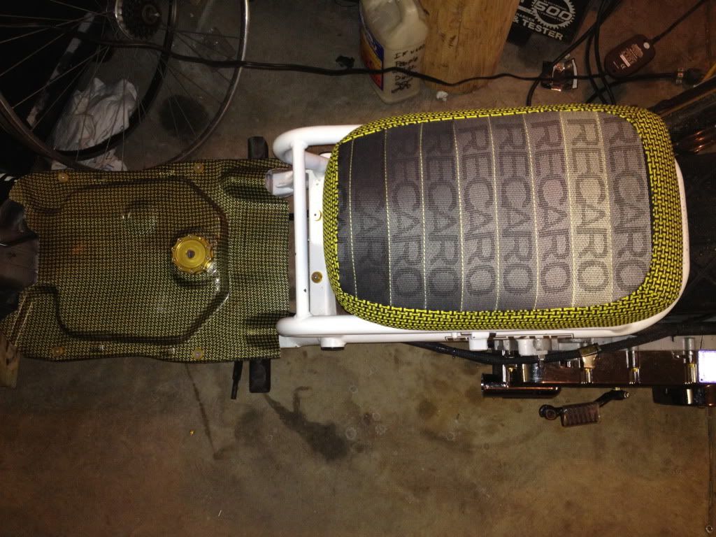

Kevlar Floorboard
Kevlar battery box
Kevlar style seat cover
Dorby Hub
Mojo mount
DAN @ MAX wiring harness
DAN @ MAX gold grips
Custom gold and purple washers
Custom Gold and Purple Screws
T-Motorsports GY6( motor was SHIT!!! replaced head, cylinder, piston before running properly)
ECOTRONS FUEL INJECTION KIT- Fucking awesome! buy it!
Password JDM key guard
Password JDM Kevlar Extended Floorboard
Password JDM Handlebar Stem
Gold Brake line adjust
Got the kevlar extended gas tank cover to match the seat cover-

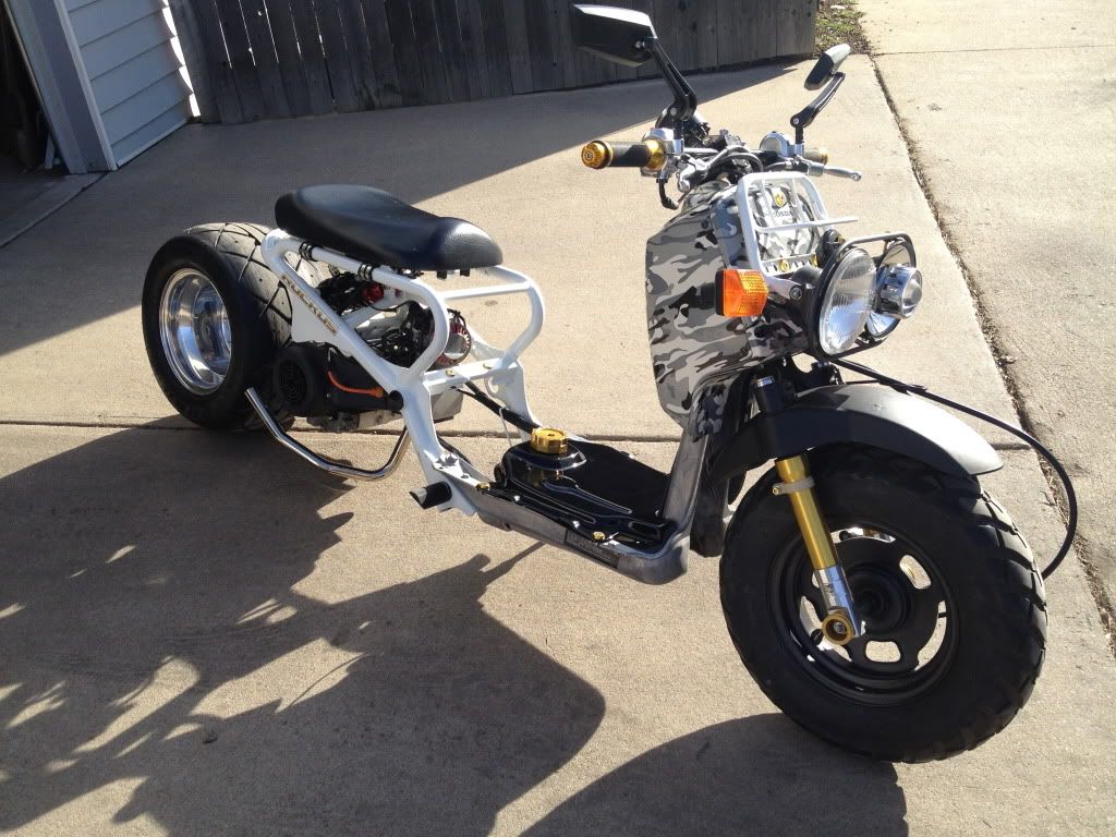

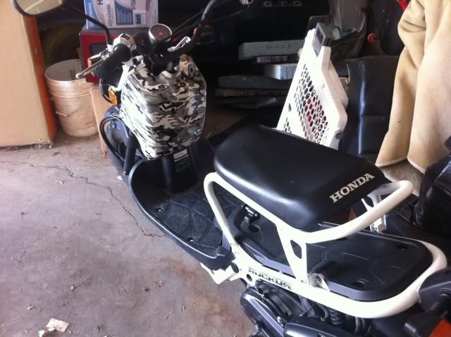

Here is how it started-
2007 Ruckus
\Image
New T-Motorsports GY6 150cc
New Rear frame and Seat frame for build

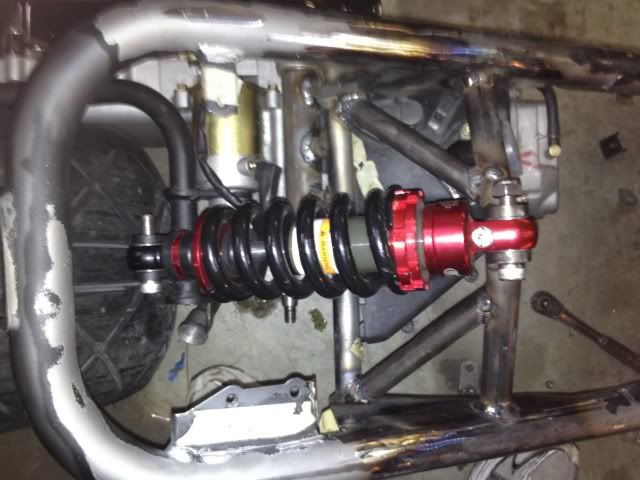

Mojo Mounts as well as Mojo Center Shock setup, Should be pretty sweet
custom rear 1 piece rear frame,

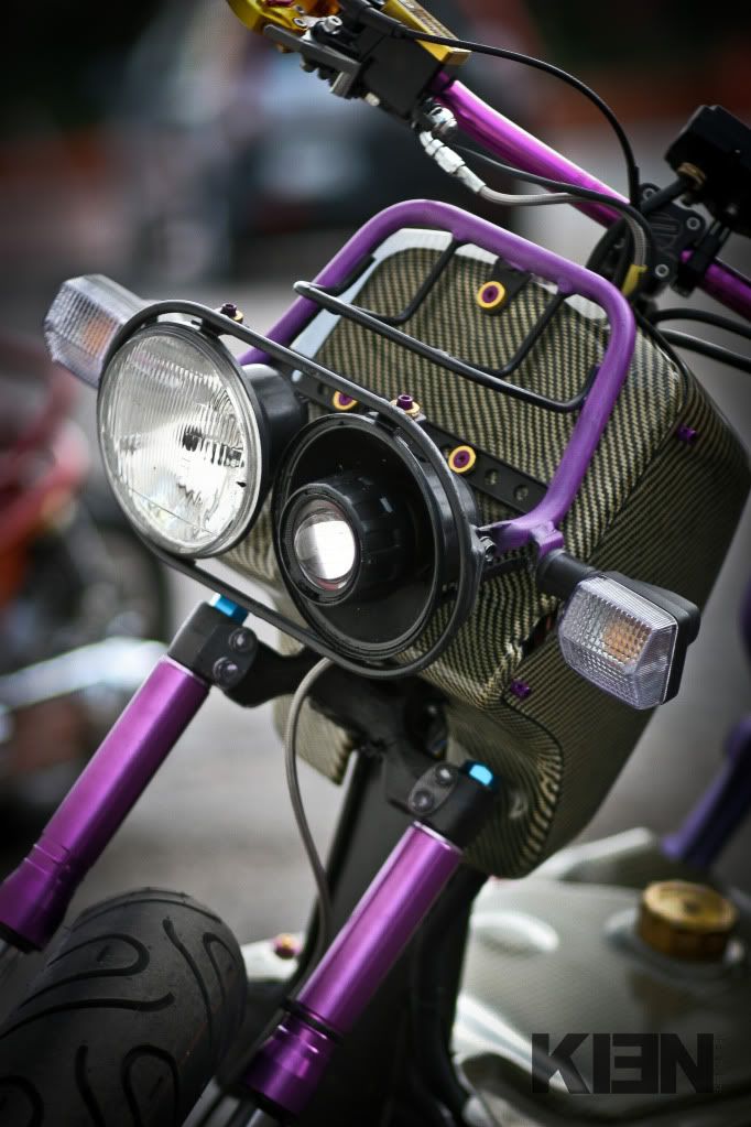

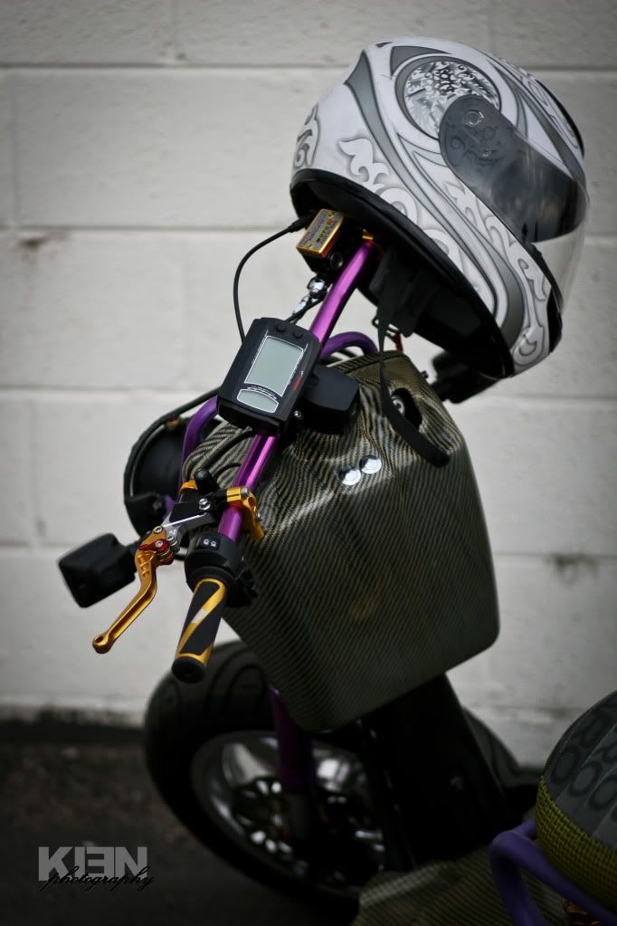

Installed one of my HID projectors today, Came out pretty sweet, but think i need to paint them black (reflector and housing around projector glass)
Here is a pic, and a short video showing the LO/HI operation of the HID.

Just curious what projector housing did you use? I have bought two off ebay and both were way to big to fit and look decent.
This one
http://www.ebay.com/itm/UNIVERSAL-HID-BI-XENON-MOTORCYCLE-PROJECTORLEN-KIT-C229-/170685975701?pt=Motors_Car_Truck_Parts_Accessories&vxp=mtr&hash=item27bdad4c95

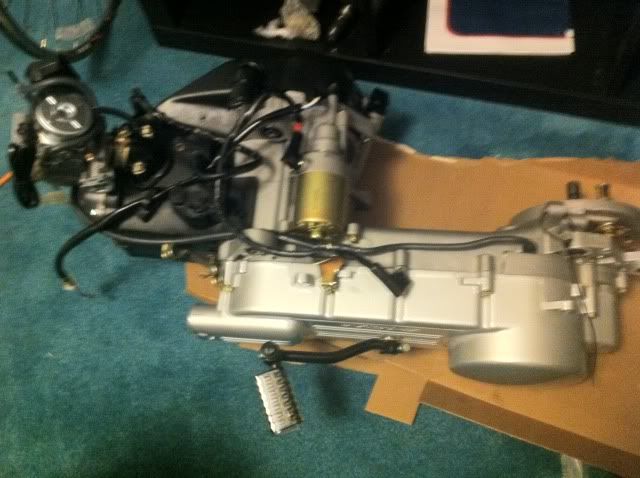

So i have spent the past two weeks seriously studying the differences between the ruckus wiring and what is needed to run a GY6.
because of this and my natural curiosity being an engineer and fabricator, this thought came to me...
The main difference between the GET motor and the GY6 as well as the root of the majority of problems when trying to utilize the OEM harness for the swap, is the charging system.
This thought overwhelmed me for the past two days until i decided to look further into it.
The GET motor has a pretty ingenious solution for starting and charging and it works really good. So why wouldnt it work on the GY6?
I have decided to find out so here is what i have done so far...
I took the stator/starter off of the get motor to compare it to the GY6 stator. I found that the flywheel of the GET is nearly identical in size to the GY6, with the GET being only 1mm larger in diameter to the GET and has the exact same Height as the GY6.
Second, I found the Shaft taper angle to be the same as well as the final diameters (the small end of the stators shaft hole) to be within 1/2mm .
The shaft key-way is identical on both.
Third- The stator on the GET is much larger in many aspects but very similar others. This is mainly due to the GET's built in starter.
Fourth- the shaft on the GET's flywheel that slided over the crankshaft, is much much larger that the GY6 (this may or may not be an issue)
I dont have my GY6 at home so later this next week im going to do some machining and such...
BASICALLY......
I am 98% sure that i have found a way to run the entire GET electrical system, including starting capabilities, on the GY6, eliminating the need for any change in wiring. I have always been a fan of keeping things as stock as possible, especially when it comes to honda. One of the things that led me to this curiosity was the fact that the GY6 was originally designed by honda, and being that Honda generally has kept a history of maintaining dimensions and using that same information and technology on multiple platforms, should yield that there are similarities which would allow for the stator and flywheel to work on the GY6.
Now there is alot that i am not telling you because i literally have over 80 hours of thought and research into this.....
If i am right though and this idea does work, it will definitely eliminate nearly all of the issues of running a GY6 using the OEM harness.

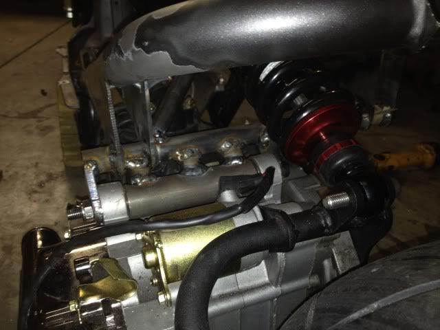

Got my Jiange Wayne super low shocks installed with the mnnthbx Drum brake adapter. Low on cash right now so this was a very viable alternative to getting the disc kit for the time being.
Installed PWJDM Stem and handlebar kit and installed the stock controls on it.

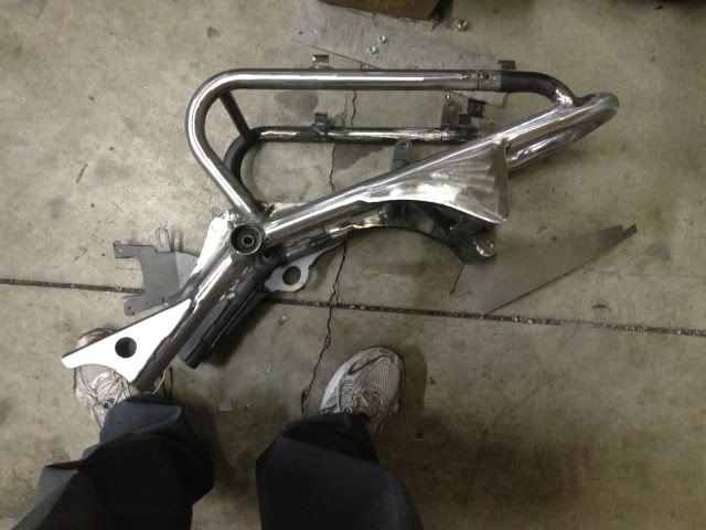

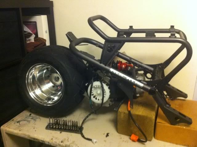

Relocated the Front blinkers to where the reflectors used to be.
Still working on one piece rear frame.
Also machining the GET stator to fit on the gy6 next week, will also need to modify the GY6 motor slightly but should work no problem.
more to come soon.

dang man you sound like my freind who is also in enginnering school lol. but good good stuff. love the projector light what all was needed exactly to get it to function correctly?
and are you going to paint the housing behind it black? i think that would be tits! :banger:
good build so far :banger:
To get the projector to work i just used a slim HID ballast hooked up as directed.
I think i will end up doing a carbon fiber shroud around the projector rather than just painting the housing.
