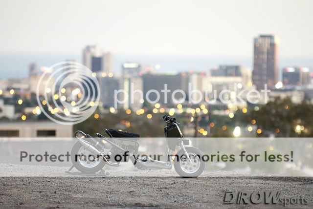

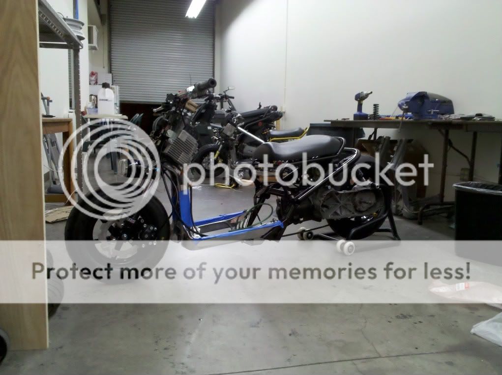

Here's some crappy camera phone pictures and Spec's of our Ruckus Grand Axis swap.
DROWsports 130cc Two Stroke Spec:
Engine:
Fully Polish Motor
DROWsports/Smartbomb Custom Ported Malossi 125cc Cylinder
52mm Full Circle Crank
Stage6 R/T Rear Facing Manifold
Stage6 70mm Air Filter
Stage6 MKII V-Stack
Stage6 PWK 28mm Carburetor
BGM Mixture Screw
Chameleon Factory Exhaust (old)
Stainless Steel WindJammer Exhaust
DROWsports Wire Harness
DROWSports Weld-on Race Motor Mount
DROWsports Zuma/GA Stater Block Off
DROWsports Auto-Lube Delete Plate
Transmission:
Malossi GA Variator w/WPC
Malossi Final Drive w/WPC
Malossi Overrange Rear Pulley
Malossi MHR 107mm Clutch Bell
Malossi MHR Overrange Belt
WPC Factory Gears
Ceramic Transmission Bearing
Dr. Pulley 107mm Clutch (update)
DROWsports Titanium Starter Delete Spacer
DROWsports Vented CVT Cover (polished)
Stance:
RRGS Silver Low Down Forks (update)
Ceramic Front Wheel Bearings
DROWsports Titanium Wheel Spacer
DROWsports Rear Shock Mount
DROWsports Titanium Shock Spacer
RRGS 12mm Axle
RRGS P32 Caliper Bracket
Brembo P32 Caliper
Brembo Master Cylinder
BRAKING 190mm Rotor
Goodridge/DROWsports Black Series Brake Lines
Fox Racing Vanilla Shox
TT92 Front and Rear Tires
KillerScooter Hub
Daytona 8 Hole Wheels
NCY Aluminum Triple Tree
Others:
DROWsports Headlight Bracket
DROWsports R6 Taillight Kit
DROWsports Footpegs
DROWsports Super DOT LED Turn Signals (update)
CRG LS 3" Mirror (update)
Black Market Stem
Carbon Fiber Handlebar
DROWsports Vendor's Corner

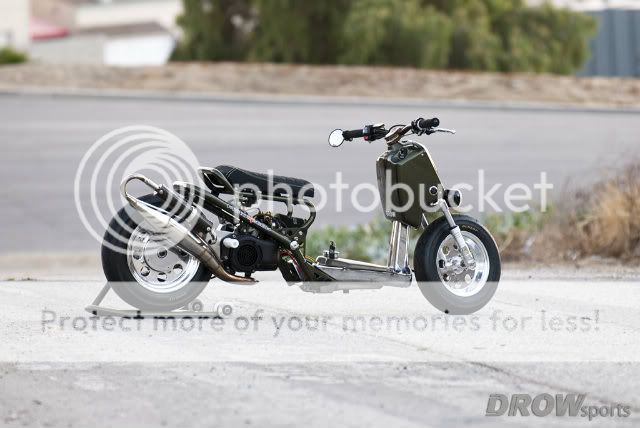

Thanks Guys, i should get back my polish motor next week and i'll take some detail shot of the bike with the new motor once it build.

Image :D

WOW. Is that PC? Looks unreal. Great Job.

Woah, top notch!
