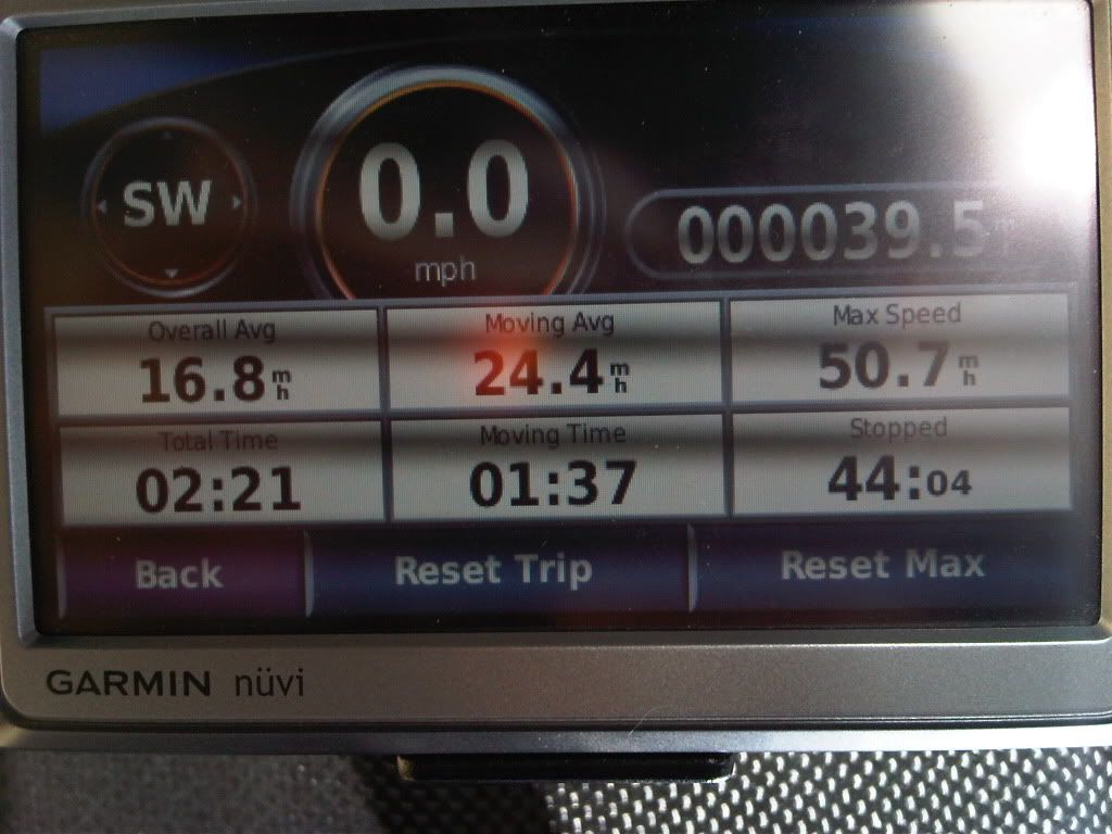

PostPosted: Sun Mar 07, 2010 1:59 pm
ENGINE
Motor mods: JC RACING 58.1 cc Stage 3
Lightened Flyhweel: yes
HO Cam: yes
PC/JC20 Carb (yes/no): Yes
Brand of (carb keihin / sheng wey): Keihen
main jet: 90
slow jet: 38
needle setting: 2nd from top
Which filter on carb: K&N Type
Exhaust: Two Bros Carbon FIber
Transmission
Variator: Polini
Roller weights and brand: polini 5.6 (all)
Clutch springs (blue or pink): Stock
Gear Kit: MXP Hi Speed
Other
cdi: KITACO
hitting rev limit (yes / no): no
Wheel
Rear Wheel size: Stock
Rear Tire size: Stock
PSI: 25lbs
Tire Brand: kenda (stock)
Environment Factor
Elevation: Las Vegas 2000 ft on the strip
Temperature at time of test: 65
Weight: 205lb
Top Speed Flats (no wind): 50.7 mph GARMIN GPS
Top Speed downhill (no wind): 50.7 MPH (sorry no hills really)
NOTE: Weather will improve performance. Also I just broke it in and Havent really "Pushed" it. im confident I can get 53-55 mph. Also I get to 45mph fairly quickly. I'll keep ya posted with pics of GPS when I achieve a worthy speed.

Posts: 51
 Post subject: Re: Big Bore Setups
PostPosted: Wed Jun 30, 2010 12:36 pm
Well I told ya I would update. Its runnin well and problem free. Super consistent as well. Its way hot here in Las VEgas so riding is tough. BUt I managed to hit 55mph a while back and forgot to post pics. To me thats good and hitting top speed or fairly close seemed to pretty easy and I didnt feel I had to risk the engine at expense of going fast. So overall im VERY happy with my setup and performance.
