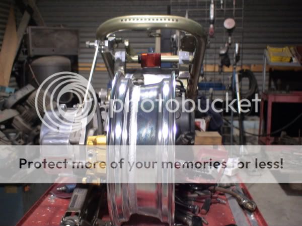

did any of you guys have issues with the wheels not being centered with the mounts that you have on?
pray for mojo mounts. http://www.flickr.com/photos/37689660@N05/

malone wrote:
bluesmokeracing wrote:
BATMAN (he raised the aluminum mount higher so the engine sits properly)
I've been wondering about that. Is BATMAN's GY6 mount the only one that raises the front engine for proper positioning? I didn't see any other GY6 mount seller mention it.
The picture below is a GY6 with a fatty rear wheel properly centered. Probably exclusive by ATR (All That Ruckus). AFAIK he's not ready to sell a GY6+fatty compatible mount yet.
I few of my friends has ATR mount, and they are using shocks thats are about 245mm or smaller for the engine to sit horizontal. From what I was told if you wanted the front engine to sit higher than use longer shock. Also complete ATR fatty swap kits are for sell in the for sale thread.

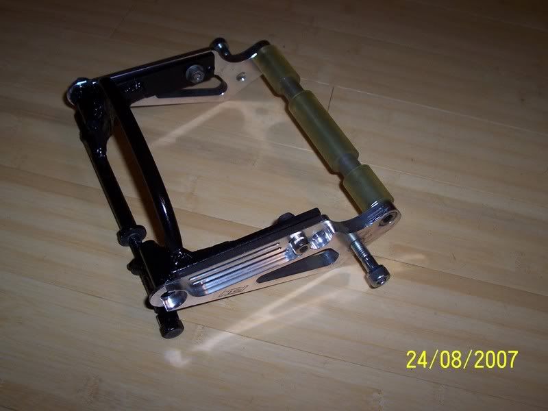

heres my engine mount, it originally the BATMAN kit, i modified it 2 inches shorter to shorten the wheelbase for easier cornering for racing and doin wheelies, it worked well so far w/ no problems, i already raced once at polini cup and it is very stable as it was before,i also drilled holes on top of the mount to cut some weight off, i had to cut the vibration bar in the middle to bolt down the chin bone, i just wanted to share it here for those lookin for the same thing i am, i will update my members ride soon w/ a pic of the bike 2 inches shorter.... :D

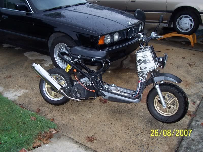

OK, its time to post pics of your engine mount setup, and get a list together of different mounting options for different engines(and how it has been done before!) Please note which engine it is, if there is a big variation of the engine(like long and short case GY6) and maybe what you think about the experience :D
If it is up here already, please don't repost the same thing twice, especially commercially available mounts, we need a reference thread!
Here is my first one, several generations later it eventually turned into the mounts that BATMAN sells(he raised the aluminum mount higher so the engine sits properly), this one is an adapter that bolts to a NCY stretch kit for a stock Ruckus, and bolts a long case GY6 engine into a little Ruckus with a stock Ruckus shock(using the NCY shock extension that comes in the extension kit)
installed, notice the front of the engine is lower than in in the BATMAN mounts, that was the big fix for the kit!

the mounts that kwik-ke is using are the one that i make. they work with or with out a fatty so if u want to run a fatty but don't have the $ to do it when u buy your mounts or u decide to run a fatty later u don't have to get new mounts and i like the way they LOOK!
