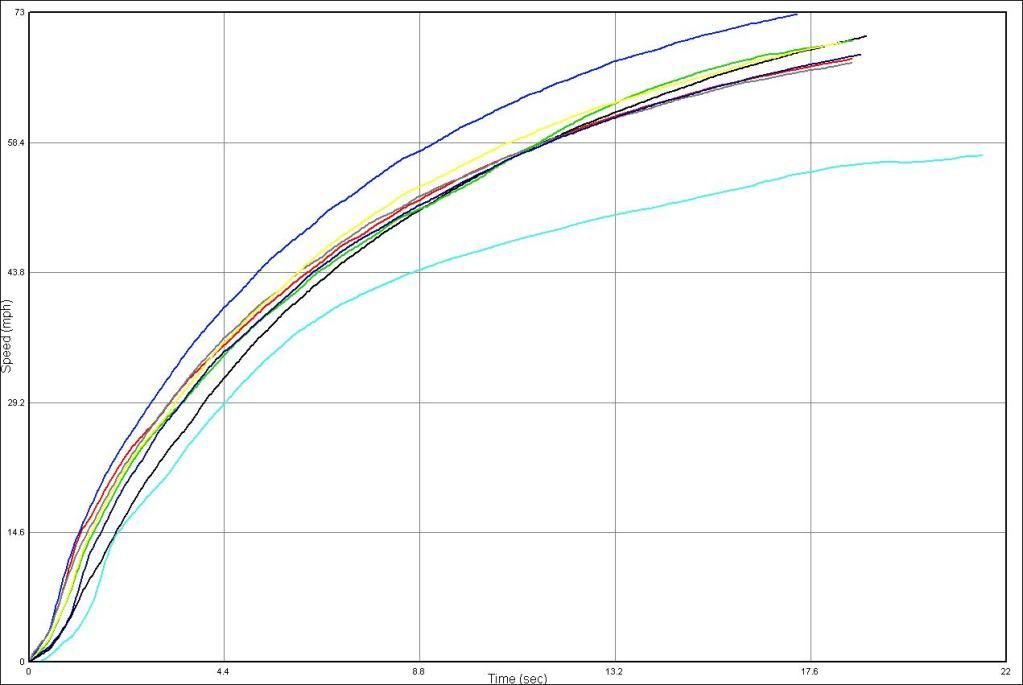

This is the first results:
Since the new variator still needs some miles before it will settle into a reliable rpm curve, the only thing I compared it to was the OEM stock BR configuration, just as it comes from the dealership show room.
The most interesting thing about the two setups is the HiT engages the clutch at about the same rpm as the OEM variator starts to upshift! :lol:
The WORST run on the new Costa was 68mph in the 1/4 mile.
The BEST run was 73mph in the 1/4.
Most runs were >70mph.
The best 0-60 time was 9.6 seconds.
the best 0-70 time was 14.8 seconds.
The best 1/4 mile time was 17.3 seconds.
this is very close to #2's best runs....
Remember this is with rejetted carb (42S, 102M) sucking air in though a stock air filter and pushing exhaust out through a stock muffler.
The Costa probably needs about 25 miles of use to smooth up and wear in where it will give consistent results.
I intend to put about 25 miles on the new setup and try it again tomorrow.

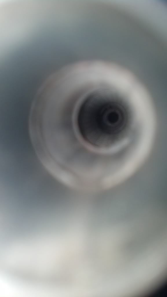

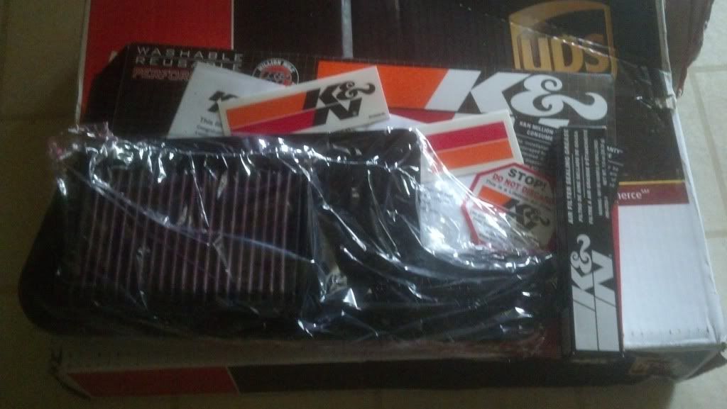

The K&N arrived today....
Which allowed me to do this! :wasted:
I did ask Bob first! :)
This will give the Costa variator/ HiT clitch combination every possible advantage.
This will probably be the final configuration of this scoot for the summer.

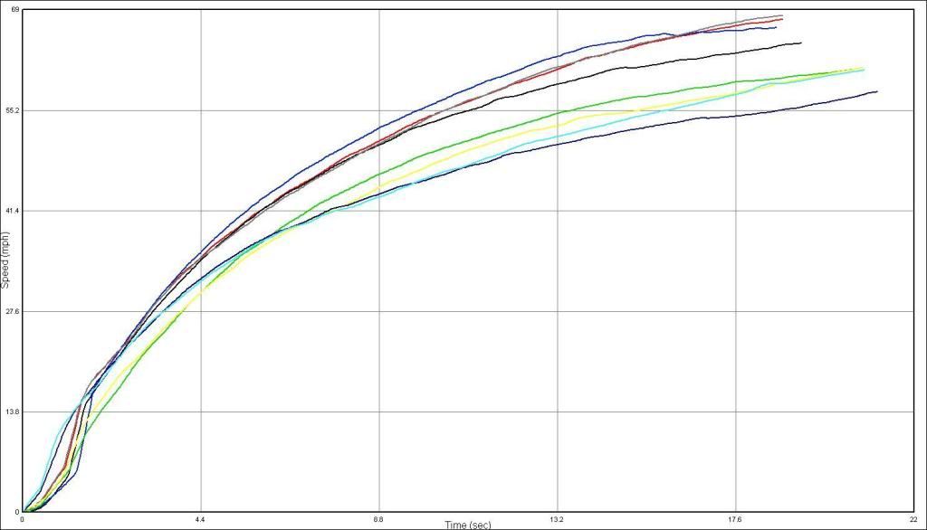

While waiting for the K&N to arrive, I tested some odd combinations and I compared the J.Costa to one of my favorite slider/roller combinations.....
3 x19g sliders + 3 x 15g rollers.
I like to think of this combination as a Poor Man's J.Costa.
REVs
If you look at these graphs, you'll see why.....this combination of sliders and rollers most perfectly mimics the J.Costa's acceleration curve.
And it almost matches the Costa's rpm curve....same upshift point around 6500revs and similar rev curve.
SPEED
Even the older runs with the stock clutch shows the same curve, just 1 second later becuase of the HiT's fast engagement.
The big difference is the Costa will upshift one more time at about 73, dropping revs when it does.
Relative stats for the 4 configurations.
No, it's not a real Costa, but it sure "feels" like one, all the way out to it's topend around 73mph.

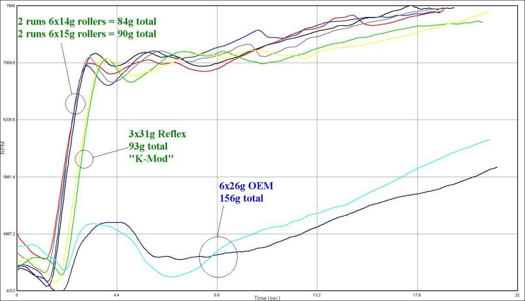

Also, for the extreme light weight enthusiasts, a collection of ~90gram ROLLERS tested with the HiT clutch.....
84 gram (6x14g R) 90 gram (6x15g R) 93g (3x31g R or K-Mod) all compared to the OEM 156gram (6x26g R)
90Gram REVs
All of the 90g class of weights (including the 93g K-Mod) rev well into the 7000 rpm range before upshifting....
this is ~500rpm higher than I'm seeing with the Costa/HiT combination.
Speed
The K-Mod w 3 rollers doesn't apply weight to the thrust plate as well when upshifting, meaning it's later in closing the pulley....
as you can see 6x15g rollers gave better performance than 3 x31g.
Where the K-Mod loses out is in the first few seconds....
6 weights in the variator take the slack out of the belt better and gets "the leap" in the first 2 seconds, where they gain about 6-8mph in < a half second.
In the Reflex's dual tracked variator, the results would have been different....I have no doubt it would greatly improve a Reflex time over stock.
But to maximize it's unique variator, a Reflex needs to scale both sets of weight by about the same percentage to get balanced performance.
Maybe 3x21g in the long tracks with 3x15g in the short tracks...that's where I'd start anyway!

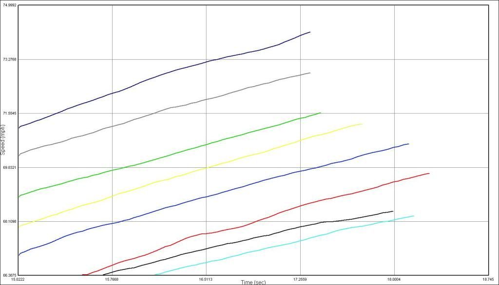

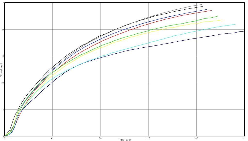

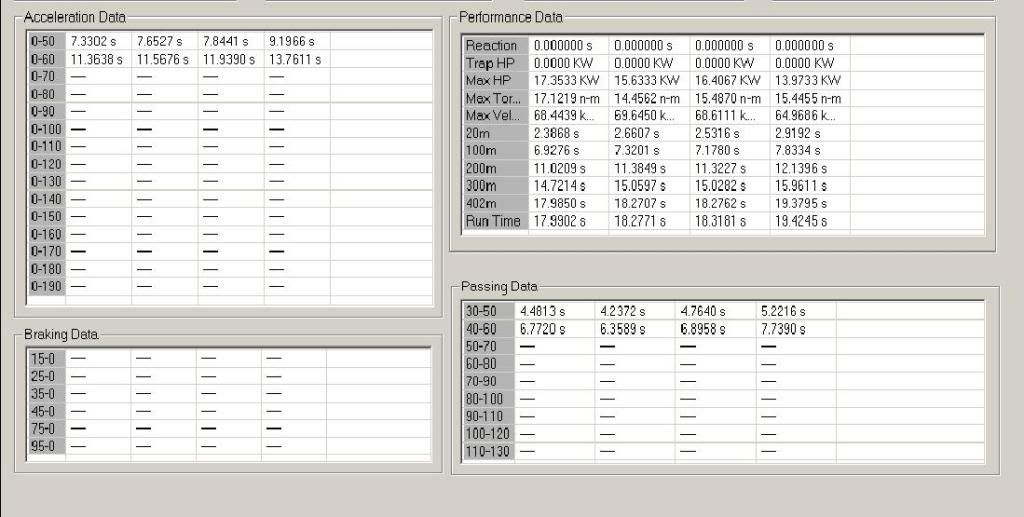

Here are the results of 8 consecutive runs with the full combination of mods......
HiT clutch
Costa variator
rejetted carb @ 42S, 102M
K&N filter

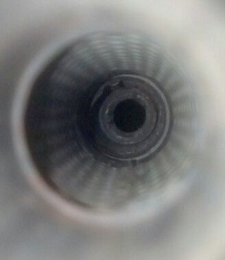

5/8" punched out muffler (eh, don't ask, but this procedure took all of 5 seconds!)
RPM
Several have been confused by the fact that I display so many runs when comparing mods.....
I always try to use at least 3 or 4 runs showing the current mod I'm working on.....
this ensures I'm looking at an accurate average representation of the data and not "cherry picking" results.
If it won't do it twice in a row, it's not worth considering...
so, always several similar runs to keep your self honest with your self? :ucrazy:
1/4 Finish Times
All 8 runs topped 68mph and 5 of the runs topped 70mph.
the K&N filter and open pipe helped the rejetted carb a lot.....
you can feel it pull harder at topend.
I'll need to readjust the carb's pilot circuit for the new air filter.....
it lowered the revs by about 100rpm immediately when I recranked the warm engine.
Also notice that as the HiT has accumulated miles, you can see a slight rpm drop at engagement.....
this just means its almost worn in....the pads slip less, grip faster and there is some rpm loss.
But, losing 300-400 rpms at 5500 rpm is hardly noticeable when compared to losing 300-400 revs at 2800 rpm.

Some stats for this setup....very nice!
Run Stats
I've been comparing before and after runs and have come to see that the HiT clutch affects more than just the first few seconds.....
by engaging late at higher revs and spinning up so much faster, it lowers the upshift rpms for every combination I've tested and usually with beneficial results.
It actually changes the shape of their rpm curve.....perhaps they are slipping in some way?
Or maybe it just that the engine is now running in the right powerband to do the heavy lifting of getting the mass into motion?
I suspect it's the second!
It's convinced me both by "feel" while riding and by crunching the Veypor data to the point that I've ordered a HiT for myself. :banger:

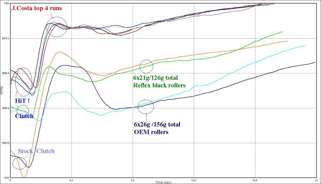

Another set of comparison Before/After graphs.......
at the top is the final configuration of the Costa variator w/HiT clutch.
But this is what I wanted to point out.......
At the bottom of the graph is two all roller setups compared using both the stock clutch and the HiT clutch......
using 6x21g (126gram total) and 6x26gram (156gram total) you can see the effect I mentioned earlier.
When using the HiT, the graph for a given roller setup has the same basic shape, but it gets scaled down and is flatter.....?
the CVT reaches upshift at lower revs and everything just seems to happen faster.
What this means is that you can extend the range of usable weights into the heavier end of the scale....when using the HiT clutch.

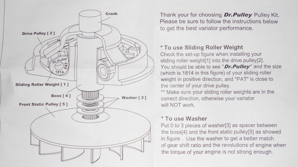

testing the DR Pulley HiT clutch convinced me to try the DR Pulley over-range variator.
This variator is designed specifically to work with DR Pulley sliding rollers and unlike the Costa, it comes with BOTH pulley faces. :banger:
Originally I was going to test it on #2 (and this IS where it's going!) but since Bob's CVT is still open and we have a ton of comparitive data on his scoot already,
I decided to install the new DR Pulley variator on his scoot first and make a few runs.
A couple of interesting features.....the Dr Pulley variator has very steep tracks.
It also has an adjustable boss with 3 spacers.....YOU get to pick your own gearing range!

First impressions of the DR Pulley variator.......
first, it's hefty.
I'm pretty sure it weighs more than the OEM variator....I will weigh both to confirm this.
second, it has functional cooling fins cast into the variator moving face housing....
these look to be very substantial and will definitely move more air.
the DRP variator has two matching pulley faces....
this is great, after dealing with several issues in the past caused by the Costa using the mis-matched OEM fixed face.
the next thing I noticed is there is a hole through the side of the boss....
I'm not sure of the purpose but when I picked it up to check it out, I noticed the next feature....
the boss is splined!
When I saw this my first reaction was...."Oh, shit!" :shock:
I thought "there's no way that will work on a BR", since our boss is NOT splined.
What followed was very educational........
after removing the J.Costa variator, I discovered the Dr Pulley boss slid up the shaft, I jiggled it a bit and the splines matched the crankshaft splines perfectly!
The DR Pulley boss locks solidly to the crankshaft.
A few quick measurements......
it is .001" thinner than the OEM boss and is .010" shorter then the OEM boss.
for all intents and purposes, the two are interchangeable between the DRP variator and the OEM variator.
When I first assembled it, I used one .010" spacer to get it close to the OEM length.
With a belt with about 6600 miles, this setting seemed loose with too much belt slap at idle, so I removed the spacer and the belt seemed about right.
one downside.......
the fixed pulley face has no holes for a variator tool.....
it only has cooling fins.
In my case, I used the impact driver to torque it to 70ft.lbs. but this could be a problem for those who use a torque wrench.
I doubt the cooling fins could withstand that much torque, so some alternative method of holding the variator while torqueing the nut may be required.
I installed 3x24g and 3x16g sliders and took a short ride to wear it in.
acceleration was smooth, the upshift was very strong and the gear range was tight.....
I can best describe it as going from low gear to high gear in about half the time of the OEM variator.
I'll need to try this again with lighter weights.
The 4 runs I graphed had not settled in enough to give a uniform repeatable curve, so I'll get some better data for it today.

No times for runs over the last few days but I wanted to post a few very odd graphs.
I opened a couple of the best runs from the HiT/Costa combination.....
then flipping back through previous runs of different combinations, I opened the fastest of each.
It's easy to do, just sort them by size...since the Veypor writes a fixed amount of data per second, the smallest file is the fastest run...usually.
What surprised me was an odd pattern emerged in about 80% of the runs....
The speeds were all fairly good runs, between 65 - 70 mph in the 1/4 mile.
But what struck me as odd was the two points of convergence in the rpm graphs....
at about 1-2 seconds into the run, all the different configurations are with 200rpm of each other.....
what's really strange is that at about 18 seconds, all the runs are within 200rpm of each other!
not all runs show this "convergence", but those above the line will be over 70mph and those below the line will be under 60mph.
This is some innate limitation of the design....
the variator gearing, the clutch gearing, your belt width, the final drive gearing ....
all in their upper operating range come together optimally @7250rpm at about 17 seconds.
thats in a GOOD run..you might say in the best of runs.
The great thing about stumbling onto this is it gives us a tangible goal.....
a fixed numerical rpm value to shoot for with our weight combinations.
so we know the upshift rpm range is ~5800 rpm for weights heavier than 126 grams
we know that it's ~ 6800 for the Costa and the 102g slider/roller combo
That give us a beginning range of 6000-6800 rpm @ about 3 seconds and a downrange target of 7250rpm at 17-18 seconds.
now we only need to find the perfect weight range and combnation that will draw the straightest line between those two points on the graph!
on the graph above notice the really ugly line??
that was my first DRP slider test from several years ago.....
I installed them the WRONG way and I hit the rev limiter on every run!
The results were still fast but if you look closely you can see that as the spark passed 8500, it suddently drops to 4250.....
that's how the rev limiter works....when reached it cuts off every other spark cycle.
if you approach it slowly, at cruise speed, you'll never even notice it.....you just feel the bike is out of power and that's all there is.
It doesn't really slow down....it just won't go any faster.
It's different if you hit it under hard acceleration......
then you will hear it sputter and fell it miss and sometimes even back fire from a missed spark cycle.
