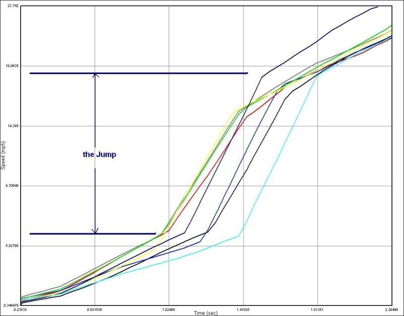

there's a neat surge of speed that occurs at about 1 second into the run, with most midrange roller weights......
it lasts about 1/2 second and is the greatest change in speed of the entire run.
In that critical half second, just as movement starts, the speed leaps from 5mph to 18-20mph.... in 1/2 second.
If you could hold that acceleration for another 1/2 second or even 1/4 second....at that same rate of change,
you would doing 35-40mph.... in 3 seconds!
If you were building a 1/4mile street BR, that 1/2 second is where you want to focus.....
at that rate of change, every .1 seconds is an additional 3mph in speed.
speed gained in those first few seconds is hard to make up!
I'll post some graph blow-ups showing this "surge" and where it aligns with rpm and HP.......
peak torgue occurs just as it starts and peak HP occurs just as it ends.....interesting!

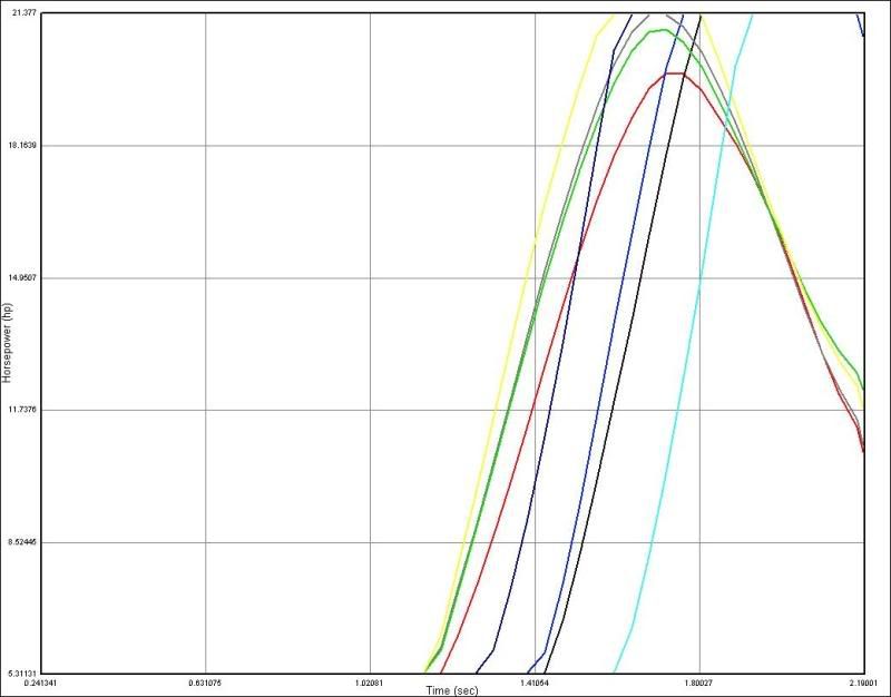

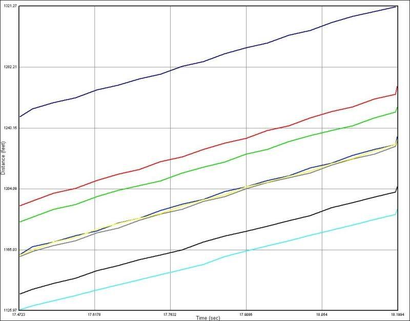

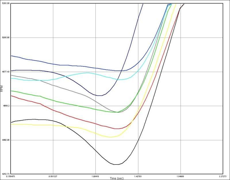

Ok here are some graphs showing "the Jump", as I've come to call it...... :D
these are each top runs with various weights of rollers.
Not all runs show the Jump.
Not all roller combos show the Jump! :|
The Jump is determined, or influenced, by several things......(this is just my opinion!) :D
1) carb tuning...your carb slide needs to open fast and punch hard! (slide orifice and jetting)
2) clutch springs.....this sets total revs at the point of launch ( flyweight spring tension, contra strength)
3) clutch/bell condition......(this is why blowing the dust out of the clutch bell gives you a nice kick in the ass! ... the Jump!)
4) actual low gear....remember you can gear TOO low? (boss length, belt width, shaved pulley faces, roller diameter)
5) tire size.....yep, it looks like it shows up more often with smaller diameter rear tires
I tried to cut these 4 charts to line up time wise....they're within a few tenths of a second
Revs bottom out and Torque peaks just as the Jump begins.........
Horsepower peaks right at the end of the Jump.
and at the end of 1/4 mile, the finish order is usually the same order you see at the end of Jump......
usually, whoever gets the Jump, gets the Race! (pun intended!) :D
all of these did 0-60 in less than 14 seconds.......
note 3 of these combos would literally be running neck and neck at the finish!
