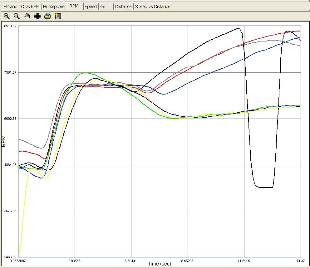

But the story doesn't end there.....the rpm readout tells another tale!
note what happens at about 5 seconds, just after the main upshift......
scaled rpm reading of all 6 runs (1 for each mod on 3 different roads)
The DR Pulley sliders continue to increase in rpms, for the same acceleration curve. The J.Costa maintains the same speeds, but the engine rpms fall off rapidly.....
about 2000rpm lower for the same curve.

this was a run I left out of the other graphs but I thought it was interesting....
What do you think happened here? :D

but for the record, the brown, blue and red lines (and the black one in the last graph) were from the DR sliders.......
the green, yellow and purple lines were the J. Costa......
the rpm chart at 5 seconds separates the two mods and clearly identifies them......

by the way, the "big dipper" in the black line on that last chart was when I hit the rev limiter at about 8500rpm!!!
This test definitely raises the known rev limit on the BR past 8000 revs.....
I saw 8400 rpms during several of the slider runs, a couple of times just before the limiter kicked in, as in the last graph.

one other thing I just noticed......
on the RPM graph of the 6 trial runs, notice how close the DR sliders' curves are from initial roll on until about 6-7 seconds, when they scatter.
notice the exact opposite of the Costa, very loose at first, but once the upshift is made all three tracks are almost identical?
I think this means the pulleys' ratio after upshift are very static in the Costa, where the sliders are "searching"....
the variable pulleys' ratios are drifting, as centrifugal force and contra spring tension battle it out for dominance.
A lighter contra spring here would tighten up the sliders' curve some.....

I scaled all the windows so each shows the first 14.4 seconds of data for the six 0-60 runs.....3 runs each with sliders compared to the Costa.
now look at the speed graph.....
if you throw out the high and the low result, then at 14.4 seconds, the 4 remaining tracks show 54-56mph.....
then look at the rpm graph.....
at that instant of reaching 54-56mph (14.4sec), the engine was turning between 8000-8400 rpm with the DR sliders......
with the J.Costa it was turning <6400 for the same speed.
remember in these test's I kept the throttle pegged until I hit 70......

For those who might wonder about the rev limiter setting for the BR here's another interesting graph from the slider runs.........
(again Yellow and Green are the Costa)
I think these 1/4 mile runs make a strong case for 8500 rpm as max? :D
That's the big advantage of the Veypor over the TinyTach for this purpose....
the TT had a slow refresh rate so when you occasionally hit the limiter,
the tach readout would be several hundred rpm low.
On the graph, the length of each line show the 1/4mile time.......
keep in mind that two of the runs were auto start....the clock starts when the bike moves
four of the runs were timed starts (3,2,1,GO!) and you can see my reaction time in the first second or so
on these runs, you also see the revs below the clutch engagement, which is about 2800-3000 rpm with the heavier springs.
I should point out that every run with the sliders that hit the limiter had a great 0-60 time! :|
After a run, when I let off, the sliders do seem to upshift some more.
I'll try to get a few 1/4 mile runs with more moderate acceleration to show this.
