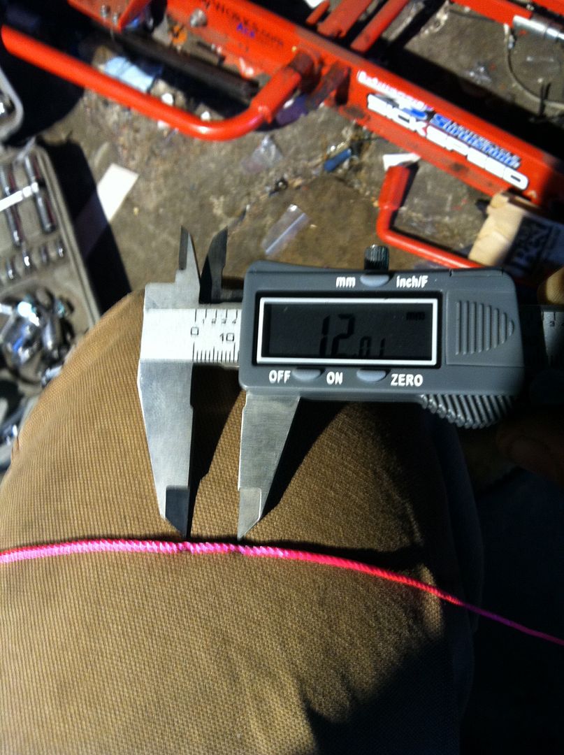

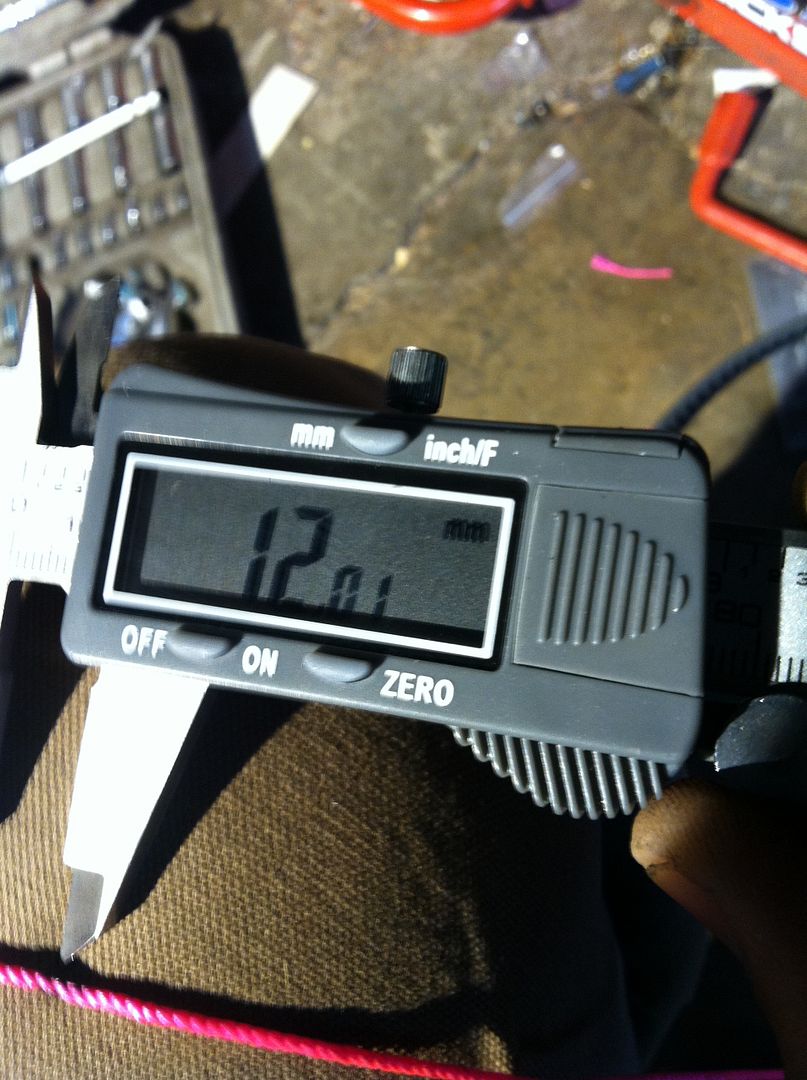

using my precise string to measure with I go the outer diameter of both belts, put a mark then measure the difference
I could be a couple mm off because of how thick my marks were but should be close enough
Im not sure where they get 2mm longer from but there is a 2 printed on the box in a couple areas mixed in with Japanese writing

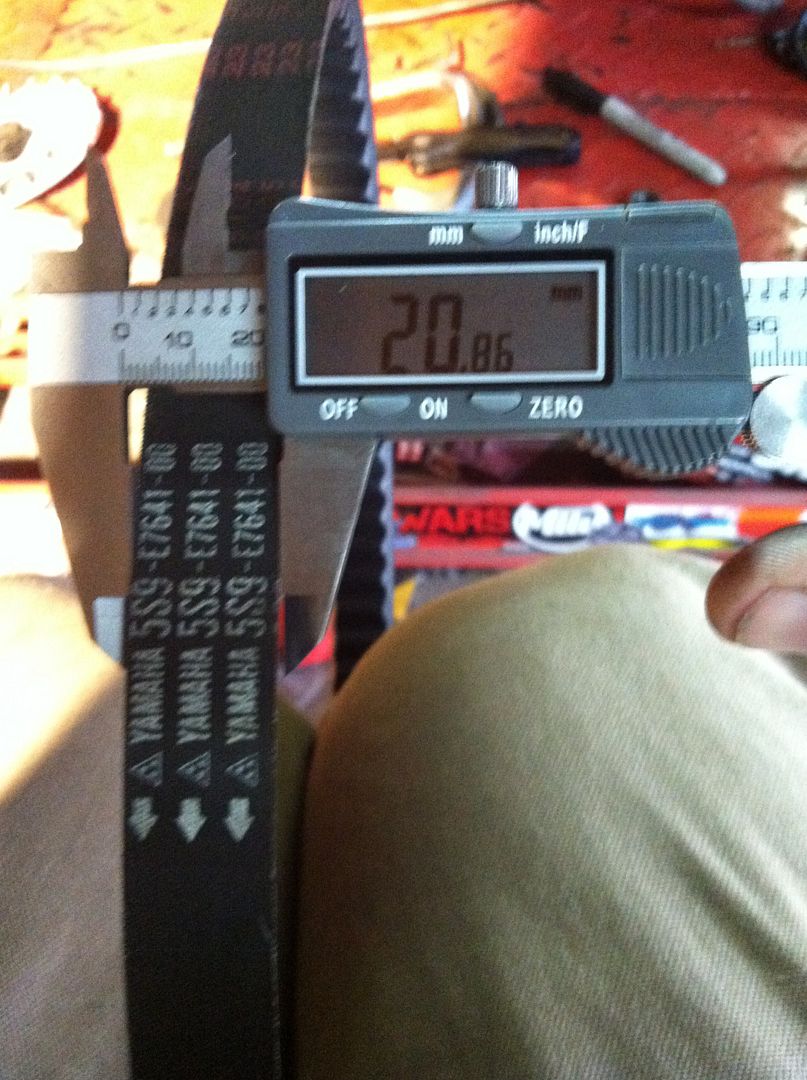

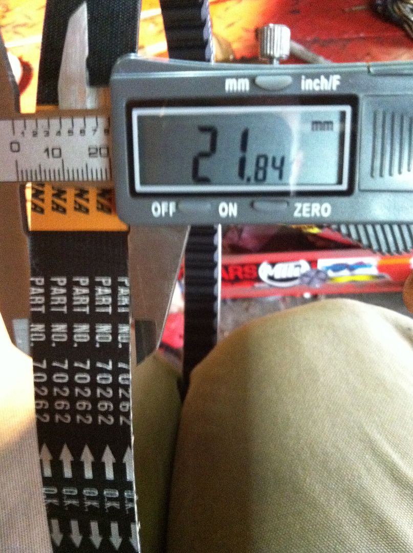

I read 12mm
And 1mm Wider then a Yamaha belt

Not to worry though I found a shim off a vino 125 which measures .92mm
If you calculate the size difference from the oem to the daytona belt thickness you will see the daytona was .98mm wider
so that .92mm shim basically puts me back to where I was with the oem belt when I add that shim to my existing shim

I too measured a brand new oem belt vs. the Daytona. My measurements weren't that different in width. Maybe 1mm. And I personally get better performance out of the oem belt for whatever reason. I've always heard the Daytona needs a breakin so I ran it for like 500 miles. I got about 2 mph faster when going back to the oem belt. Not really sure why.
