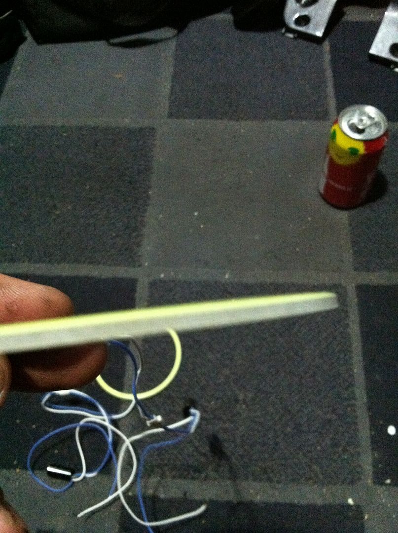

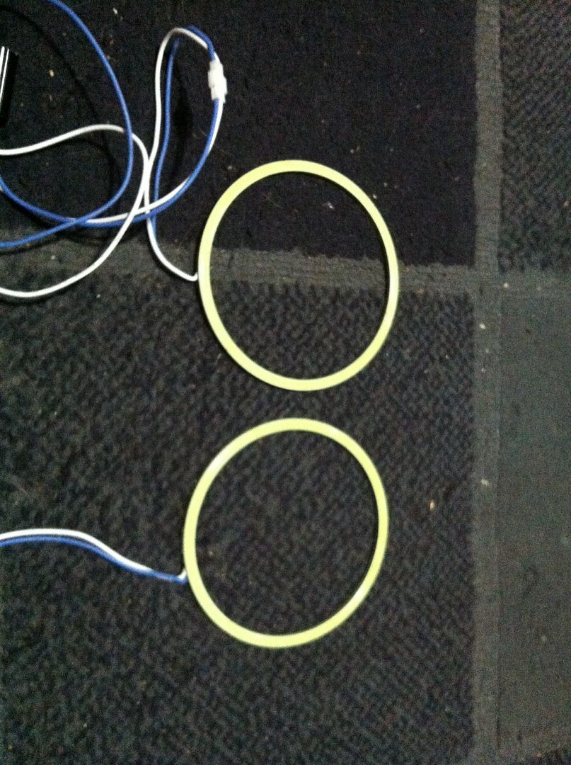

and made sure to test them before installing, super bright
Look what they are made out of
Some weird light green coating all over a thin stiff material
The entire ring lights up, not tiny leds
These look like they may be 6000K color
really nice crisp white
Also if you get the next sizes down you could have a cool colored effect if you use different colored rings

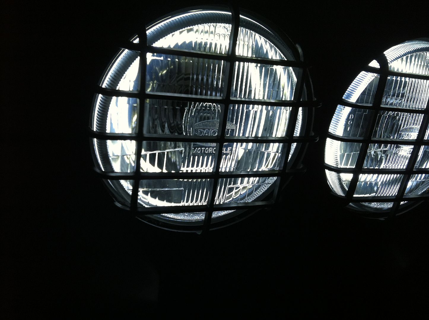

I installed the lights so when my key comes on they activate
and since I have a off switch for my hid's I plan to use these as day time lights
They are super bright at night, I could actually drive with them on only if needed
Just the led lights
very hard to get a good picture the camera freaks out

totally dark garage
