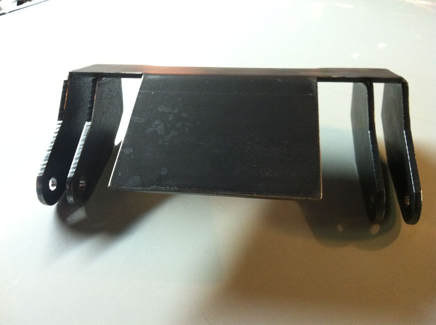

Hey im working right now on zuma 125 stretches
from the 2 I can find for sale online they range from $500-$600
Im hoping to have them under $300 shipped
Right now im test fitting the rear shock mounts as they are the hardest to make
the stretch will be easier
Im also trying to incorporate the license plate mount into the rear shock mount, so far ive not seen that done
Because you are stuck trying to figure out where to mount your plate after doing a stretch
and this way you can use the stock license plate light too
This can be cut off too if you dont want it
Nothing is for sale yet, but when the prototype is done and everything works fine I would like to do a preorder at a lower price with a set number of stretches needed to be ordered
I will update this thread with pics as I go along
here are some of the rear mount fresh off the plasma cutter
Everything will be professionally welded at a shop
Going to test fit this one tomorrow get holes drilled
will probably cut out the license plate mount to make it lighter too
The license plate will mount at the bottom of what you see, using the stock metal bracket on the bikes fender
This is what im trying to accomplish with the plate mount
This is a stretch im using right now on my bike
I made this plate mount myself, set at the sharpest angle I could to keep the plate as flat as possible keeping it as legal as I can

rear shock mounts all figured out, mounted with plate
only a little cutting under the tail light plastic housing to make it fit
my plate sits much higher then my home made plate mount, no chance now of it hitting my rear fender
Now I may be able to soften my rear shocks a little since before I had it set to the stiffest not to hit the fender using the stretch I had bought

Changed up the rear mount a little
added more supports behind the rear shock mount
and did a lighten cutout behind the plate mount
Im will still continue to test the original mount I made, if it holds up this stronger version will definitely hold too
Also worked on the adjustable rods
There will be 2 on the stretch, and you can adjust with the knurled grip pattern
Could of spent more time making the ends look nice
but more time it takes for things like that more it ends up raising the price
so im trying to keep it simple, yet practical
