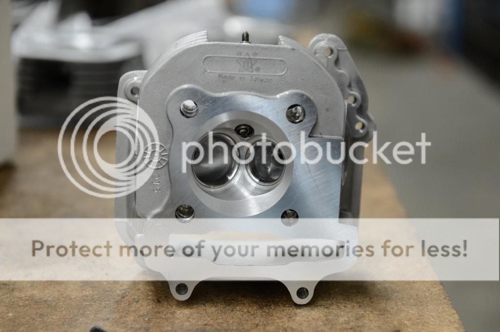

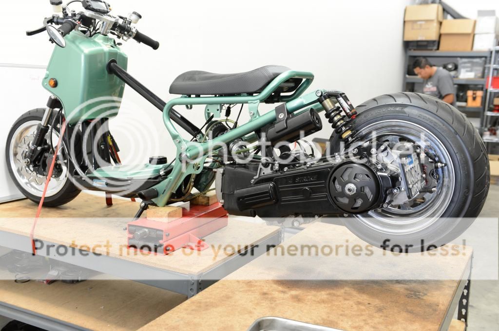

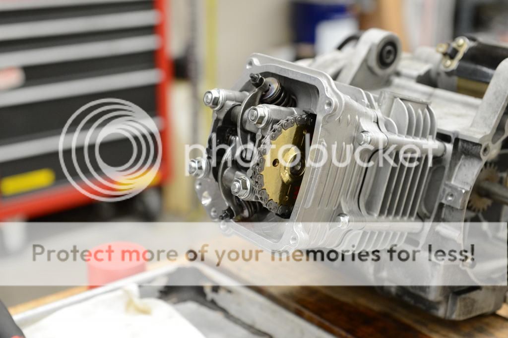

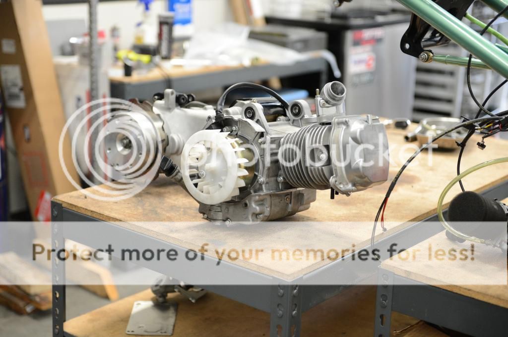

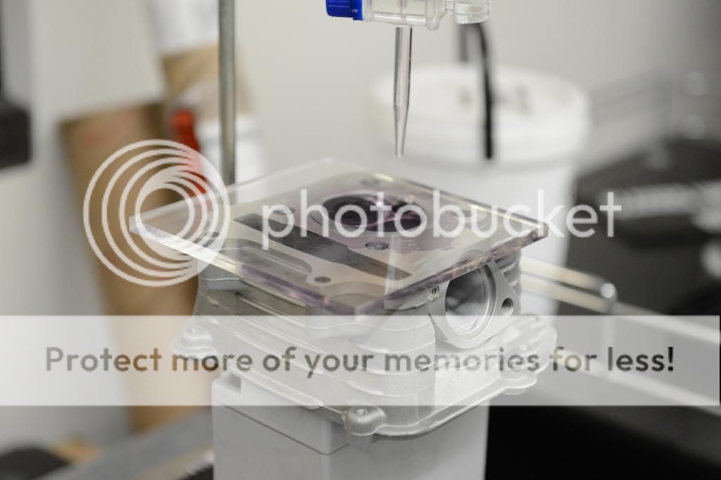

We'd like to share some of our Taida GY6 big bored engine builds with the TR community. We'll be sharing parts list, engine specs and photos. Please feel free to ask us any questions
Forever Green Taida GY6 170cc Big Bored Kit
Parts list:
Taida GY6 150 Big Bore Cylinder Kit - 61mm (54mm spacing) - Forged Piston
Taida GY6 150 Cylinder Head - Large PORT 28mm/23mm (54mm A Case)
GY6 Big Port Cylinder Head Porting
Taida GY6 150 Camshaft T100
Taida GY6 150 Valve Cover + Gasket
Stage6 R/T PWK 28mm MKII Racing Carburetor
Dr. Pulley HiT Clutch - GY6 150cc
KOSO CNC Racing Clutch Bell - GY6 150 / Kymco (125mm)
GY6 150 Performance Torque Spring - 1500 RPM
Dr. Pulley Variator Kit - GY6 150cc
Dr. Pulley 13g sliders
Stock gears
Specs:
MJ: 115 SJ:32, Needle JJF #2 MS:3out
Head, Milled .015", Custom Porting, Used thin base gasket.
CR: 11.1:1
Top Speed: 72mph
0-60: 11.2 sec
