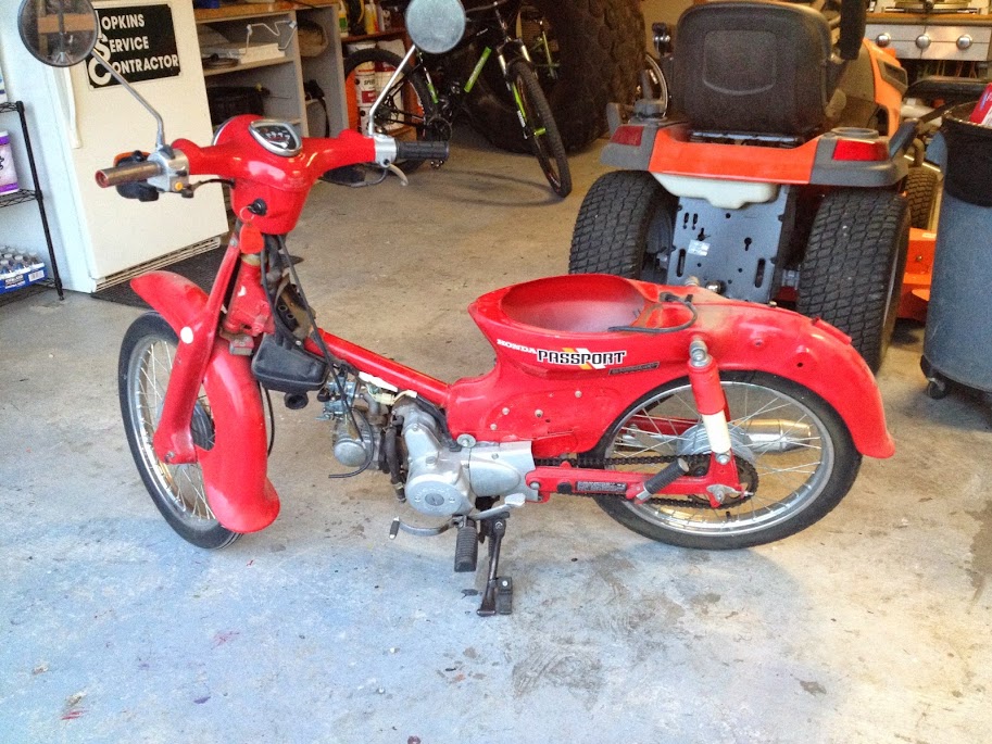

Ok, this is really a tease. I know how everyone wants to see Passport porn, but the only pic for now is this lame one. It's back there...
I finally picked up the C70 from my parents last night. I have been waiting a very long time to actually get this thing going. Now that we have moved and have property and room for toys I'll start this project - TODAY. First I'll start by simply getting the Honda engine in good running shape. From there I'll see what I want to do, give it to my son, bob it, fully resto, Lifan... I might shelf the Honda and throw on a Lifan for sh!ts and grins for a while or I may just leave it as is. I really like all the bobber style cubs, I was really set on doing that, but after seeing how well she's been maintained I may not...I might try to find a beater cub for that.
Going to start by replacing oil, plug, gas (after I Gumout the tank) and fuel line. I'll test the battery, if it's not good I'll disconnect the headlamp until I get a replacement.
I'll post some proper porn later today, she's in really good shape.

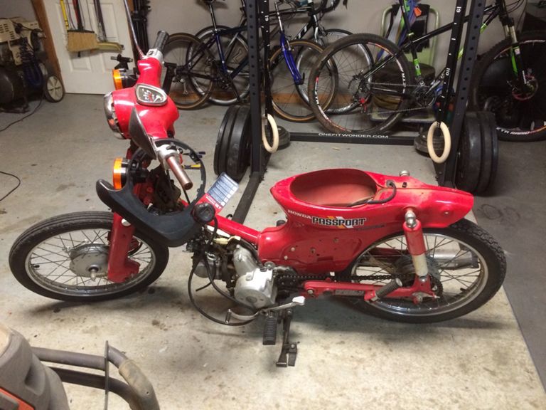

I did start the bobbing...
Before
After

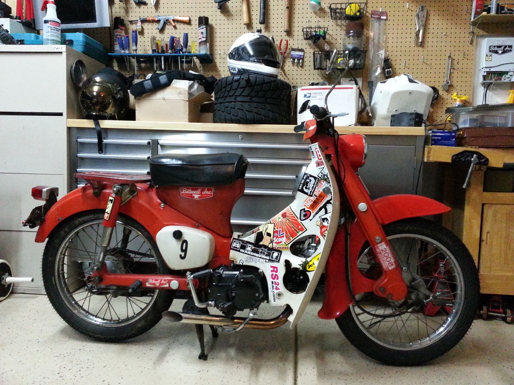

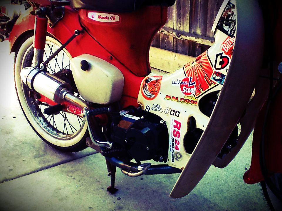

there are alot of exhaust options
many of the pit bike exhausts will fit the engine
of course if you get the type that go up high I think it clears everything and you will have to bolt the clamp to the shock mount, may need to make a bracket
if you get a low running exhaust, which ive also seen nice ones that are quiet make sure your kickstart doesnt hit it
the kickstart is offset to bend around the stock pipe but never know exactly how the aftermarkets route
and usually brake lever needs to be heated up and bent to clear the pipe, but thats easy to do with a torch
I think the low quiet one I saw was from webike maybe $60
also the big bore may push the exhaust forward a touch, so the stock pipe mount may need to be drilled a little to remount
this one is stupid loud
this wasnt too loud, but way louder then stock
I liked how it looked compared to the high up exhausts
this was pretty quiet with a 125 engine
