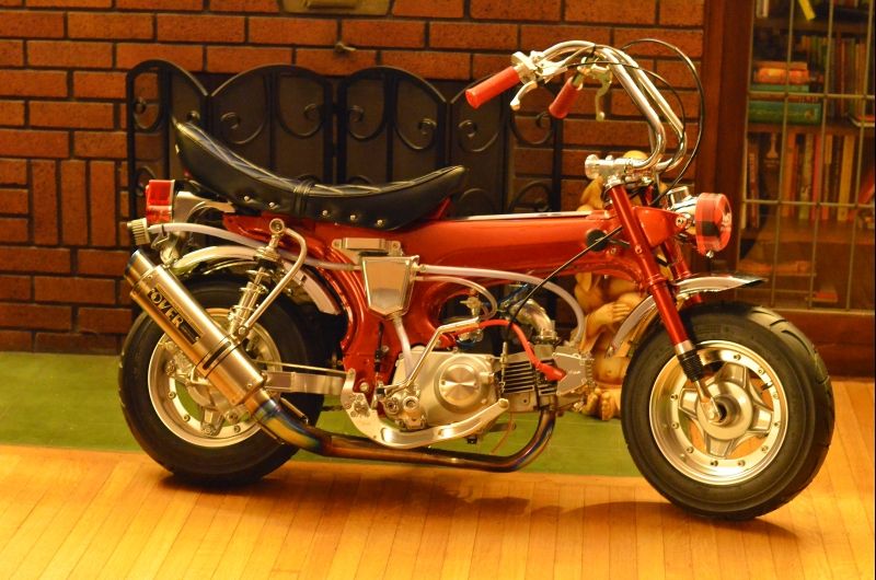

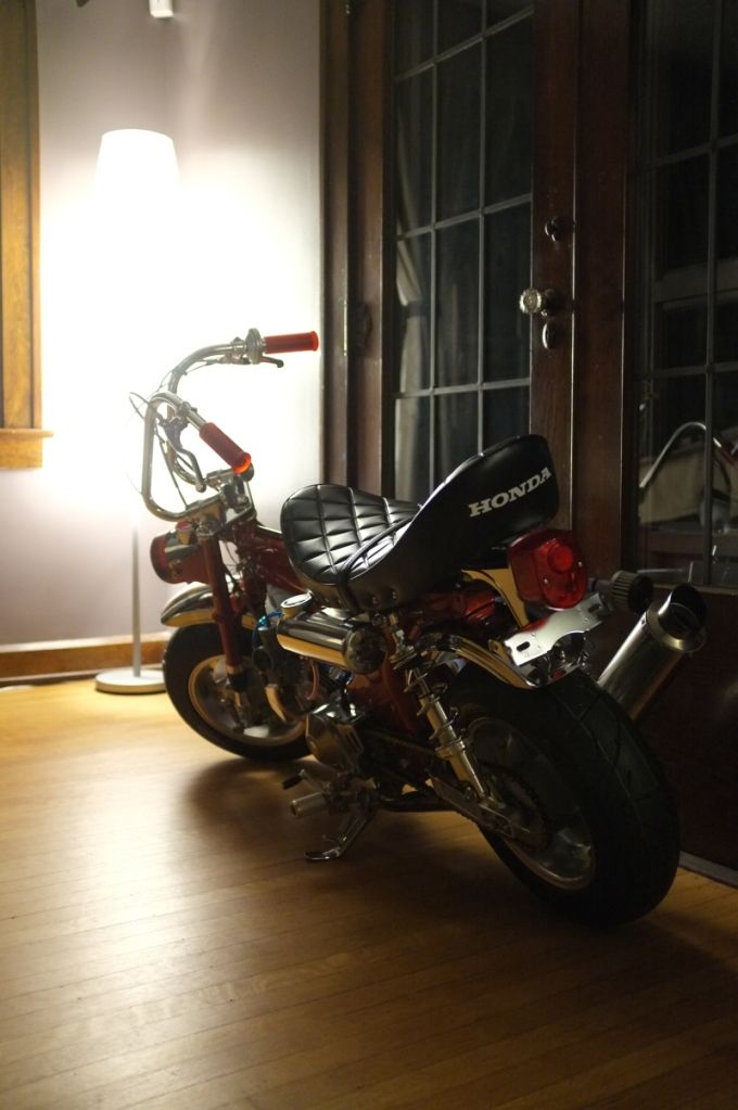

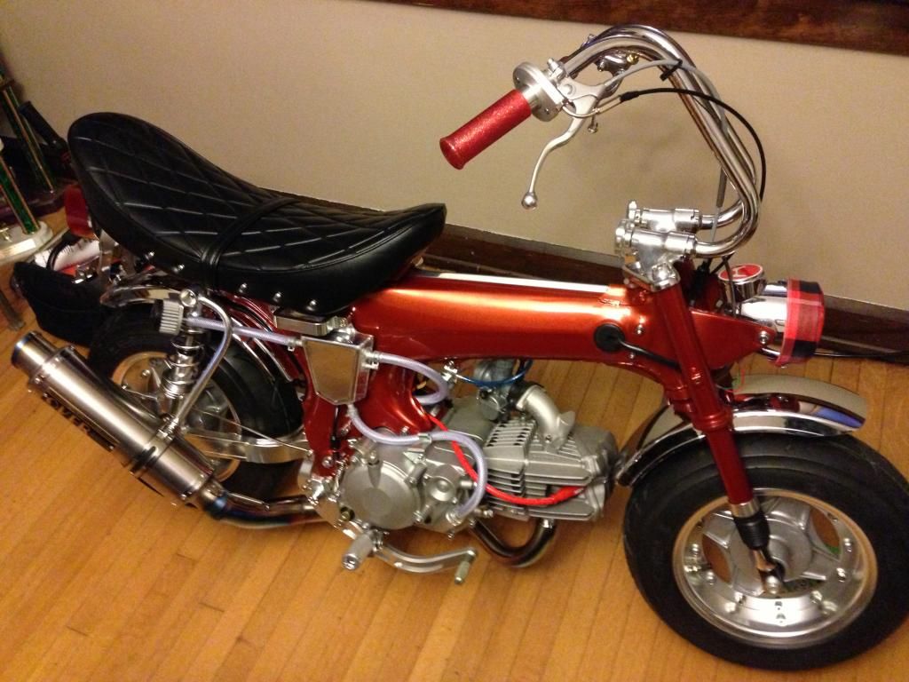

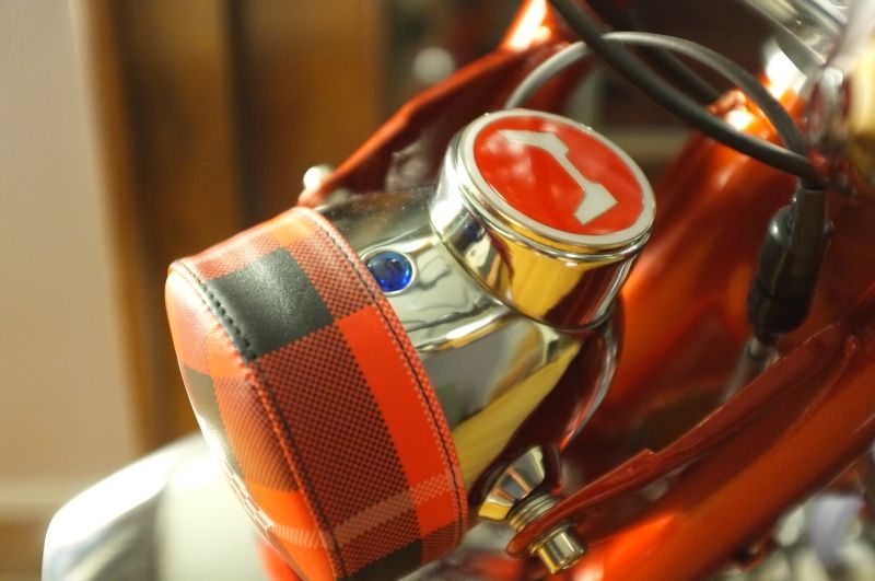

I've been busy the past couple of months building my 1970 Honda CT70 (DAX). I wanted to have a nice clean & low bike with compromising the vintage look. I have updated with more pics & a mod list. I hope you like it as much as I do.
UPDATED 12/2
now with the Daytona 150cc Anima 4-valve motor
here's the other side
incase you didn't know it's a...

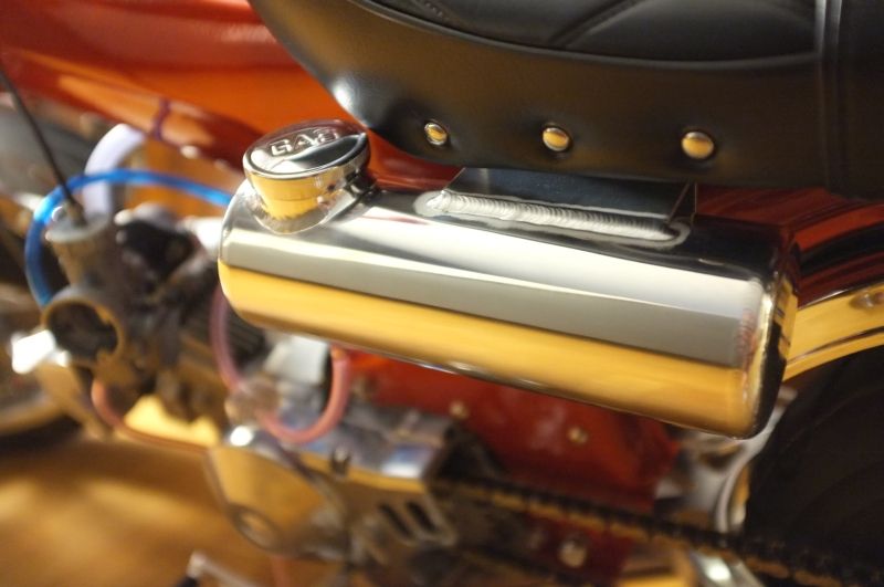

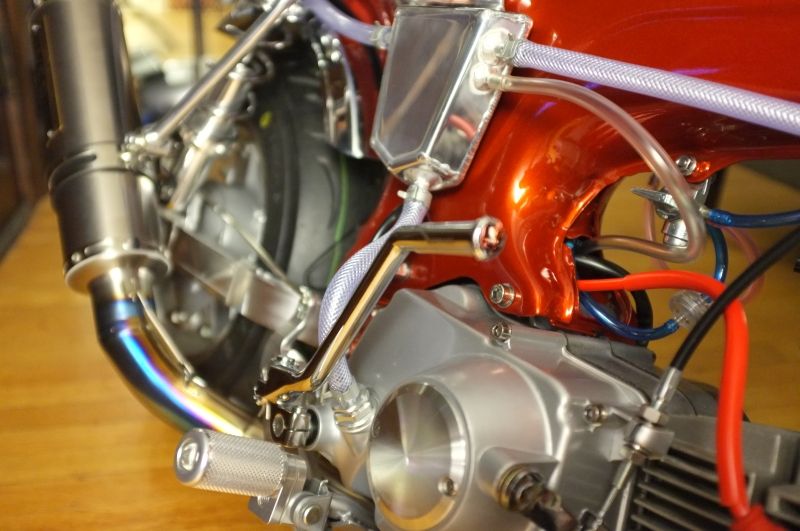

g-craft gas tank

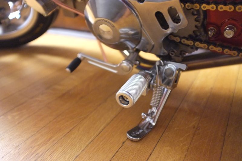

shift-up pegs, g-craft kickstand

chrome z50 headlight & emblem
headlight cover

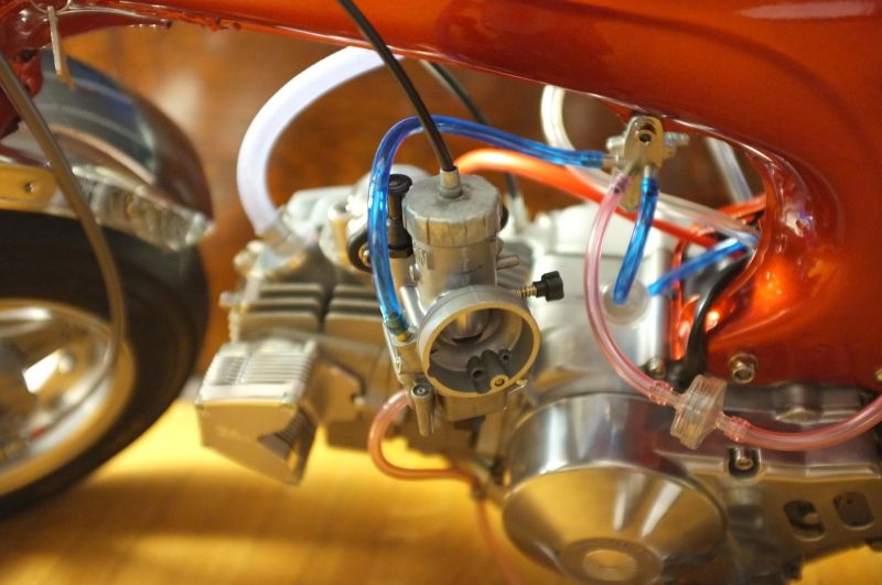

g-craft oil cooler
g-craft pedal, sp takegawa clutch cover
kitaco kickstart lever
g-craft catch can
titanium over racing exhaust

G-Craft Aluminum Auxiliary Gas Tank

that thing is really clean and good looking. My only dislike is the lines are all kinda long. And that filter by the exhaust kinda makes me worry about melting.
