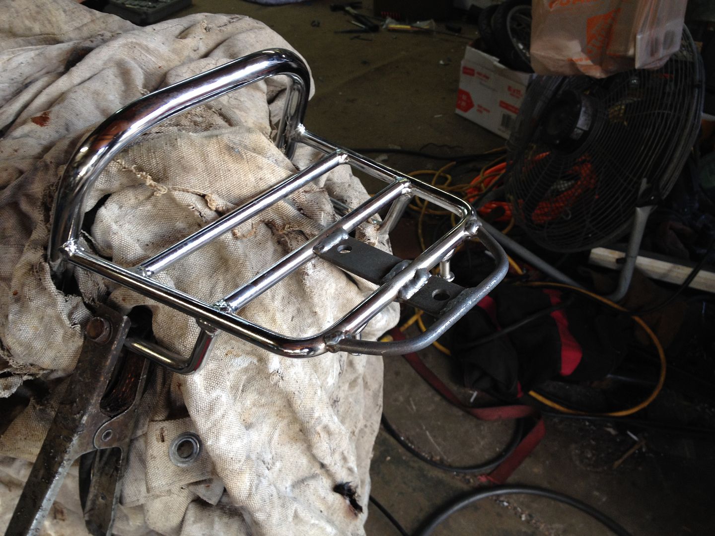

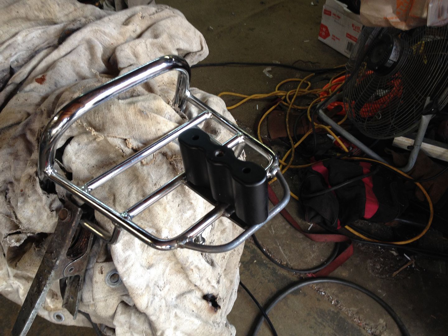

also wanted to get the bike ready for bigger rides, since the internal tank is only good for around 35 miles, and my spare tank good for 15 miles I wanted to be able to use a roto pax fuel tank I have laying around
sure I could carry it in a backpack, but 1 gallon of fuel does get heavy, and why not let the bike carry the weight since I did put on a rear rack a while ago. The only thing is the rack was very short, so pretty useless carrying anything
aesthetically the fuel tank looks a little too big, but since it sits flat I could also strap a bag over it and use it as a base for gear. so that is a nice feature
if they had made a 1/2 gallon tank then I think it would fit the size of the bike better
I just really cant find anything small enough to either mount good
or fill from a gas pump good
I did use to carry the small msr fuel bottles in a bag that ended up being really heavy, but its impossible to fill those at a gas station without spilling most of the fuel out
and I did try old military metal canteens but I was afraid they would leak and still hard to fill without spilling all over the bike
The roto pax has built in nozzle for spill free use and tucks away inside and large enough to fill from gas stations and not have fuel spill all over
as you can see because of how large the tank is, I was limited on figuring out how to mount it trying not to make anything too crazy and still keeping it simple, so I had to make my rack a touch longer so the tabs I welded will be supported, it was the best I can figure out how to do it
plus when not carrying the tank doesnt look to bad, once I decide how im going to finish the metal
I may just to primer over the new stuff, keep as much chrome as I can
or use spray paint chrome to hide the new stuff
even though I do have chrome powdercoat I could use, its a 2 step process and its such a big piece to do for such a little area I need to cover
