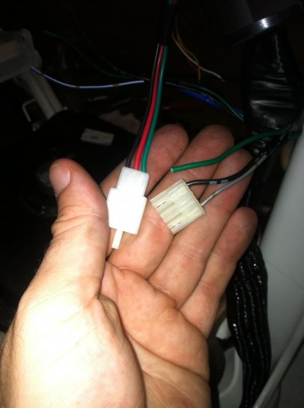

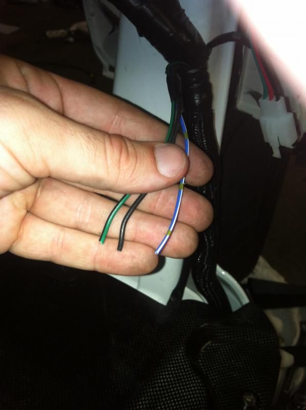

Well I got my harness and I'm afraid its missing a couple connections, not a big deal. I just need a little help on where these connections go cause I suck at wiring :meh: .
First is this one, for my flasher relay. The relay I have wont plug in so I'm just going to hardwire it in, and I need to know what wire goes to what, or do I need a different flasher relay?
Next is what I think is the fuel connection? I have the stage6 fuel meter and I read the install thread and my wires are different colors from that thread and different from your pictures for wiring on the first page.
Thanks!

Harness
Black - 12v power
Gray - switched power
Green/Black - ground
Harness - stage6
Black - red
Blue/white - yellow
Green/Black - black
Thanks!
ALOHA! :wavehello
