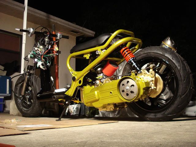

Here is my Ruckus

Posts: 634
Location: North Bay Ontario
 Post subject: Re: Rear Shock Reviews
PostPosted: Mon Mar 29, 2010 2:23 pm
themadsupra wrote:
Great review on the RDR..I just picked one up myself, but have not put it on the bike yet. It looks like its built nicely, its good to see that it rides nicely as well ! Ill give a review once I get some miles on mine.
yeah I like my shocks stiff and it delivers..very nice ride..had to grind the one side where it connects to the swingarm so it would fit..and it's hard to line up the bottom bolt for it to thread into the other side..other than that install was pretty easy..and it absolutely smokes my daytona for ride quality at my weight..I haven't taken it into the trails though and that's where it makes or breaks the shock..time will tell lol...
