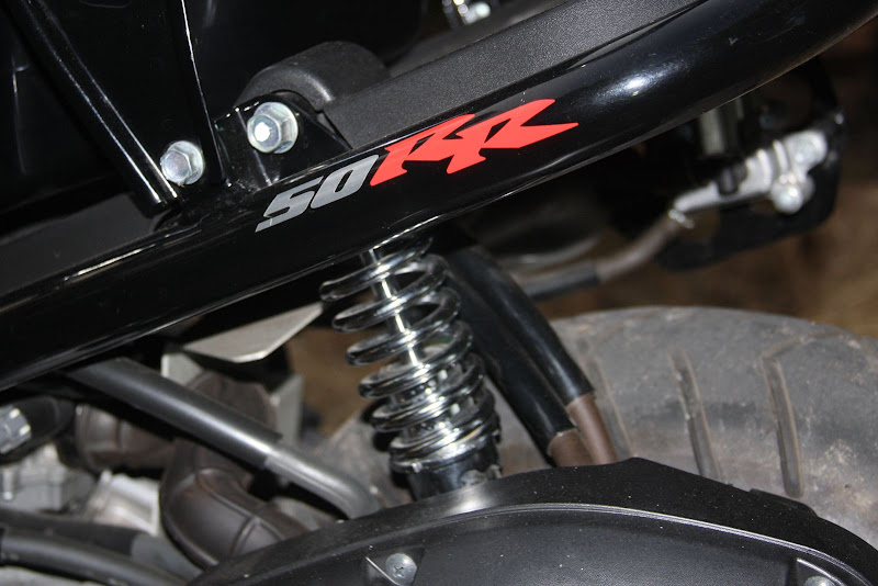

Product:Daytona 270mm Chrome Shock
Duration Product Used: about a week
Weight: 250lbs
Price Paid: came on bike
Purchased At: came on bike
Strengths: hmm, it looks nice and does have adjustable preload.
Weaknesses: Could be stiffer i have bottomed it out a lot. no real adjustments. would be nice to change this as it feels just like a cheap shock
Bottom Line: I would not buy this again. i am currently looking into something with more adjustments and something that is built better. but for the avg joe, it should work 99% of the time. I would like to see adj rebound, compression, something. I think i was expecting soo much more with all the hype, but maybe i am too fat :D
Value Rating: i would say a 3
Overall Rating: 5 (it does look nice and shinny :D)
