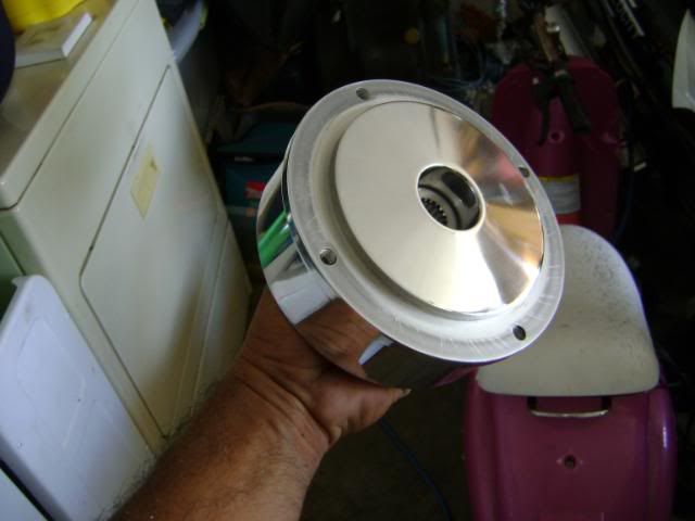

here's my beauty. came w/ silver anodize finish but i cant leave anything alone.
big up's to Yimmy and the ATR crew :banger: dropping some sick shit in 09. save some ideas for next yr.
Dam that looks good.
