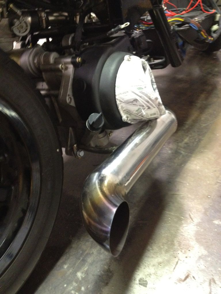

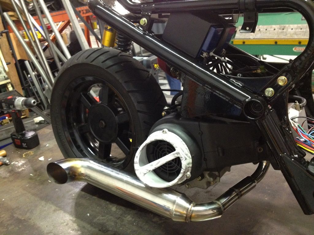

had a TR member contact me about sending us this muffler and building it like the one you may have seen in some other threads. its designed for an 8" fatty which is why it looks so wide on my skinny set-up

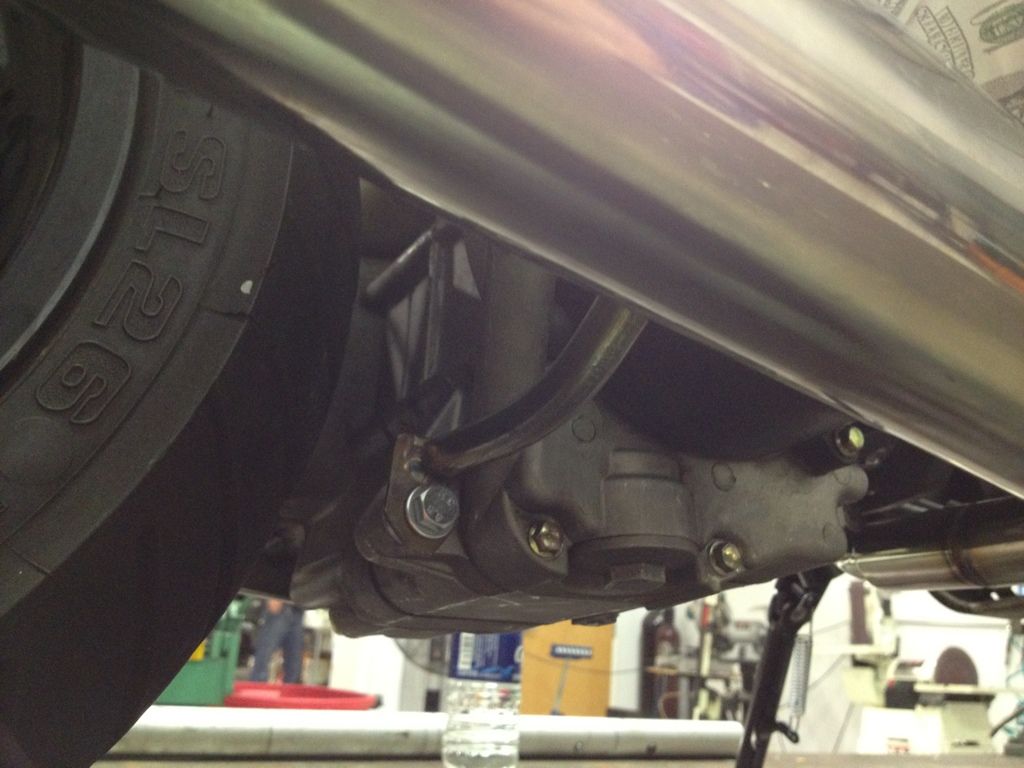

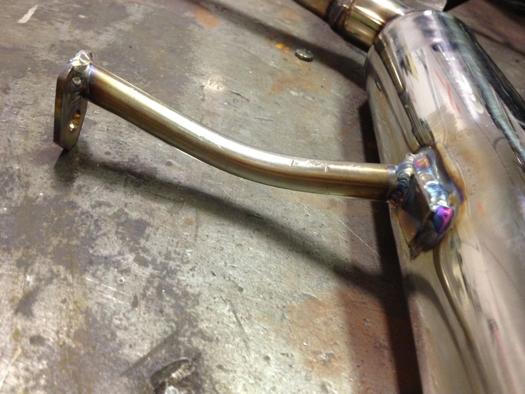

Got 4 exhausts cranked out, I'm really happy with how they look. The welds are clean, brackets are strong, and the whole system is super light. It took us a lot longer than expected to produce these things. I have enough material on the way to do 12 more systems. With that said, I have to raise the price to $149 shipped. This price will include shipping and packaging, paypal costs, a new exhaust gasket, and new hardware. If I've already spoken to you, I'll do $115 shipped no problem at all.

Made this exhaust for my scooter a few weeks ago and it sounds really good on a gy6. Im curious to see if anyone would be interested in running the same thing? I mig welded mine but the ones i'd be selling would be completely tig welded. It sounds really good and is very light for a muffled set-up. This is not a for sale thread by any means, I'd just like to gauge your interest, if any. I'd be able to sell them for $110 shipped if people were interested.

maybe... I'm not digging the B&S muffler though..

ya, the straight pipe would be dope without the muff..

For the price its not bad. I like the B&S welded in there!

I think the muffler is a good idea, not sure about the angle of the exhaust pipe though. I would cut it right after the dipstick.
OR right under the air scoop so the guys with fattys could run them.

I have no problem making them without the muffler and/or for fatty set-ups. Pretty much whatever you guys want to change can be done. I would be able to lower the price a bit if you didnt want the muffler as well.

I like the idea. The BS muffler is a good idea too because I can imagine the straight pipe would be way loud. Just begging for cops to stop you ya know. I like it. Looks solid, but I would stop it where others have said so fatty's can run the setup too!

Also, regarding the muffler getting loose and vibrating. You can see when looking at the briggs mufflers that they are pressed together. Each one I produce will be welded along that seem to keep them from coming apart and vibrating. These welds will also be fusion welds (meaning no filler will be used) to keep it looking clean and the weld low-profile.

You will need some way of mounting it other than the bolt studs as well. It will vibrate and break off either the header bolts or the flange.

oh yeah forgot to mention I'm adding a bracket that runs to a lower case bolt to hold it stable. thanks though
