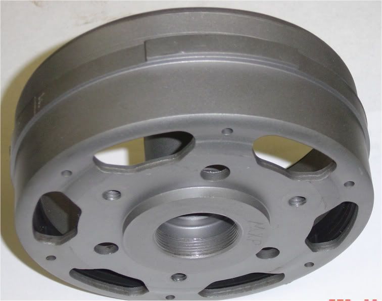

Here is a very brief process that is being done in case anyone is interested in knowing.
First, the flywheel is machined to my specs. I have done way too many flywheels other than just the Ruckus; I know how much can safely be removed to increase performance and not decrease reliability or worst yet, result in a flywheel failure due to trying to remove too much material.
Secondly, the flywheel is blasted with medium glass beads to accomplish 2 things, 1)To remove all rust and corrosion 2)To close the pores of the metal after machining to help prevent rust.
Thirdly, an Anti-rust preventative is applied to the flywheel and allowed to dry leaving an invisible film.
If for some reason you wanted your flywheel lightened and not have me do steps 2 and 3 just let me know as it will be cheaper. I do not like to let ugly/rusty things leave the shop but if you must to save a buck I will oblige you.
Here is a pic of the way most flywheels look when I receive them, if not worse.
And after the lightening 3 step process.

Installed the Lightened flywheel today. It idles fine, didn't miss a lick, and I did not readjust it. Total weight removed was about 4 ounces.
Keep in mind that I do not have a Veypor (wish I did) so I can only give you my best shot during my testing this afternoon.
From dead stop to 30 mph it gained Half a Second. I ran it 10 times after warming it up. It took 18 minutes to change the flywheel. Went back to the same conditions as before and after running it 10 times I came to the above conclusion.
Now for the real world situation testing we went terrorize the neighborhoods for about an hour. You can tell sitting still that it revs quicker. When exiting a turn that you had to back off the throttle for and get back on it again you notice it takes less time to spool up and take off.
All in all I think it was worth it and I have a few to lighten for some guys around here.
